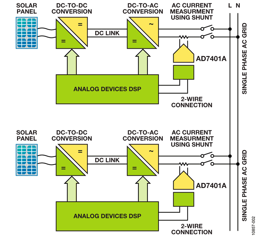

Solar photovoltaic (PV) inverter system applications
Solar photovoltaic inverters convert electrical energy from solar panels and efficiently deliver it to the utility grid. The power from the solar panel is basically a DC source, which is converted into AC and fed into the utility grid in a certain phase relationship with the grid frequency with extremely high efficiency (95% to 98%). The conversion can be single-stage or multi-stage, as shown in Figure 2. The first stage is usually a DC-DC conversion, where the low voltage and high current output of the solar panel is converted into high voltage and low current. The purpose of this is to boost the voltage to a level that is compatible with the grid's peak voltage. The second stage usually converts DC voltage and current to AC voltage and current, usually using an H-bridge circuit. (See the ADI article " Integrating solar photovoltaic power generation systems into smart grids with isolation technology ").
Figure 2. Solar photovoltaic inverter system
Previous solar PV inverters were simply modules that dumped electrical energy into the utility grid. Solar inverters for new designs focus on safety, grid integration and cost reduction. To this end, solar PV inverter designers are considering new technologies not used in existing solar inverter modules to improve performance and reduce costs as much as possible.
In this circuit, DSP controls the DC-DC converter and DC-AC converter. The utility grid is generally connected via relays. AC current measurement is implemented by the AD7401A, which measures the current output to the grid, typically 25A.

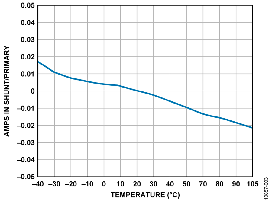

AD7401A Offset Performance
The offset of the AD7401A in the current measurement module is measured over the entire temperature range up to 125°C. The results are shown in Figure 3 and meet the specifications in the AD7401A data sheet. The maximum measured offset change with no current flowing in the shunt resistor is approximately ±20 mA over the entire temperature range (temperature range: −40°C to +125°C).
The voltages applied during the test are as follows:
  • VDD_ISO = 5 V
  • VDD_FPGA = 3.3 V
  • MCLKIN = 16 MHz (EVAL-CED1Z, using Altera FPGA, 256 decimation rate).
  • VIN = 6 V @ 62 mA (current sensing module input supply voltage).
Figure 3. AD7401A module offset

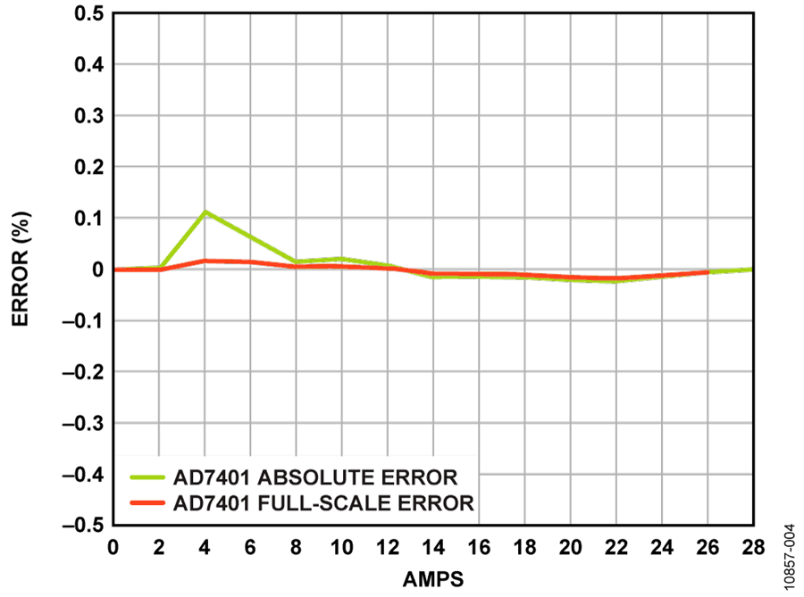

Linearity performance
The linearity of the module was analyzed at current conditions up to ±28A. As shown in Figure 4, linearity less than ±0.2% can be achieved after calibration. The voltages specified in the previous section were used in the analysis. Figure 4 shows both full-scale error and absolute error analysis, defined as follows:
Full-scale error = (Vshunt Vcalculated ) / Vfull -scale
Absolute error = (Vshunt Vcalculated ) / Vshunt
in
Vshunt = current in the precision shunt resistor (measured with DVM) Vcalculated = calculated current from the ADC output (AD7401A) Vfullscale = full - scale current range of the module ( 28 A).
The advantage of using the absolute error method is that the error can be analyzed at low measurement ranges, where the error performance is more prominent. This is important for solar applications because DC injection can be measured in the low current range.
Figure 4. AD7401A linearity performance

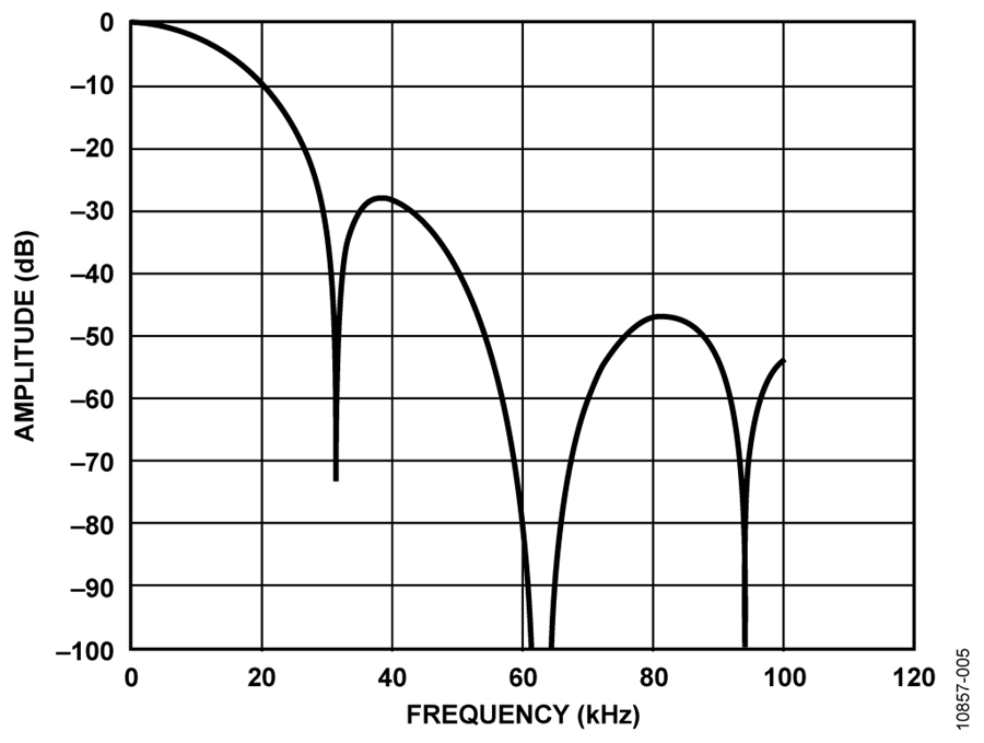

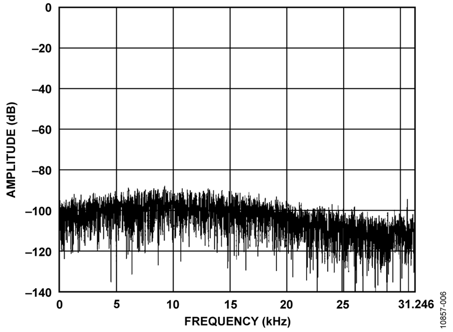

The AD7401A is specified at a extraction rate (DR) of 256, but the device can be used at other extraction rates. When DR = 256, the response of the sinc3 filter is shown in Figure 5, where the output data rate is 62.5 kHz and the FFT noise floor is shown in Figure 6.
Figure 5. Sinc3 filter response (decimation rate = 256, output data rate = 62.5 kHz)
Figure 6. Noise floor shown in 16K-point FFT (decimation rate = 256, output data rate = 62.5 kHz)

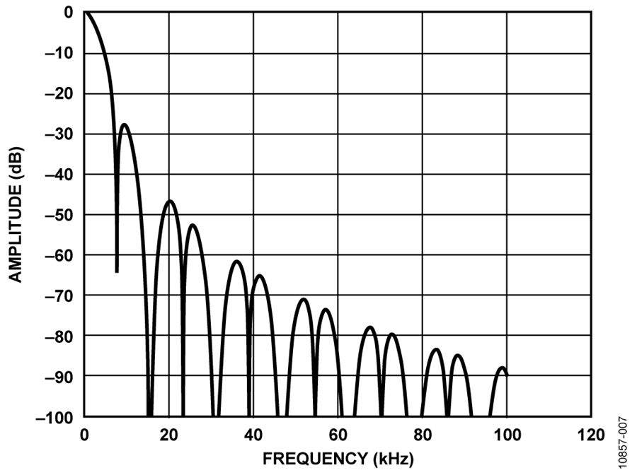

For higher decimation rates, the sinc3 filter response improves significantly. The response of the sinc3 filter is shown in Figure 7 when DR = 1024, where the data rate is 15.6 kHz. At this point, the system's noise performance has improved, as shown in Figure 8, but the data rate has been reduced.
Figure 7. Sinc3 filter response (decimation rate = 1024, output data rate = 15.6 kHz)

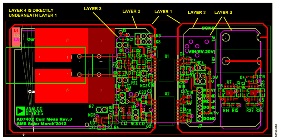

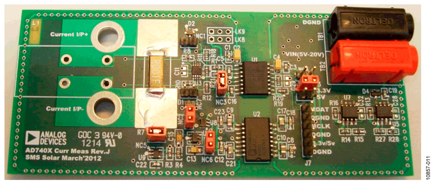

Layout considerations
Special care should be taken when designing printed circuit board (PCB) layouts, which must comply with relevant radiation standards. For board layout recommendations, see the AN-0971 application note . An example of this layout is shown in Figure 9. The key to the layout is to ensure there is good overlap between layer 3 (floating layer) and layer 2 (ground layer). This simple overlap can significantly reduce the radiation in the system. Figure 10 shows a top view of the PCB layout, and Figure 11 shows a photo of the actual circuit board.
Figure 9. Example of 4-layer circuit board
Figure 10. Recommended layout for current measurement
Figure 11. Photo of current measurement board
