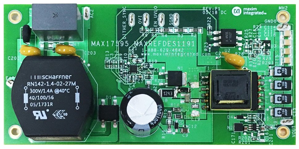

MAXREFDES1193: 15W, 24V offline flyback converter using MAX17595
MAXREFDES1193: 15W 24V Offline Flyback Converter Using the MAX17595

Topology
AC 176 284 0.625 Single 24 15 Flyback

Key Features
  • Programmable Switching Frequency Allows Optimization of the Magnetic and Filter Components, Resulting in Compact, Cost-Effective, Efficient Isolated/Nonisolated Power Supplies
  • 100kHz to 1MHz Programmable Switching Frequency with Optional Synchronization
  • Peak Current Mode Control Provides Excellent Transient Response—Offline (Universal Input AC)
    and Telecom (36V to 72V) Flyback Controller
  • Programmable Frequency Dithering Enables Low EMI Spread-Spectrum Operation
  • Integrated Protection Features Enhance System Reliability
  • Adjustable Current Limit with External Current Sense Resistor
  • Fast Cycle-By-Cycle Peak Current Limiting Hiccup-Mode Short-Circuit Protection
  • Overtemperature Protection
  • Programmable Soft-Start and Slope Compensation
  • Input Overvoltage Protection
This board is not available for purchase.
Designed, Built, Tested
This document describes the hardware. It provides a detailed systematic technical guide to designing an offline discontinuous conduction mode (DCM) flyback converter using Maxim’s MAX17595 current-mode controller. The power supply has been built and tested, details of which follow later in this document.
