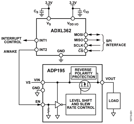

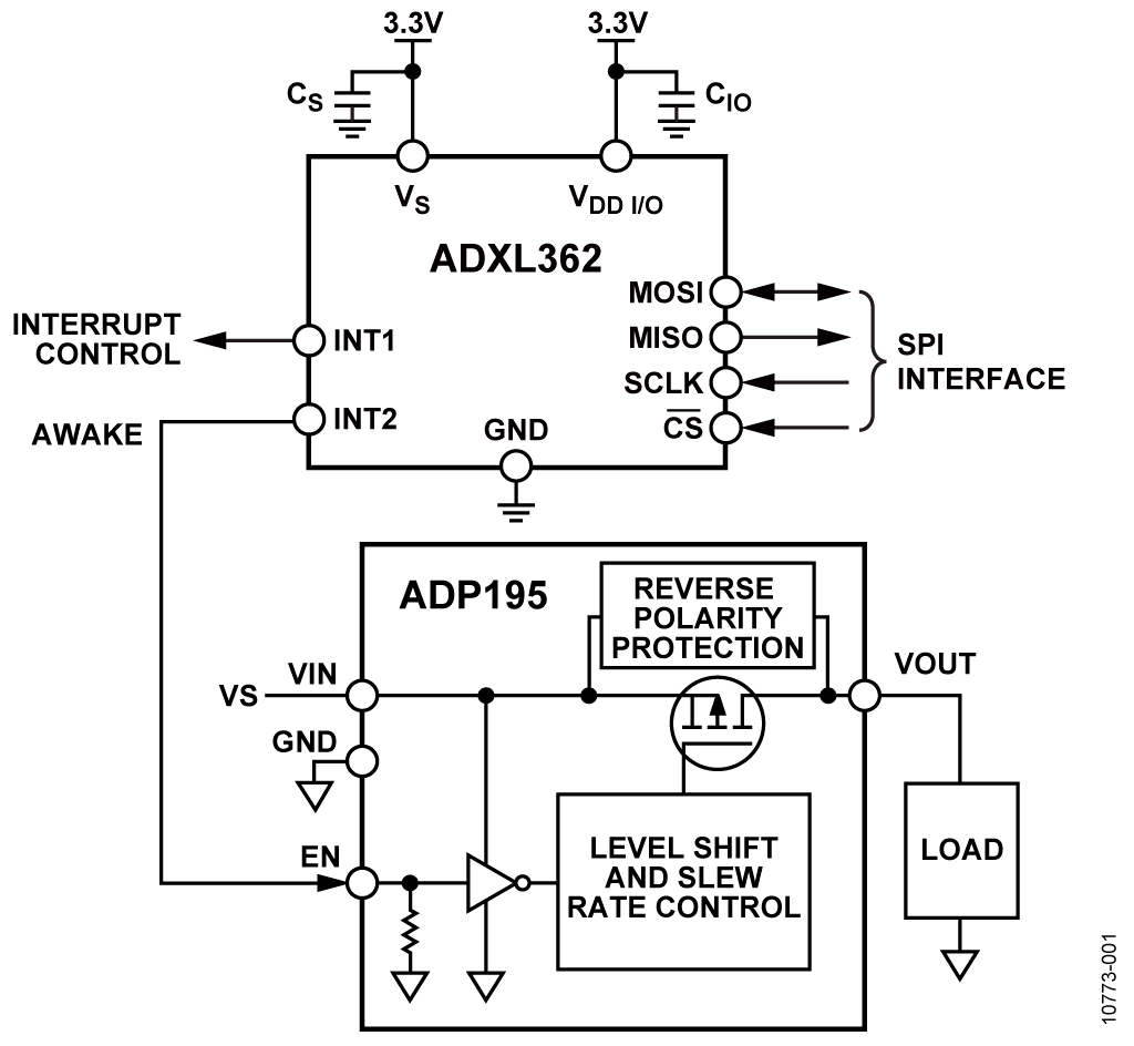

The circuit shown in Figure 1 uses a three-axis ADXL362 digital accelerometer and an ADP195 high-end power switch to build an ultra-low-power, motion-sensitive switch.
This combination of devices provides an industry-leading low-power solution for independent motion switches that control load power.
The ADXL362  is an ultra-low power three-axis accelerometer that consumes less than 100 nA in wake mode. Unlike accelerometers, which use power duty cycles to achieve low power consumption, the ADXL362 does not alias the input signal through undersampling; it samples continuously at the full data rate. There is also an on-chip, 12-bit temperature sensor with an accuracy of ±0.5°.
The output resolution of the ADXL362 is 12 bits and supports three operating ranges of ±2 g, ±4 g and ±8 g. The resolution within the ±2 g range is 1 mg/LSB. Applications requiring noise levels below 480μg/√Hz can select one of two low-noise modes (as low as 120μg/√Hz) with minimal increase in supply current.
The ADP195 is a high-end load switch that operates from a 1.1 V to 3.6 V supply and prevents reverse current flow from the output to the input. The device incorporates a low on-resistance P-channel MOSFET, which supports continuous load currents of more than 1.1 A and minimizes power losses.
Figure 1. Ultra-low power independent motion switch (schematic diagram: decoupling and all connections not shown)

The AWAKE bit is a status bit that indicates whether the ADXL362 is awake or sleeping. Detection of a motion condition indicates that the device is awake, and detection of a stationary condition indicates that the device is in sleep state.
The wake-up signal can be mapped to the INT1 or INT2 pin and therefore can be used as a status output to connect or disconnect power from downstream circuitry depending on the accelerometer's wake-up status. When used with loop mode, this configuration enables a tiny autonomous motion-activated switch.
If the on-time of the downstream circuitry is within acceptable limits, this motion switch configuration can significantly reduce system-level power consumption by eliminating standby power from the rest of the application. This standby power consumption typically exceeds the entire power consumption range of the ADXL362.

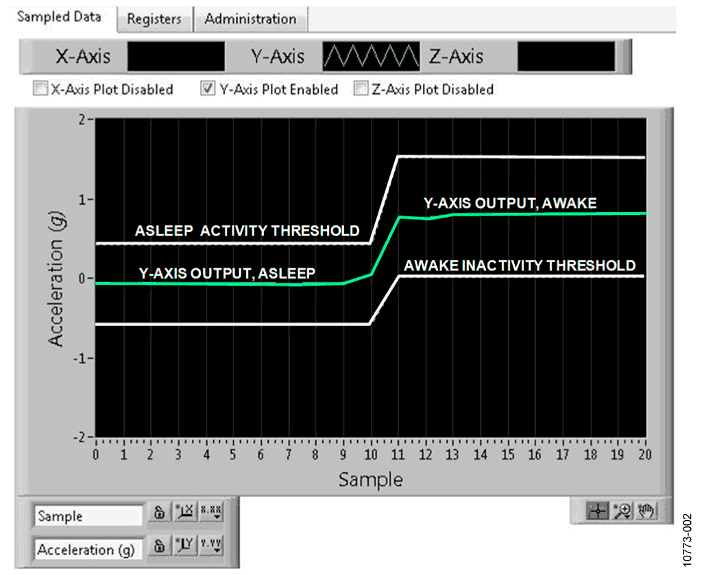

Test Results
All tests were performed using EVAL-CN0274-SDPZ and EVAL-SDP-CS1Z . To demonstrate the functionality of the device, the motion threshold was set to 0.5 g, the rest threshold was set to 0.75 g, and the number of rest samples was set to 20. When searching for motion, only one acceleration sample in any axis crosses the threshold.
Initially, with the circuit positioned so that the battery pack is flush with the table, the printed circuit board (PCB) is slowly rotated 90° in any direction, causing acceleration to cross the threshold as it approaches a position perpendicular to the initial orientation.
Figure 2 shows a screenshot of the CN0274 evaluation software, where the ADXL362 is initially sleeping and searching for motion. Then, when sample 11 crosses the threshold, the ADXL362 wakes up and begins searching for inactivity. The threshold is adjusted to indicate that the device is searching for quiescence.
Figure 2. Screenshot of evaluation software output
For better presentation, the X-axis and Z-axis curves have been disabled using the radio buttons on the graph.

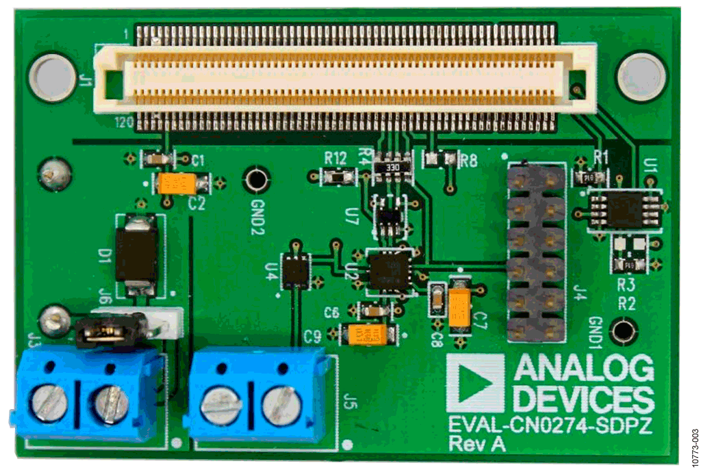

PCB layout considerations
In any circuit where precision is important, power and ground return layout on the circuit board must be carefully considered. The PCB should isolate the digital and analog parts as much as possible. The PCB of this system is stacked with 4-layer boards, with large area polygons for the ground layer and power layer. See the MT-031 guide for a detailed discussion of layout and grounding, and the MT-101 guide for information on decoupling techniques .
The ADXL362 power supply should be decoupled with 1 μF and 0.1 μF capacitors for proper noise suppression and ripple reduction. These capacitors should be placed as close to the device as possible. For all high frequency decoupling, ceramic capacitors are recommended.
Power traces should be as wide as possible to provide a low impedance path and reduce the effects of glitches on the power lines. Clocks and other fast-switching digital signals are digitally shielded so that they do not affect other components on the circuit board. A photo of the PCB is shown in Figure 3.

Figure 3. EVAL-CN0274-SDPZ PCB photo
