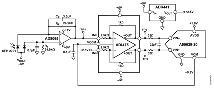

The circuit shown in Figure 1 is a high-speed photodiode signal conditioning circuit with dark current compensation function. The system converts current from a high-speed silicon PIN photodiode and drives the input of a 20 MSPS analog-to-digital converter (ADC). The device combination provides spectral sensitivity from 400 nm to 1050 nm and photocurrent sensitivity of 49 nA, a dynamic range of 91 dB, and a bandwidth of 2 MHz. The signal conditioning circuit is powered by a ±5 V power supply and consumes only 40 mA, making it suitable for portable high-speed, high-resolution light intensity applications such as pulse oximeters.
Figure 1. Photodiode preamplifier system with dark current compensation (schematic diagram: all connections and decoupling not shown)

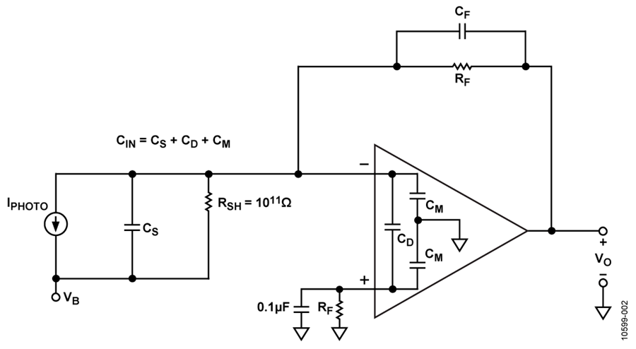

Figure 2. Equivalent circuit of broadband photodiode preamplifier for AC and noise analysis.
Figure 2 shows the electrical model of a current-to-voltage converter and a photodiode with the basic transfer function:
CN0272_Image1
where I PHOTO is the photodiode output current, and the parallel combination of RF and CF sets the signal bandwidth. Ideally, all of the photodiode's output current passes through R F , but all op amps have input bias currents that cause errors in their outputs. It is best to limit the input bias current of the op amp to a few pA and keep the input offset voltage low to minimize errors. The AD8065 has an input bias current of only 2 pA and an input offset voltage of only 400 μV.
This circuit is designed to provide a 5 V full-scale output with a maximum photodiode current of 200 μA. Determine the feedback resistor value from this:
CN0272_Image13
The stable bandwidth achievable with this preamplifier is a function of: R F , the gain-bandwidth product of the amplifier (65 MHz), and the total capacitance C IN of the summing point of the amplifier . For this circuit, the diode SFH 2701 (OSRAM Opto Semiconductors GmbH) maximum capacitance value C D = 5 pF. The AD8065 common-mode input capacitance is C M = 2.1 pF and the differential-mode input capacitance is C D = 4.5 pF. Therefore, the total input capacitance is C IN = 11.6 pF.
The resulting signal bandwidth at a 45° phase margin f (45) can be expressed as:
CN0272_Image2
Since the maximum achievable bandwidth is greater than the required bandwidth, the AD8065 is well suited for this application, mostly due to its large f CR to C IN ratio.

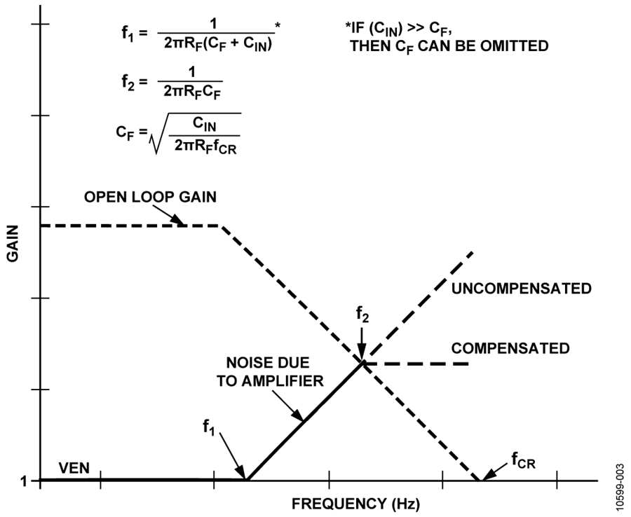

R F and C IN create a pole in the amplifier's loop transfer function, which can cause peaking and circuit instability (see Figure 3)). Increasing C F can create a zero in the loop's transfer function, which It can compensate for the effects of the above poles and reduce the signal bandwidth.
Figure 3. Input capacitance compensation
Selecting R F , the C F value that produces a 2 MHz bandwidth can be expressed as:
CN0272_Image3
By calculating the capacitance value required to obtain 45° phase margin, you can determine whether a 3.3 pF capacitor is sufficient to stabilize the system. The value of C F that yields f (45) can be expressed as:
CN0272_Image4
Since the required 3.3 pF is higher than the minimum of 1.1 pF, increasing the capacitor value increases the phase margin, so the system is stable.

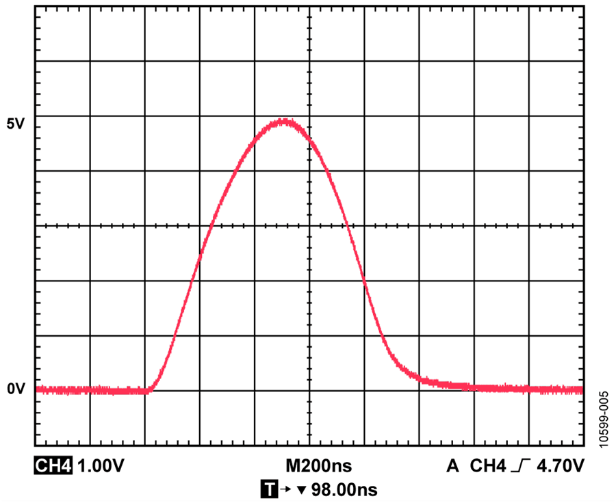

Use a laser diode to drive the D1 photodiode and generate a current. Photodiode D2 is used for dark current compensation and is covered with an optically opaque epoxy (EPO-TEK® 320) material that prevents D2 from generating output current when D1 is excited.

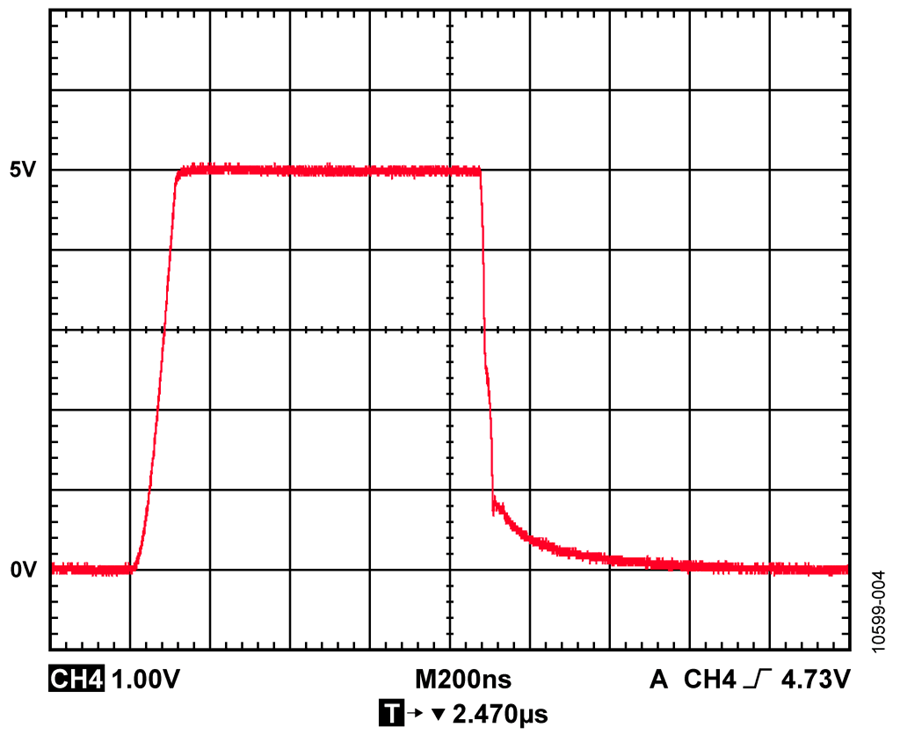

By forcing the photodiode to drive a higher current than expected, the AD8065's approximate maximum rise and fall times reach 72 ns (see Figure 4).
Figure 4. Pulse response obtained by overdriving the photodiode.
By changing the position of the laser diode so that it no longer overdrives the photodiode beyond 200µA, more practical system rise and fall times can be measured.
Figure 5 shows the AD8065 rise and fall measurements of 282 ns and 290 ns respectively. Note that due to sufficient phase margin, there is no ringing when the laser diode is turned off in both test cases.
Figure 5. Pulse response of laser diode

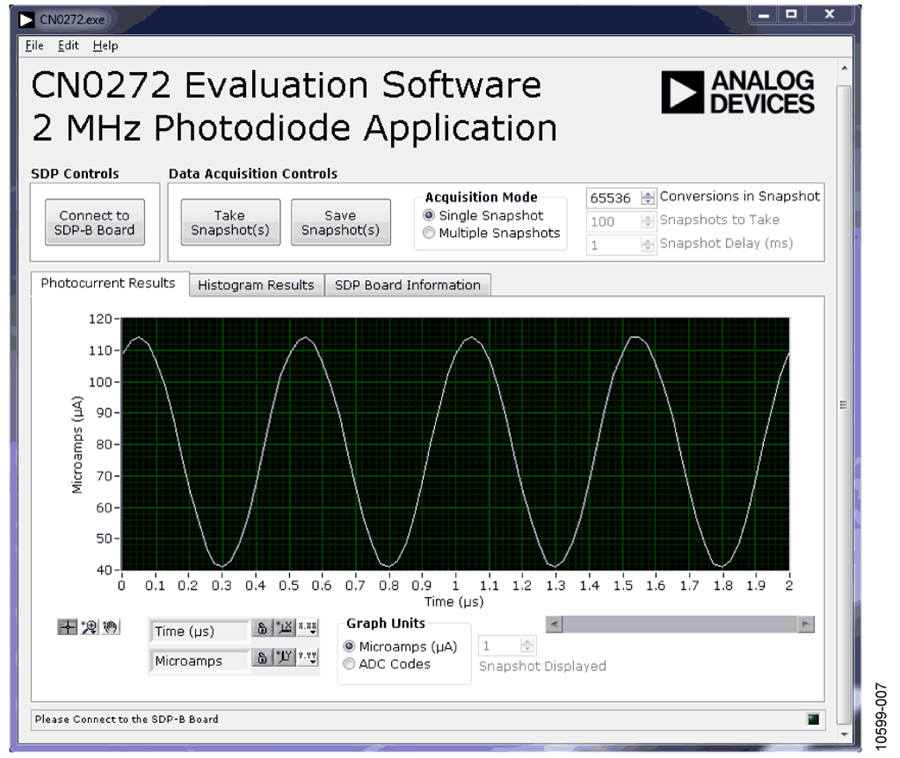

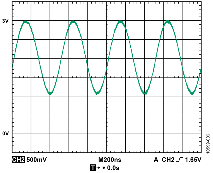

Now that the system's response to bright light pulses has been tested, the system's response to high-speed changes in light intensity can also be measured. An Agilent 33250A function generator was used to drive the laser diode with a 2 MHz sine wave. Figure 6 shows that the AD8065 can correctly detect small light intensity changes, and Figure 7 shows a screenshot of the CN0272 evaluation software correctly obtaining the conversion data of the AD9629-20 ADC and displaying it graphically.
Figure 6. AD8065 output using variable light source
Figure 7. Screenshot of CN0272 evaluation software digitizing a 2 MHz variable light source.
