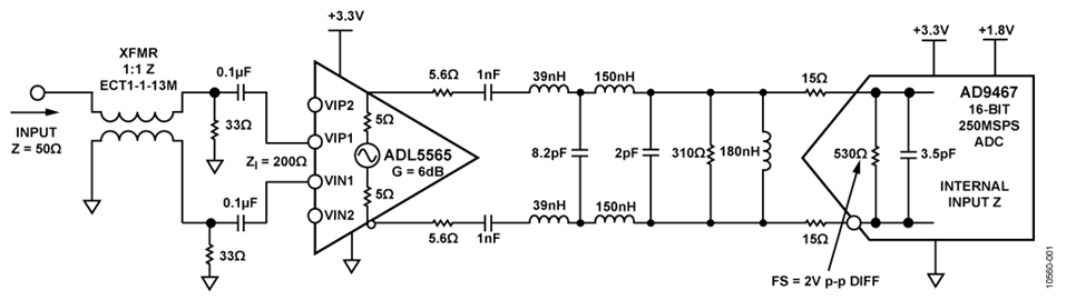

The circuit shown in Figure 1 is a 16-bit, 250 MSPS, narrowband, high-IF receiver front end that provides the optimal interface between the ADL5565 differential amplifier and the AD9467 ADC.
The AD9467 is a buffered input 16-bit, 200 MSPS or 250 MSPS ADC with SNR performance of approximately 75.5 dBFS and SFDR performance between 95 dBFS and 98 dBFS. Due to its high input bandwidth, low distortion, and high output linearity, the ADL5565 differential amplifier is suitable for driving intermediate frequency sampling ADCs.
This circuit note presents a systematic process for designing interface circuits and anti-aliasing filters to ensure minimum signal loss while maintaining high performance. Use the resonant matching method to design the flattest Butterworth fourth-order bandpass filter with a center frequency of 200 MHz.
Figure 1. Resonant filter design for narrowband, high-frequency applications using the ADL5565 differential amplifier and AD9467 ADC.

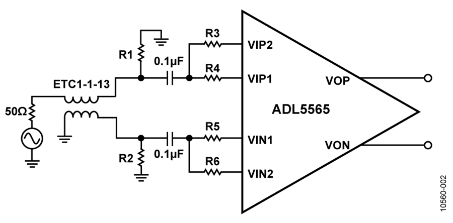

ADL5565 input impedance matching
Figure 2. ADL5565 input impedance matching

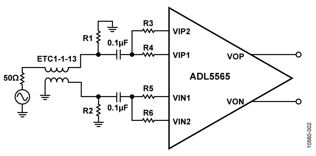

Figure 2 shows the input matching network recommended for use with the ADL5565. The input impedance of the ADL5565 is gain-dependent, with a differential input impedance of 200 Ω at 6 dB gain, 100 Ω at 12 dB gain, and 67 Ω at 15.5 dB gain. To match the 50 Ω source impedance of the signal generator to the input impedance of the ADL5565, R1 and R2 must be selected so that their sum equals 50 Ω in parallel with the ADL5565 input impedance ZI. To maintain balance within the differential circuit, R1 must equal R2. The following formula can be used to calculate the necessary matching resistors.
CN0268_equation1
Table 1 shows the calculated termination resistors and pin configurations for different gain settings of the ADL5565.
An alternative to the configuration shown in Figure 2 is to replace the 1:1 balun ETC1-1-13 with an impedance conversion RF transformer. This eliminates the need for R1 and R2. A 1:4 transformer can be used for the 6 dB gain configuration, and a 1:2 transformer can be used for the 12 dB gain configuration. The advantages of this alternative configuration are lower component count and lower signal loss. However, attention should be paid to the bandwidth of the transformer. Compared to a 1:1 balun, an impedance conversion transformer has a narrower bandwidth and higher insertion loss.
CN0268_table1
Figure 2 shows the single-ended to differential method of driving the ADL5565 using a balun or transformer. This configuration may not be feasible or necessary in some applications. The driver interface of the ADL5565 is flexible and can be driven single-ended (shown) or differentially using a differential mixer. Please refer to the ADL5565 data sheet for details on the different input interfaces.

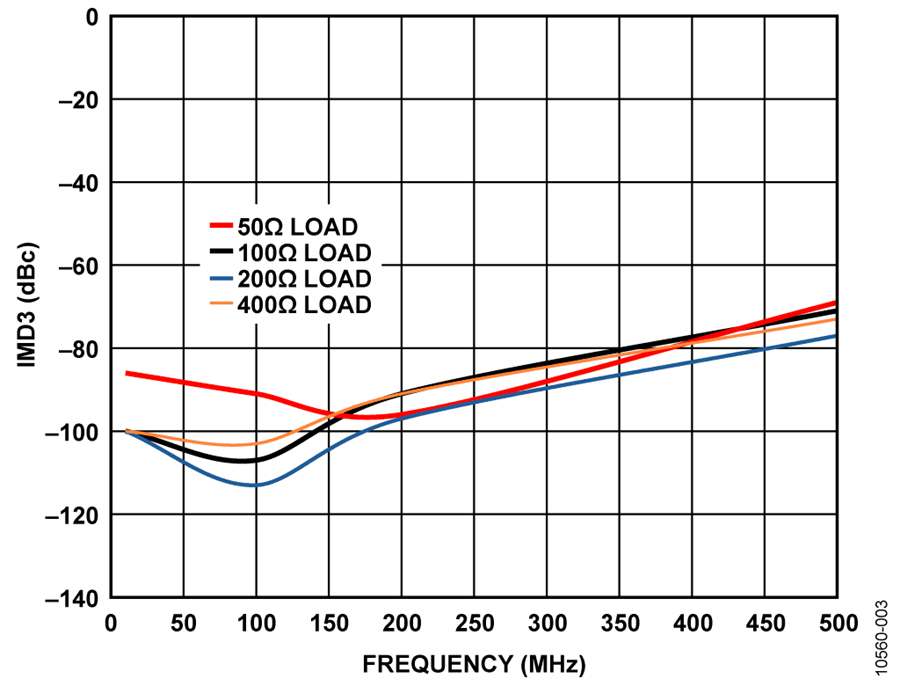

The ADL5565 linearity performance is optimized for a 200 Ω output load. This is a common output impedance used in interfacing with ADCs and in filter designs. With an optimized output load of 200 Ω, the ADL5565 has an output IP3 of 46 dBm at 200 MHz.
If a 200 Ω output load is not suitable for the application, there is a trade-off between the ADL5565's output load and linearity performance. Figure 3 shows a plot of third-order intermodulation (IMD3) versus common output load frequencies.
Figure 3. ADL5565 IMD3 versus frequency for 50 Ω, 100 Ω, 200 Ω, and 400 Ω output loads, 3.3 V supply, gain = 6 DB

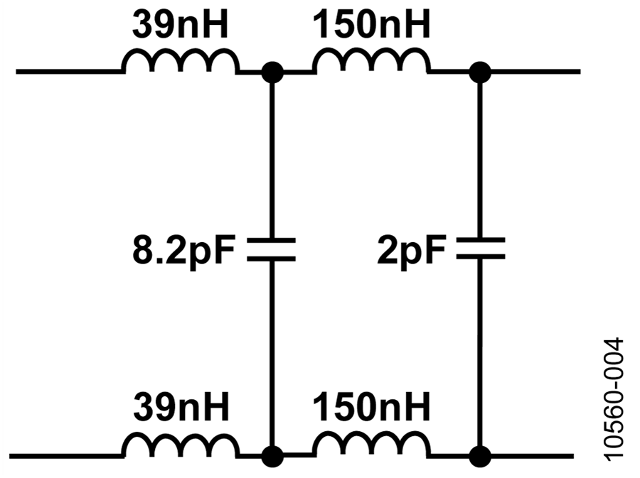

The anti-aliasing filter in front of the ADC helps reduce signal components and noise in the unwanted Nyquist zone, thereby avoiding in-band aliasing and degrading dynamic performance. Anti-aliasing filters are usually designed using LC networks. In order to obtain the required stopband and passband characteristics, the source impedance and load impedance must be selected appropriately. For example, filter design can be accomplished using software provided by Nuhertz Technologies or Agilent Technologies' Advanced Design System (ADS).
In the circuit shown in Figure 1, an ADS program is used to design a fourth-order flattest (Butterworth) low-pass filter. Figure 4 shows a low-pass filter design with source and load impedances of 200 Ω and a 3 dB cutoff frequency of 300 MHz. The 200 Ω impedance was chosen because it is a common source and load impedance for driver amplifiers and ADCs. The first components are series inductors used to relax driver requirements.
In the final optimized circuit in Figure 1, the filter source impedance is approximately equal to 21.6 Ω; however, for the low-pass part of the filter design, 200 Ω was chosen because the overall filter is ultimately a resonant bandpass filter, and more importantly , the amplifier and ADC must accept the correct load and source impedance to achieve optimized linearity performance. The result is amplitude loss due to impedance mismatch.
Figure 4. Low-pass filter design

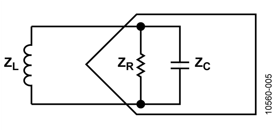

The low-pass filter design is further tuned by establishing resonance to produce peaking within the target frequency band. In this way, a narrow-band, band-pass filter at high and medium frequencies is obtained. Placing an inductor across the ADC's differential input zeros out the ADC's input capacitance and establishes peaking. Figure 5 shows the calculation used to determine the resonant inductance value. In the case of the AD9467's 3.5 pF source impedance, a parallel inductance of 181 nH is required to zero the capacitive susceptance; the result is only the high-impedance resistive portion of the RC parallel equivalent resistance. The resonant frequency chosen for the calculation is 200 MHz.
Figure 5. Resonance matching
CN0268_equation2

Figure 1 shows the final circuit configuration. Each output of the ADL5565 is padded with 5.6 Ω to improve driver amplifier stability. The recommended series resistance generally ranges from a few ohms to tens of ohms. Larger resistor values ​​improve stability; but the downside is power loss because the series resistor together with the impedance at the ADC input creates a voltage divider, causing signal attenuation.
Following the series resistor at the ADL5565 output is a 1 nF DC blocking capacitor. This is followed by an anti-aliasing filter, followed by a 310 Ω parallel resistor to reduce the input impedance of the ADC. Finally, a 15 Ω resistor is placed in series with the ADC input to isolate internal switching transients from the filter and amplifier.

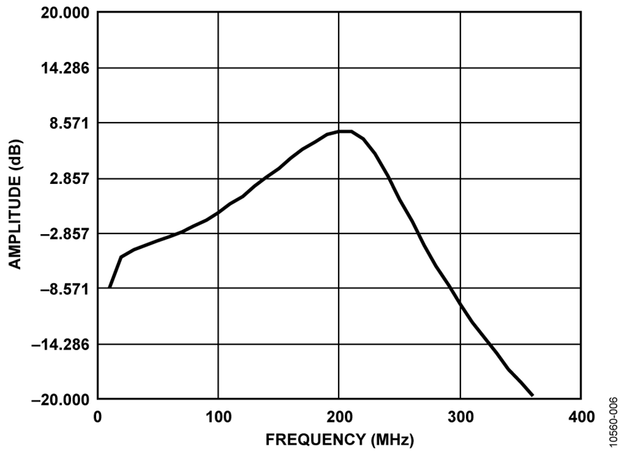

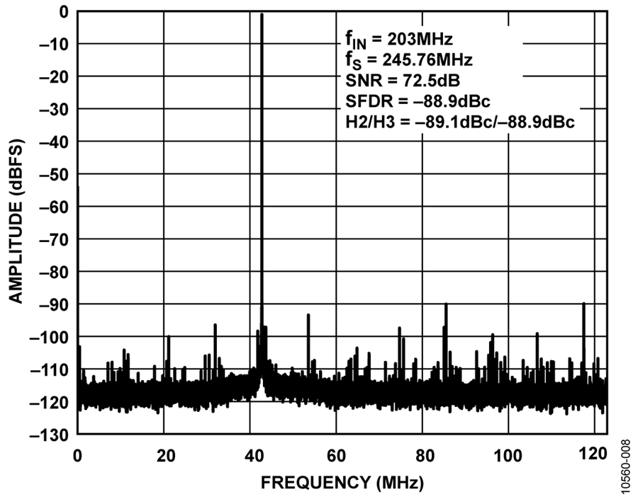

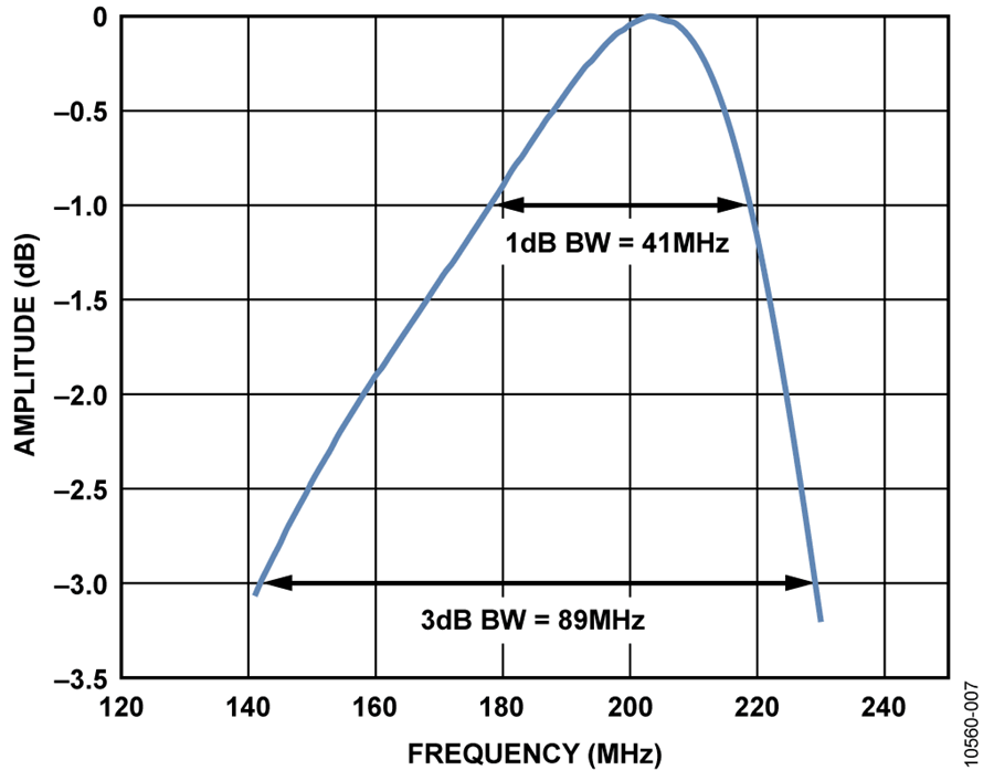

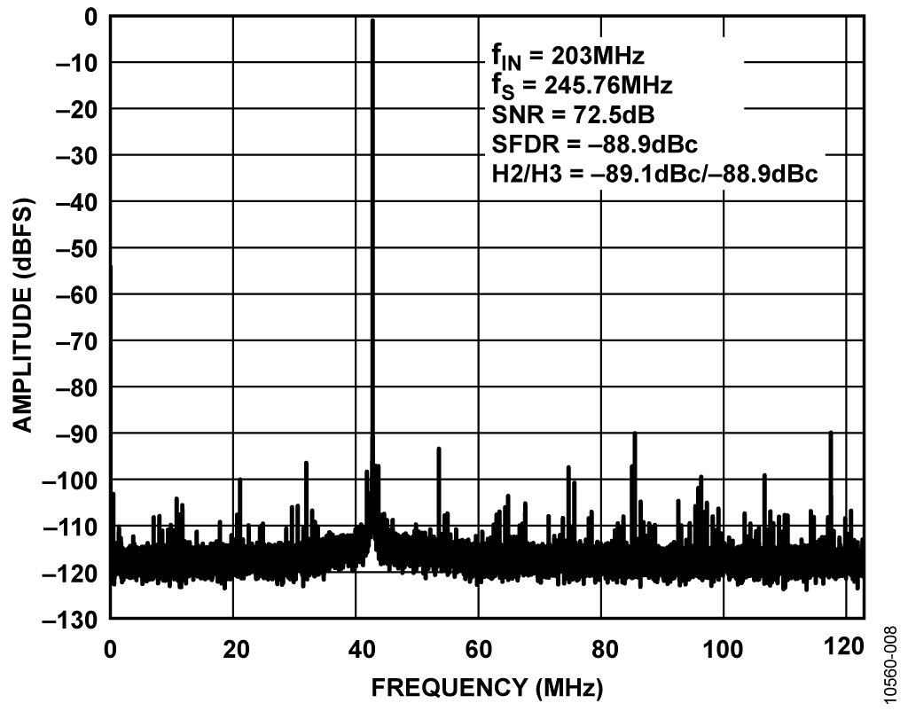

Figures 6 and 7 show the resulting anti-aliasing filter responses, with a 1 dB bandwidth of 41 MHz and a 3 dB bandwidth of 89 MHz, centered at the 203 MHz IF. Figure 8 shows the FFT spectrum of the final receiver circuit shown in Figure 1, where the SNR is 72.5 dBFS and the SFDR performance is close to 90 dBc.
Figure 6. Anti-aliasing filter response, FC = 203 MHZ
Figure 7. Anti-aliasing filter response, FC = 203 MHZ, 1 DB and 3 DB bandwidth
Figure 8. Single-frequency FFT plot, input = 203 MHZ, sample rate = 245.76 MSPS

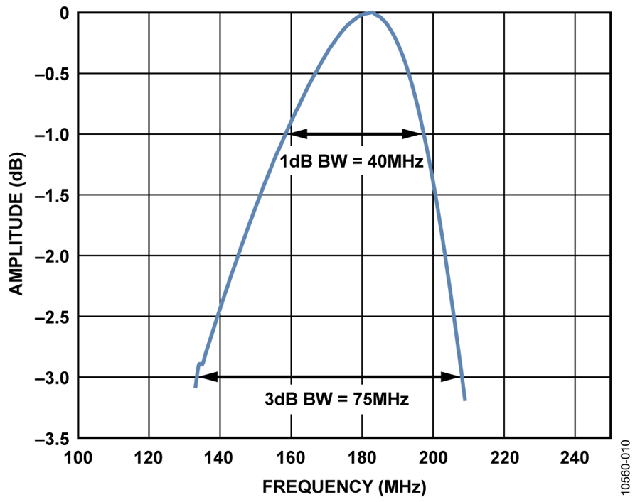

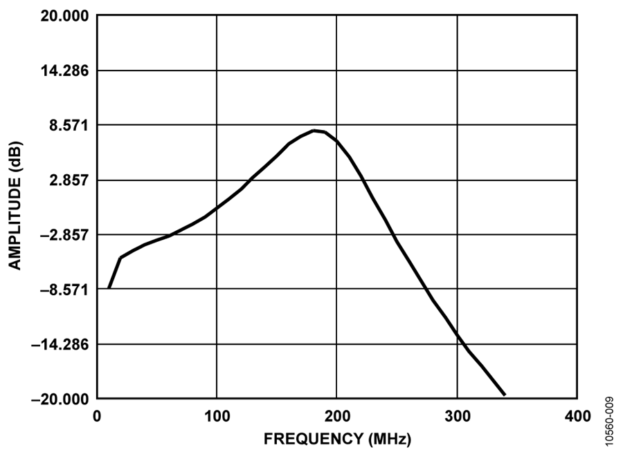

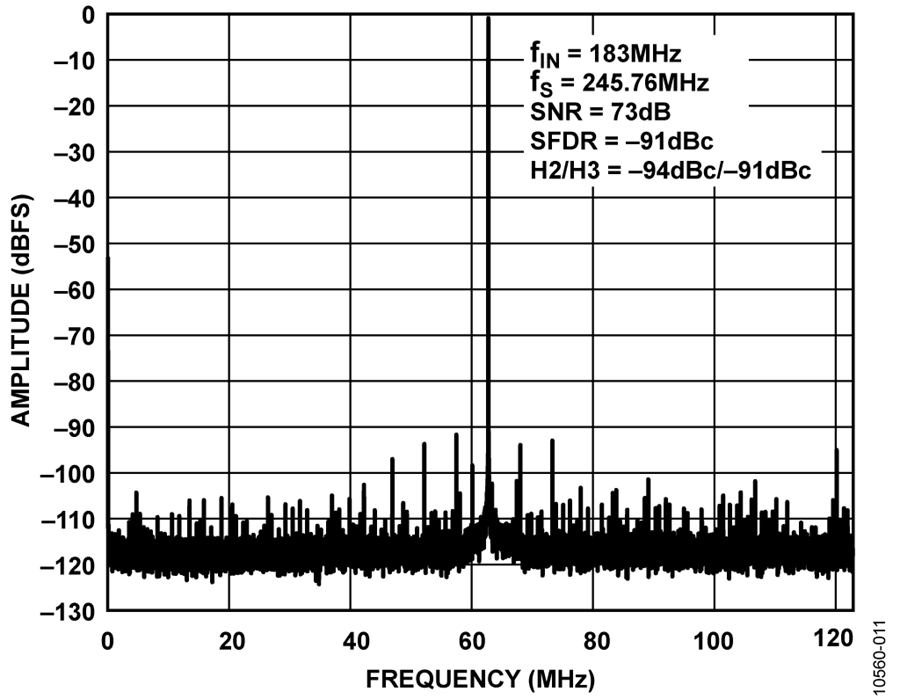

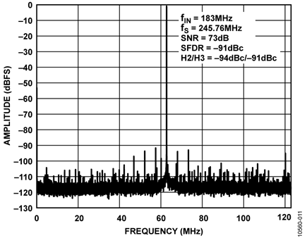

The filter elements can be further tuned using ADS as a simulation tool to shift the resonant peak to the desired intermediate frequency. For example, changing the antialiasing filter's parallel 8.2 pF capacitance to 10 pF reduces the resonant spike to 180 MHz. Figures 9 through 11 show the filter curves and single-frequency FFT performance under this condition.
Figure 9. Anti-aliasing filter response, FC = 183 MHZ
Figure 10. Anti-aliasing filter response, FC = 183 MHZ, 1 DB and 3 DB bandwidth
Figure 11. Single-frequency FFT plot, input = 183 MHZ, sample rate = 245.76 MSPS
