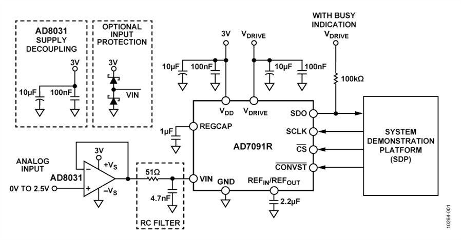

The circuit in Figure 1 is an ultra-low-power data acquisition system using the AD7091R 12-bit, 1 MSPS SAR ADC and AD8031 op amp driver. The total power consumption of the circuit is less than 5 mW and operates from a single 3 V power supply.
The low power consumption and small package size of the selected devices make this combination an industry-leading solution for portable battery-powered systems where power consumption, cost and size are critical.
When the VDD pin is 3 V, the AD7091R's supply current is only 350μA typical, which is significantly lower than any competing ADC product currently on the market. This means typical power consumption is about 1 mW.
The AD8031 requires only 800 μA of supply current and consumes a typical power consumption of 2.4 mW at a supply voltage of 3 V. The total system power consumption is less than 5 mW when sampling at 1 MSPS with a 10 kHz analog input signal.
Figure 1. 12-bit, 1 MSPS low-power ADC with integrated driver (schematic: all connections not shown)

The AD8031 is a low-power rail-to-rail input/output operational amplifier that is a very suitable driver amplifier for the AD7091R. The AD8031 operates from a 2.7V to 1 V supply and supports driving two ICs from a single supply rail. The AD8031 has an 80MHz bandwidth, a slew rate of 30V/μs, and a settling time of 125 ns to 0.1% accuracy.
When operating from a single supply, the AD8031 output can reach within 20mV of the negative supply rail. If linearity at 0V input is required, the AD8031 requires an additional negative supply (refer to Tutorial MT-035 ).
Figure 1 shows a simplified circuit diagram. Use 100 nF and 10μF ceramic capacitors to achieve good ground decoupling of the IC power pins. Place these capacitors as close as possible to the power pins of both ICs.
Remember, the analog input signal to this ADC cannot exceed the supply rail by more than 300 mV. If the signal exceeds this level, the internal ESD protection diodes become forward biased and begin conducting current into the substrate. The maximum conduction current of the diode is 10 mA, and irrecoverable device damage will not be caused below this current. Protection can be achieved by connecting a pair of Schottky diodes between VIN and the power rail of the AD7091R, as described in tutorial MT-036.
The AD7091R integrates an internal 2.5 V reference. Good decoupling of the REF IN /REF OUT pins achieves the specified performance. The typical value of the REFIN/REFOUT capacitor is 2.2μF. Note that the internal reference voltage can be externally loaded.
If an external reference voltage is used, the voltage range must be 2.7V to VDD and the REFIN/REFOUT pin must be connected. The typical value of the regulator bypass (REGCAP) decoupling capacitor is 1µF.
The voltage applied to the V DRIVE input controls the logic-level voltage of the serial interface. Connect this pin to the supply voltage of the logic family, which is connected to the AD7091R digital output. V DRIVE can be set to a value in the range 1.8 V to VDD. A typical value for the VDRIVE decoupling capacitor is 100nF in parallel with 10µF.
If the busy indicator function is required, a 100kΩ pull-up resistor can be connected between the V DRIVE and SDO pins.
The AD8031 used to buffer the analog input of the AD7091R is configured as a unity gain buffer. Connect a single-pole RC filter after the op amp's output stage to reduce out-of-band noise. The cutoff frequency of the RC filter is set to 660kHz. However, this parameter may vary depending on the system throughput rate requirements. For systems where the AD7091R is not operating at the maximum throughput rate, the filter cutoff frequency can be reduced. Depending on the input amplitude and offset of the analog signal, the AD8031 op amp can be configured to provide gain, attenuation, and level translation to match the input signal swing of the ADC analog input range.

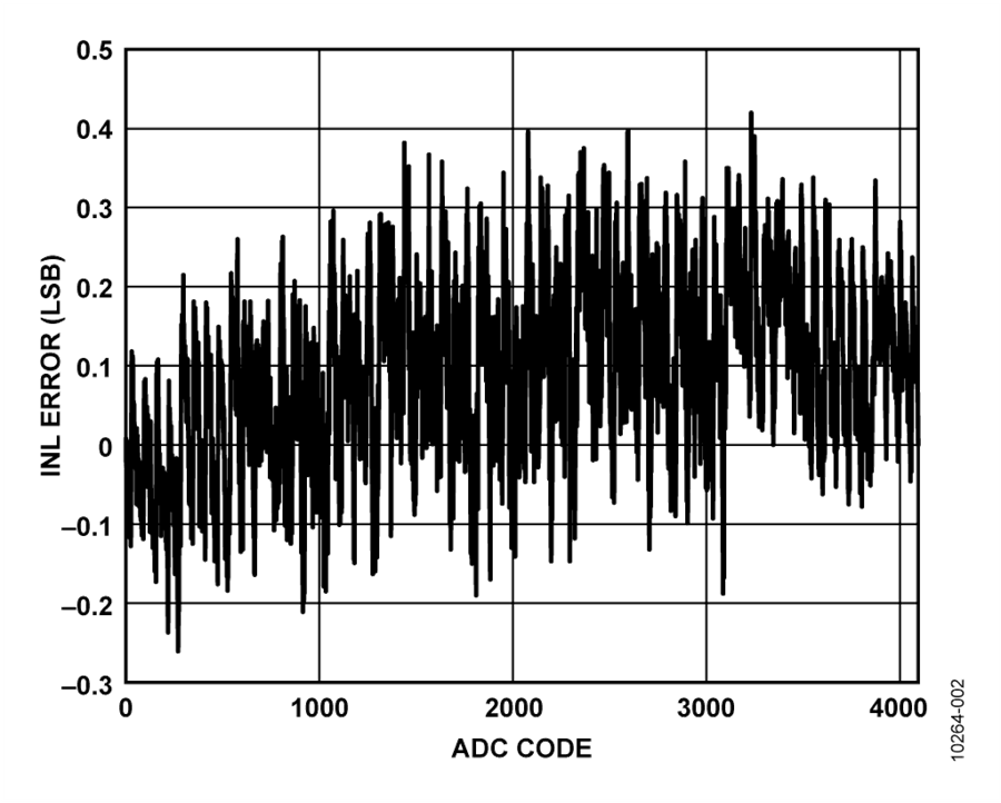

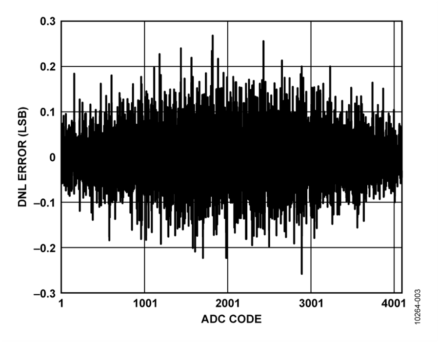

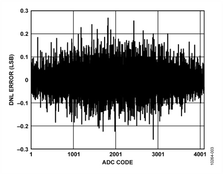

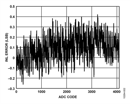

Figures 2 and 3 show the integral nonlinearity (INL) and differential nonlinearity (DNL) curves of the circuit. Note that INL and DNL are less than ±1 LSB.
Figure 2. INL at 1 MSPS sampling rate
Figure 3. DNL at 1 MSPS sampling rate

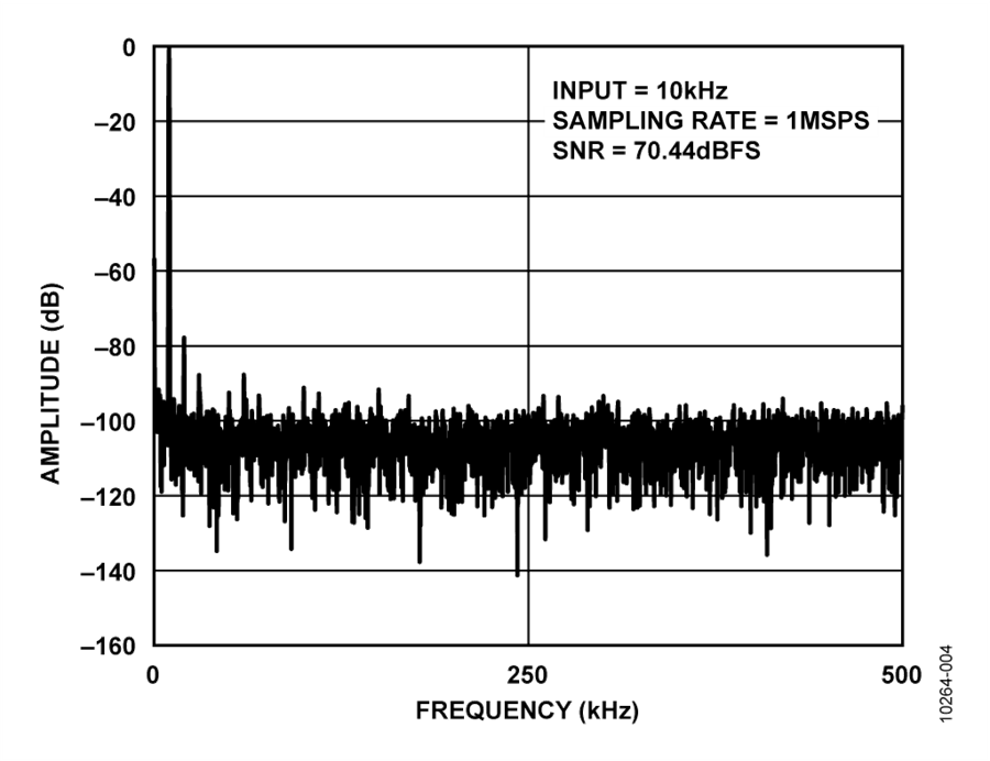

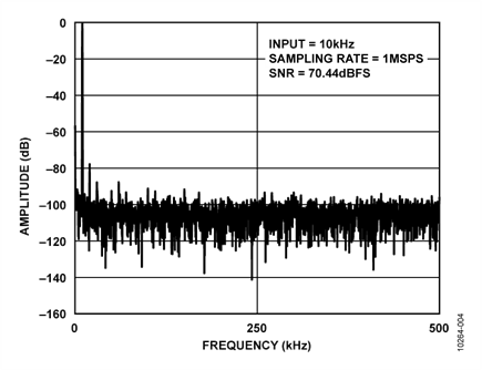

Figure 4 shows the FFT data calculated for 8192 samples; the sampling rate is 1MSPS and the analog input frequency is 10 kHz. SNR is 70.44 dBFS.
Figure 4. FFT of system, input = 10 kHz, sampling frequency = 1 MSPS
