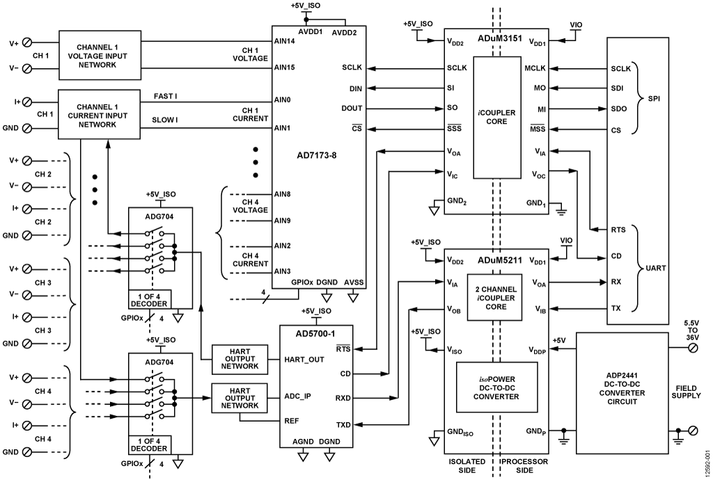

PLC/DCS four-channel voltage and current input, compatible with HART
Circuit description
Data conversion is accomplished by a 24-bit Σ-Δ analog-to-digital converter (ADC) AD7173-8 . The AD7173-8 is software configurable, allowing 8 fully differential or 16 single-ended input channels, providing great flexibility through a built-in crossbar multiplexer. The AD7173-8 is available in a small 6 mm × 6 mm LFCSP package, making it an ideal choice for applications where space is limited. An internal clock and precision 2.5 V voltage reference reduce external components, further saving space. Four programmable general-purpose output pins (GPIO0, GPIO1, GPO2, GPO3) allow control of an external multiplexer, thus switching multiple HART interfaces, thereby reducing additional wiring from the processor/controller. The AD7173-8 has internal calibration registers that can be programmed to provide offset and gain calibration on the full input path.
The AD5700-1 is the industry's lowest power, smallest package, HART-compatible modem, and together with the current input channels form a HART-compatible, 4 mA to 20 mA receiver solution. The AD5700-1 includes an internal precision oscillator for additional space savings, especially in isolation applications. The
ADG704 multiplexer provides connections between multiple current input channels and HART.
The ADuM5211 isolates the two data channels (Tx, Rx) and provides 5 V supply isolation through integrated isoPower® technology. The ADuM3151 PIsolator provides serial peripheral interface (SPI) isolation at clock rates up to 17 MHz (Class B) while isolating three additional data channels.
The ADP2441 is a 36 V, step-down regulator that accepts industry-standard 24 V supplies and has a wide input voltage. The ADP2441 reduces the input voltage to 5 V to power all controller-side circuitry. The circuit also includes peripheral protection on the standard 24 V input.
Figure 1.
Figure 1. PLC/DCS four-channel voltage and current input front end (simplified schematic: all connections and decoupling circuits are not shown)

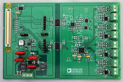

The evaluation board is powered from a 5.5 V to 36 V DC supply and uses an on-board switching regulator to provide 5 V to the system, as shown in Figure 5. In the test setup, 5 V powers the EVAL-SDP-CB1Z Demonstration Platform (SDP) evaluation board. The EVAL-SDP-CB1ZSDP board provides VIO's 3.3V voltage. The high switching frequency of the ADP2441 provides minimal output voltage ripple
even when using a small inductor sizeThe choice of inductor size requires a trade-off between efficiency and transient response. A small inductor will cause a large inductor current ripple, which can provide good transient response, but the efficiency will be reduced. Due to the high switching frequency of the ADP2441, it is recommended to use shielded ferrite core inductors because they have low core losses and low electromagnetic interference (EMI). In the circuit of Figure 5, the switching frequency is approximately 1 MHz and is set by an 88.7 kΩ external resistor. The 12 μH inductor (Coilcraft LPS6235-123MLC) was selected according to Table 8 of the ADP2441 data sheet. The circuit is connected to a 5.5 V to 36 V power supply via screw terminals. The EARTH terminal can be connected to the external earth, and is always connected to the GND terminal when external grounding is not used. A power inductor (DR73-102-R), varistor (V56ZA3P, 56 V), power diode (S2A-TP, 50 V) and a 1.1 A fuse provide additional input voltage transient protection.

A complete design support package for the EVAL-CN0364-SDPZ evaluation board, including schematics, BOM and layout, can be downloaded from www.analog.com/CN0364-DesignSupport .
