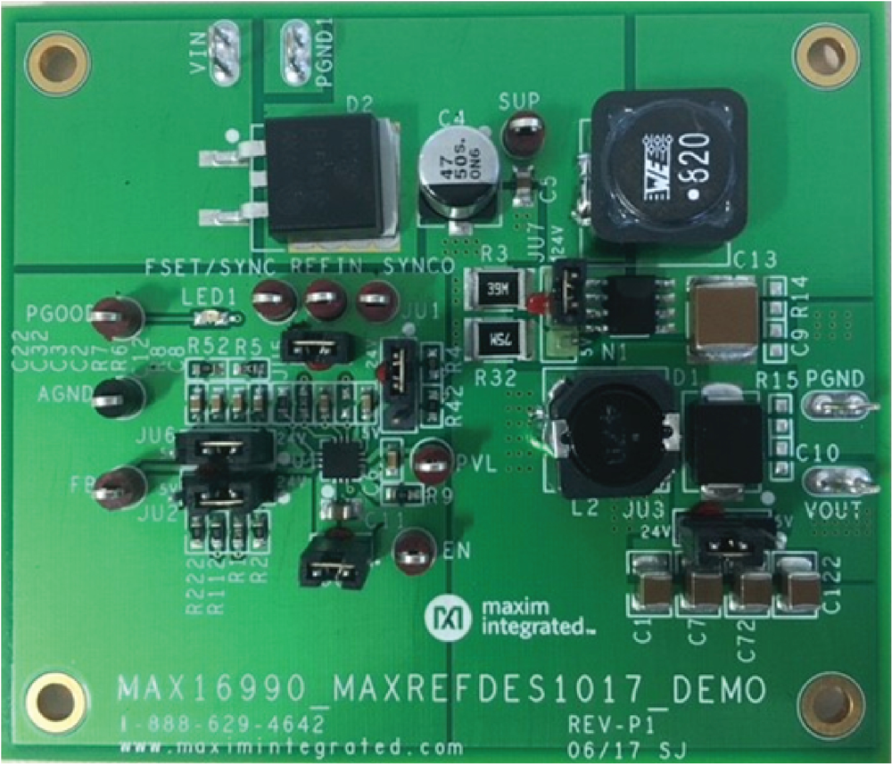

A single-output SEPIC converter using the MAX16990 is demonstrated for a 18V to 32V input voltage range application. The output is selectable to be equal to either +24V or +5V using configurable jumpers present on the PCB. The power supply delivers up to 0.9A max load current.
Designed, Built, Tested
This document describes the hardware show in Figure 1. It provides a detailed systematic technical guide to designing a SEPIC converter using Maxim’s MAX16990 current mode controller. The power supply uses uncoupled inductors and has been built and tested, details of which follow later in this document.
