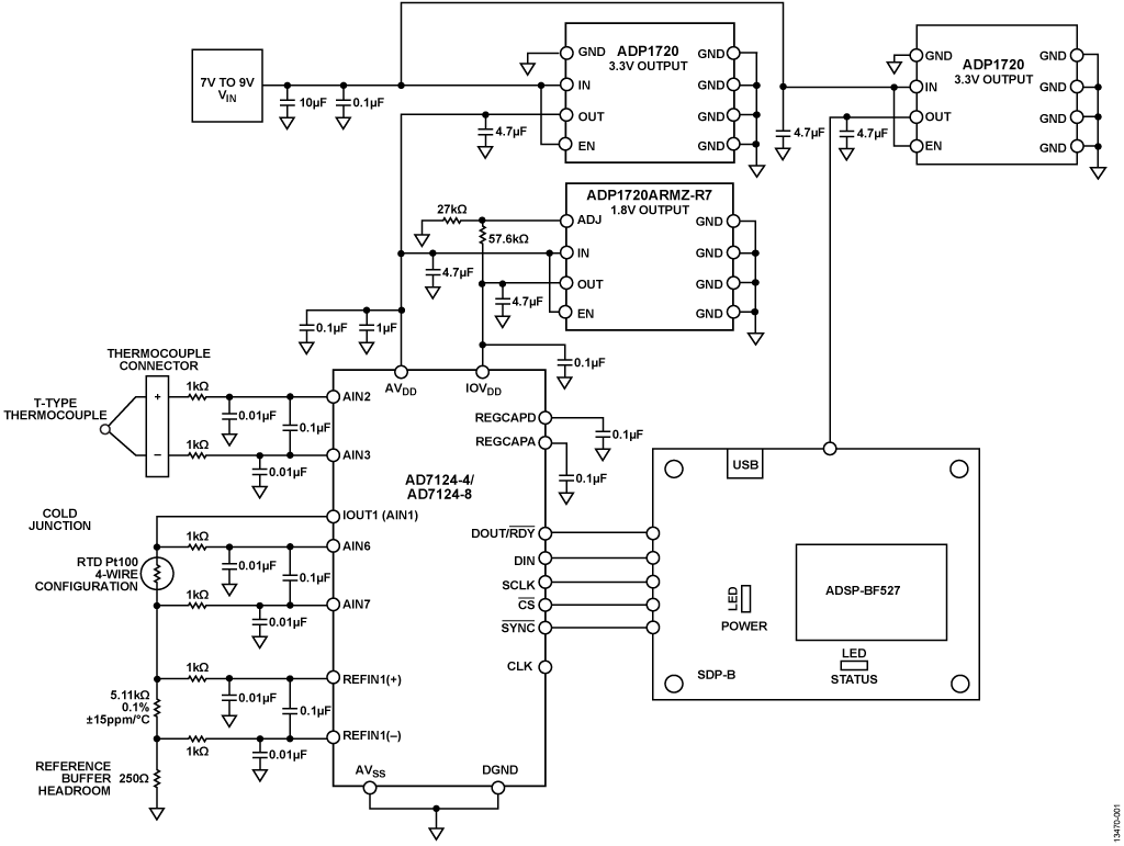

Circuit Operation The
AD7124-4/AD7124-8 provide an integrated thermocouple measurement solution that achieves high resolution, low nonlinearity error, low noise performance, and extremely high 50 Hz/60 Hz rejection. The device integrates a low-noise PGA on-chip, which can amplify the small signal of the thermocouple. The gain programming range is from 1 to 128, so it can be directly interfaced with the sensor. The gain stage has a high input impedance and input leakage current does not exceed 3.3 nA in full power mode and 1 nA (typ) in low power mode. The following describes the different components used to develop a thermocouple temperature measurement system based on AD7124-4/AD7124-8
The power supply

For the circuit shown in Figure 1, two analog input pins are used to connect the thermocouples (AIN2, AIN3) and three analog pins are required for cold junction compensation (AIN1, AIN6, AIN7). AIN2 and AIN3 are configured as fully differential input channels for measuring the voltage generated by the thermocouple. For this circuit, as shown in Figure 1, the thermocouple is floating. To bias a thermocouple to a known level, enable the V BIAS voltage generator on AIN2, biasing the thermocouple to the following values:
CN0384-EQU-A
Thermocouple measurements are absolute measurements and therefore require a voltage reference, use the AD7124-4/ The AD7124-8 has a built-in 2.5 V reference.
For cold junction compensation, an excitation current source is used to excite the RTD. This current is generated from AV DD and flows to AIN1. Figure 5 shows the analog pins and their configuration in detail.
Figure 5. Analog input configuration for thermocouple measurements using a 4-wire RTD for cold junction compensation
For this circuit, the cold junction circuit uses the reference input REFIN1(±). The current flowing through the 4-wire RTD (used for cold junction measurements) also flows through the precision reference resistor, producing the reference voltage. The voltage developed across this precision reference resistor is proportional to the voltage across the RTD, so fluctuations in the excitation current are canceled out. Since the reference buffer is enabled, it is important to meet the required headroom for proper operation (AV DD − 0.1 V and AV SS + 0.1 V). A margin of 0.125 V (500 μA × 250 Ω) is provided by the 250 Ω resistor to ground, as shown in Figure 5.

The AD7124-4/AD7124-8 full system configuration for thermocouple measurement is as follows:
  • Thermocouple measurement (T type)
    • Differential input (AINP = AIN2, AINM = AIN3)
    • Gain = 128
    • 2.5 V internal voltage reference
    • Digital filtering (sinc 4 and post filter)
  • Cold junction compensation measurement (4-wire RTD)
    • Differential input (AINP = AIN6, AINM = AIN7)
    • Excitation current: IOUT1 = AIN1= 500 μA
    • Gain = 16
    • 5.11 kΩ precision reference resistor
