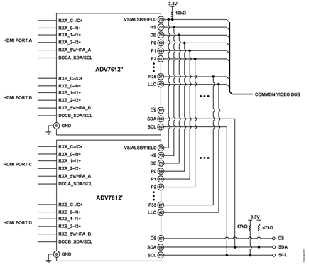

The ADV7612 provides a receiving solution for dual HDMI inputs. Figure 1 shows how to connect two ADV7612s in parallel on a shared video and audio bus to multiplex four HDMI inputs. It also shows how to set up I2C communication and switch between signal sources without causing bus conflicts. A software package is also provided showing how to handle communication and authentication in an HDMI repeater application (see http://ez.analog.com/community/video ).

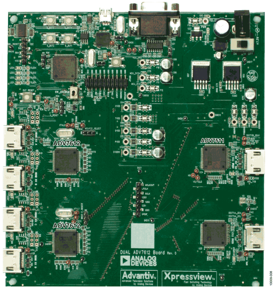

The device must be controlled from the I2C bus in a non-conflicting manner. The board layout of this circuit is critical and should follow straight-line principles and use controlled impedance to reduce the risk of reflections and cross-coupling. The complete PCB layout is included in the design support package, which can be downloaded from: www.analog.com/CN0224-DesignSupport . The ADV7511 HDMI transmitter is used as the back-end device.

Only one ADV7612 can access the AV bus at a time; the second device must remain tri-stated. Assuming the output driver impedance (P0…P35) is 10 Ω to 20 Ω (highest drive strength) and the trace characteristic impedance is 75 Ω, a series resistor of 55 Ω to 65 Ω is required to match the characteristic impedance of the trace. The tri-state output bus driver on the ADV7612 has a maximum capacitance of 20 pF (refer to the electrical specifications in the ADV7612 data sheet ).

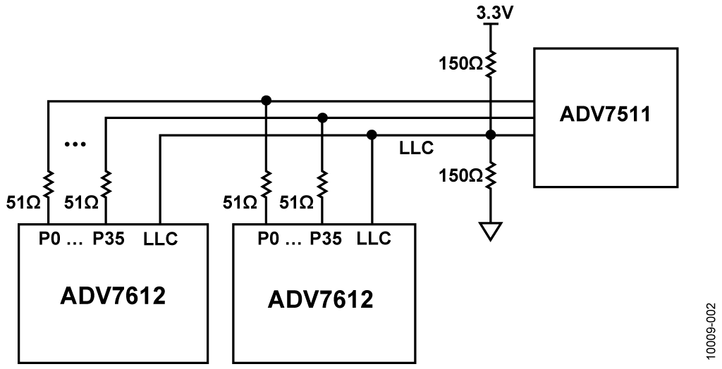

For pixel lines (P0…P35), video sync (VS/FIELD/ALSB, HS, DE) and audio lines (AP0, AP1/I2S_TDM, AP2…AP5, MCLK/INT2, SCLK/INT2) – except LLC , it is recommended to use a 51 Ω series termination resistor on the ADV7612 driver side, and a trace with a characteristic impedance of 75 Ω.
The Line Locked Clock (LLC) lines have the same 75 Ω characteristic impedance and should have no series resistance, but the far end should be symmetrically terminated (150 Ω to +3.3 V and 150 Ω to GND) as shown in Figure 2. Although the theoretical optimal termination value is between 50 Ω and 60 Ω, testing found that a symmetrical 75 Ω (2 × 150 Ω) termination increases the swing so that the signal is centered around the mid-supply (1.65 V). One point is ideal. The ADV7511 HDMI transmitter is included on the board and is used to send the multiplexed outputs of two ADV7612s.
Figure 2. Termination of P0…P35 data lines and LLC traces

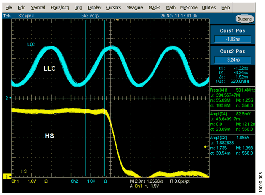

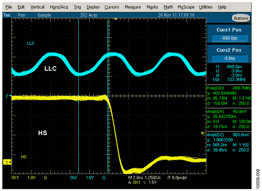

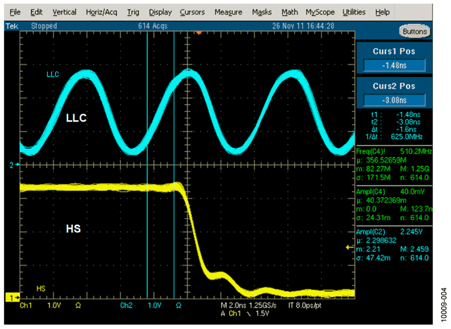

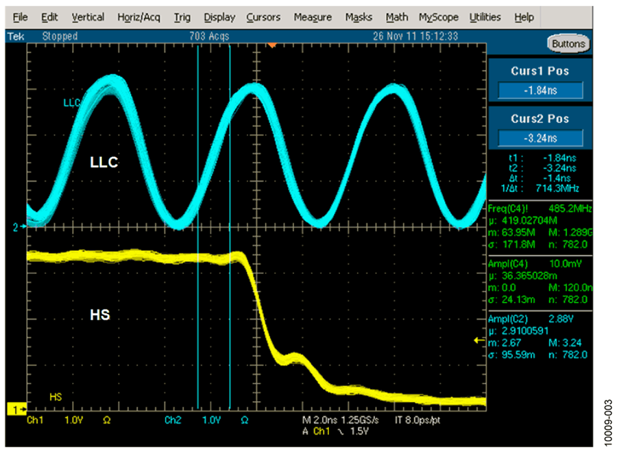

Figures 3 through 6 show the waveforms for various terminations. In each case, the symmetrical LLC termination is placed at the far end (near the ADV7511) and the series termination resistor is placed as close as possible to the two ADV7612 devices, as shown in Figure 2.
Measurements were performed on the ADV7511 pins using a Tektronix P6243 FET probe (1 MΩ impedance, 1 GHz bandwidth, capacitance less than 1 pF) and a Tektronix TDS5104B oscilloscope.
As can be seen from the waveform, using a 2 × 150 Ω termination on the LLC line ensures a maximum swing of 3.3 V.
Using 75 Ω on the data lines will result in too low edge speeds. 33 Ω and 15 Ω on the data lines cause falling edge undershoot (Figure 5 and Figure 6) and rising edge overshoot (not shown). Therefore LLC chose 2 × 150 Ω and used 51 Ω on the data lines, as illustrated by the eye diagrams in Figures 9 and 10.
Figure 3. Termination: symmetrical 2 × 150 Ω on LLC lines, 75 Ω on data lines (HS). Vertical scale: 1 V/div, horizontal scale: 2 ns/div
Figure 4. Termination: symmetrical 2 × 100Ω on LLC lines, 51Ω on data lines (HS). Vertical scale: 1 V/div, horizontal scale: 2 ns/div
Figure 5. Termination: symmetrical 2 × 68 Ω on LLC and series 33 Ω on data lines (HS). Note the 0.5 V undershoot. Vertical scale: 1 V/div, horizontal scale: 2 ns/div
Figure 6. Termination: symmetrical 2 × 33 Ω on LLC and series 15 Ω on data lines (HS). Note the 1 V undershoot. Vertical scale: 1 V/div, horizontal scale: 2 ns/div

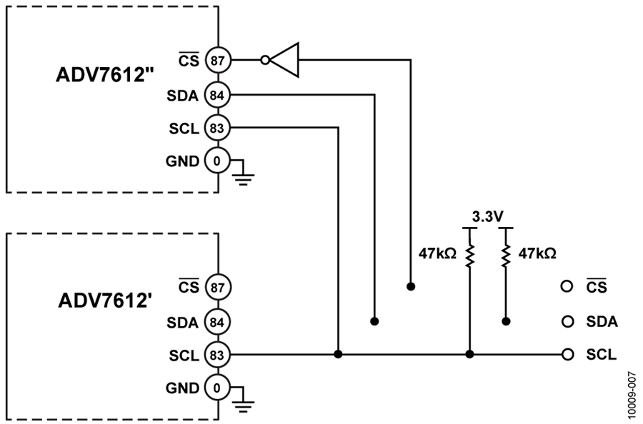

I 2 C access
After power-up, both ADV7612 devices will have the same I 2 C address on the master map , which may cause a conflict.
A CS CS pin is available on both devices , allowing selection of one of the two devices. After the CS line is pulled low, I 2 C communication is enabled.
When the CS line is pulled high, I 2 C communication is disabled.
A simple inverter reduces the resources required on the microcontroller side, as shown in Figure 7.
Figure 7. I2C access

Figure 8. Dual ADV7612 board solution with ADV7511

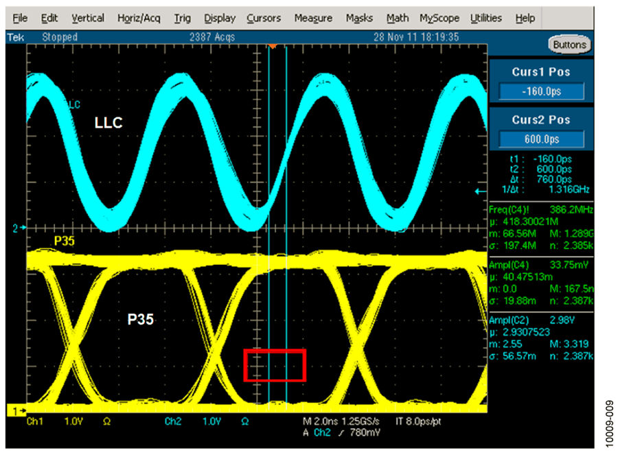

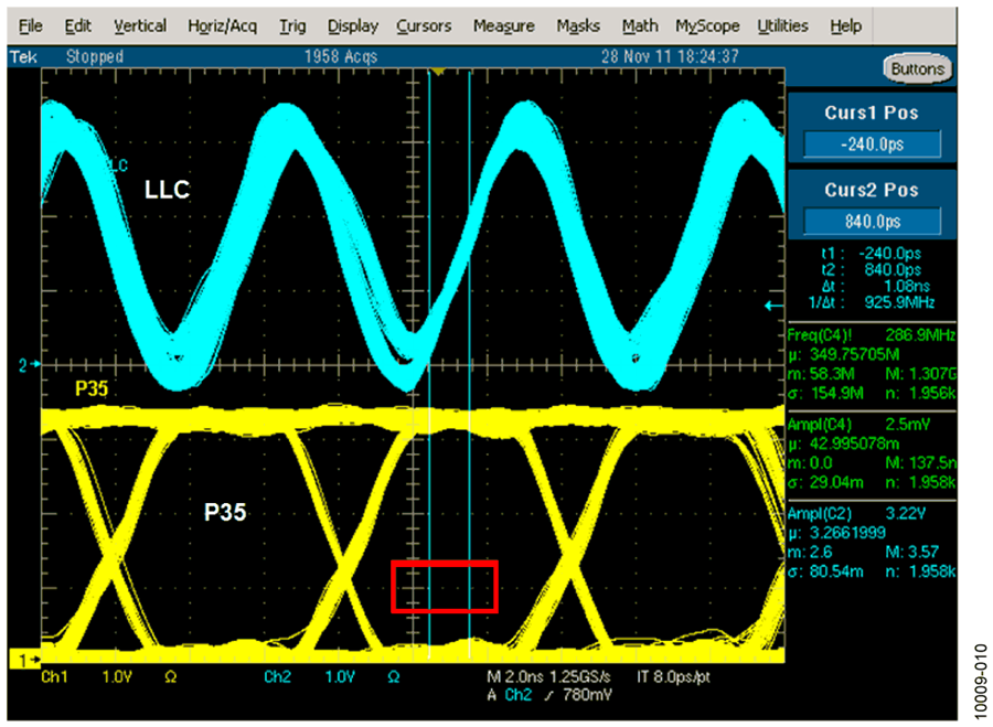

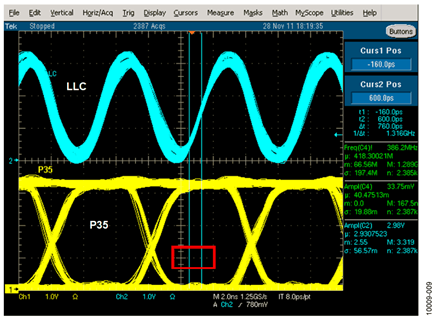

Figure 9. Oscilloscope screenshot. Drive signal from ADV7612-U43. Measure the LLC line (162 MHz) at the ADV7511 input and pixel line P35. The red rectangle shows the eyecup of the ADV7511. 2 × 150 Ω symmetrical termination on LLC and 51 Ω series resistor on data lines. Vertical scale: 1 V/div, horizontal scale: 2 ns/div
Figure 10. Oscilloscope screenshot. Drive signal from ADV7612-U1. Measure the LLC line (162 MHz) at the ADV7511 input and pixel line P35. The red rectangle shows the eyecup of the ADV7511. 2 × 150Ω symmetrical termination on LLC and 51Ω series resistor on data lines. Vertical scale: 1 V/div, horizontal scale: 2 ns/div
Layout considerations
The layout should consist of very short traces. Ideally, the trace connecting two pins of the same function between two ADV7612s should be as short as possible and should share the same series termination resistor, which is placed as close as possible to both devices and then connected to the bus. In practice, this requirement is impossible to meet due to layout constraints; therefore each device requires its own series termination resistor (see Figure 2). Video traces should be as close to the same length as possible to provide delay matching.

This circuit was evaluated using two video generators (Quantum Data 882) to generate UXGA 1600 × 1200 pixel, 30-bit and 1080p60, 36-bit video (Samsung2 and MoirèX patterns). Use Astro VA-1831 video analyzer as HDMI receiver (output from ADV7511). Additionally, connect the P6243 (1 pF, 1 MΩ, 1 GHz) probe to the Tektronix TDS5104B oscilloscope and observe the ADV7612 video signal (LLC and P35) on the ADV7511 pin. The resulting waveforms are represented as eye diagrams using the ADV7511 eye mask. Figures 9 and 10 show UXGA video of the Samsung2 pattern (162 MHz, 30 bits). The MoirèX pattern used during testing also showed similar safety margins.

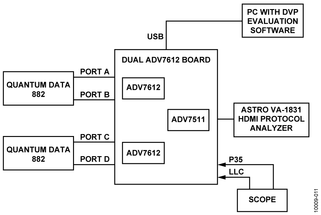

Figure 11. Test setup
Measuring video timing via Astro VA-1831 shows no anomalies. Analysis of MoirèX's even and odd vertical lines (1080p60 36-bit and UXGA 30-bit) shows that all bits are switched correctly at the same time without any leakage between lines (MoirèX pattern). The Astro VA-183 also showed stable HDMI sync signals and packets with correct CRC checksums. This shows that the backend ADV7511 correctly receives the clock and synchronization information.
Test steps
  • Prepare the test configuration as shown in Figure 11.
  • Power up the evaluation board and measurement equipment; start the DVP evaluation software.
  • In the DVP evaluation software, load the ADV7612 evaluation board.

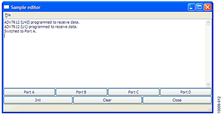

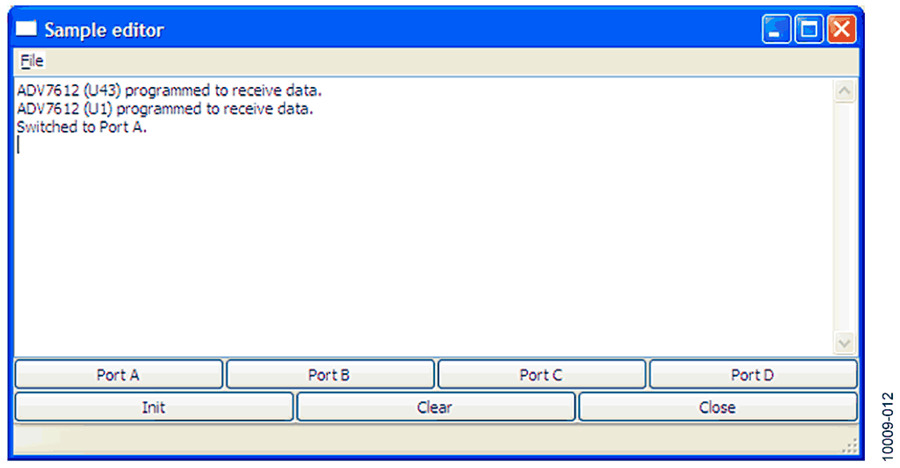

  • Run the INIT_PARTS_AND_SET_PORT_A_ver4.py script in the DVP evaluation software (please refer to the design resources).
  • Press the initialization button. After the evaluation board has initialized, click one of the following buttons: Port A, Port B, Port C, or Port D to select the desired input (see Figure 12).
Figure 12. Software for selecting HDMI input
