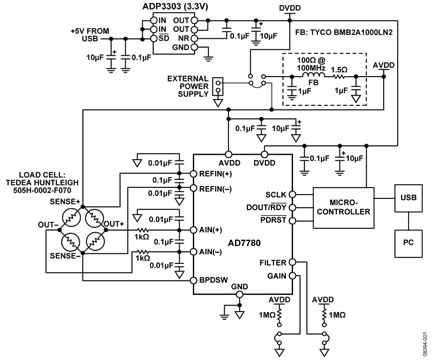

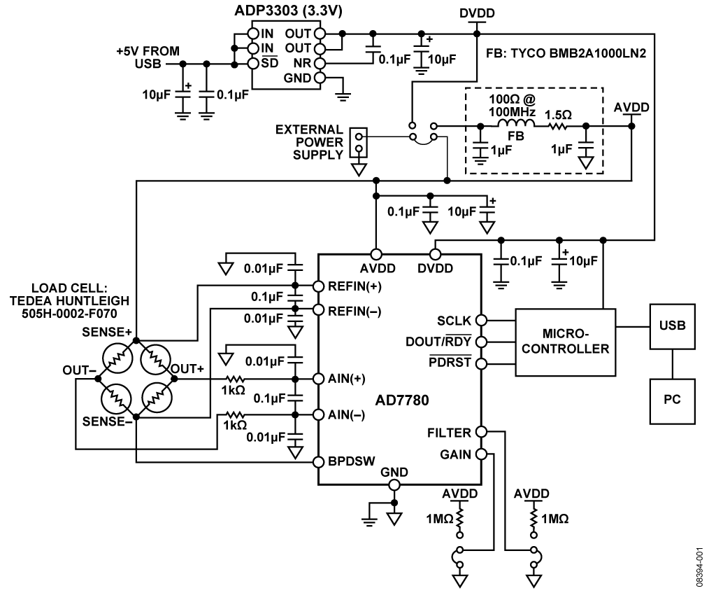

Figure 1. Electronic scale system using AD7780 (schematic diagram: all connections not shown)

The AD7780 provides an integrated scale solution that interfaces directly with load cells. Simply use some filters on the analog inputs and configure some external components such as capacitors on the reference voltage pin to meet electromagnetic shielding (EMC) requirements. The low-level signal from the load cell is amplified by the AD7780's built-in PGA. The PGA is programmed to operate at a gain of 128. The conversion results of the AD7780 are sent to the PC through the USB interface, and the PC converts the digital information into weight.

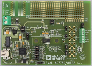

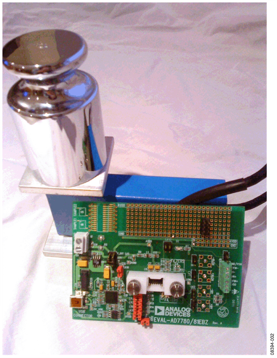

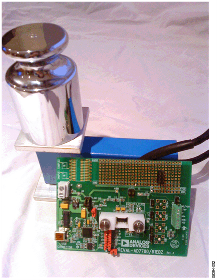

Figure 2 shows the actual test setup. For optimal system performance, this test setup uses a 6-wire load cell. In addition to the excitation, ground and 2 output connections, the 6-wire load cell has 2 sense pins. These sense pins are connected to the high and low sides of the Wheatstone bridge respectively. Therefore, the voltage developed across the bridge can be accurately measured despite the voltage drop caused by the line resistance. In addition, the AD7780 has a differential analog input that accepts a differential reference voltage. The load cell differential SENSE line is connected to the AD7780 reference voltage input to form a ratiometric configuration that is not affected by low-frequency changes in the power supply excitation voltage.
Figure 2. Electronic scale system setup using AD7780
If a 4-wire load cell is used, there is no sense pin and the ADC reference voltage pin will be connected to the excitation voltage and ground. In this configuration, there will be a voltage drop between the excitation voltage and SENSE+ due to the line resistance, so the system is not fully ratiometric. In addition, there will also be a voltage drop caused by line resistance on the low end.
The AD7780 has separate analog power supply pins and digital power supply pins. The analog and digital power supplies are independent of each other, so AVDD and DVDD can be at different potentials. The microcontroller runs on 3.3 V power supply. Therefore, DVDD is also powered by 3.3 V power supply. This eliminates the need for external level translation, simplifying the interface between the ADC and microcontroller. The 3.3 V digital supply can be generated using the ADP3303 voltage regulator.
There are several ways to power the scale system, such as using the main power bus, or using the ADP3303 (3.3 V). When energizing the scale with 5 V, the main power bus must be used. When stimulating the load cell with 3.3 V, you can use the main power bus or the ADP3303 (3.3 V). The ADP3303 (3.3 V) is a low noise voltage regulator. Additionally, noise reduction capacitors are provided at the regulator output as recommended in the ADP3303 (3.3 V) data sheet. To optimize electromagnetic shielding, the regulator output is filtered before powering the AD7780 and load cell. Since any noise on the power supply or ground plane will introduce noise into the system and degrade circuit performance, a low-noise regulator must be used to generate the power supply to the AD7780 and the load cell.

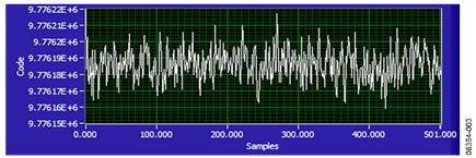

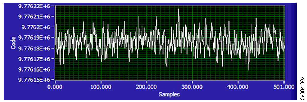

In actual operation, the load cell itself will introduce a certain amount of noise. The drift of the AD7780 will also cause certain time and temperature drift in the load cell. To determine the accuracy of the complete system, the scale can be connected to a PC via a USB connector and LabView software can be used to evaluate the performance of the scale system. Figure 3 shows the measured output performance (using a 5 V excitation voltage) by placing a 1 kg weight on the load cell and collecting 500 conversions. System noise calculated by the software is 50 nV (rms), which is equivalent to 30,300 noise-free samples or 14.9 bits of noise-free code resolution.
Figure 3. Output code measured with 500 samples, showing the impact of noise

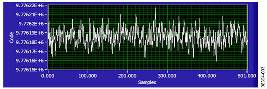

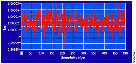

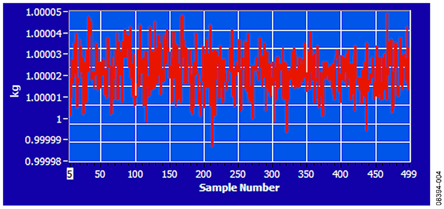

Figure 4 shows the performance in terms of weight. Relative to 500 codes, the peak-to-peak variation of the output is 0.075 grams. Therefore, the accuracy of this electronic scale system reaches 0.075 grams.
Shown above is the actual (raw) conversion result read back from the AD7780 after connecting the load cell. In actual operation, electronic scale systems will use digital post-filters.
Figure 4. Measured output (in kilograms) over 500 samples, illustrating the impact of noise.
Performing additional averaging in the post-filter further increases the number of samples, but at a reduced data rate.
