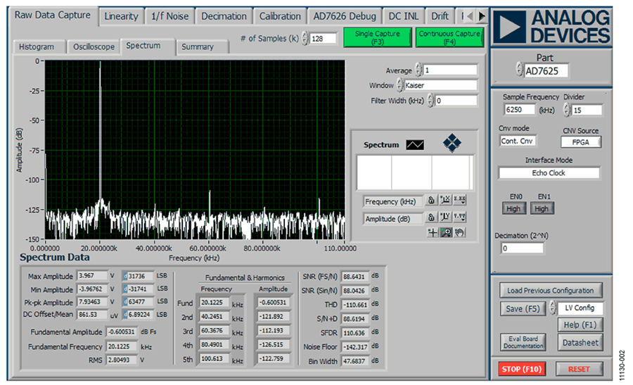

Figure 2 shows the ac performance of the circuit using +7 V and −2 V supplies for the input stage. SNR = 88.6 dB, THD = −110.7 dB, 20 kHz input signal is 0.6 dB below full scale (93% full scale).
Figure 2. AD7625 and ADA4897-1 powered by dual supplies (+7 V, −2 V), SNR = 88.6 dB, THD = −110.7 dB,
fundamental amplitude = −0.6 dB full scale

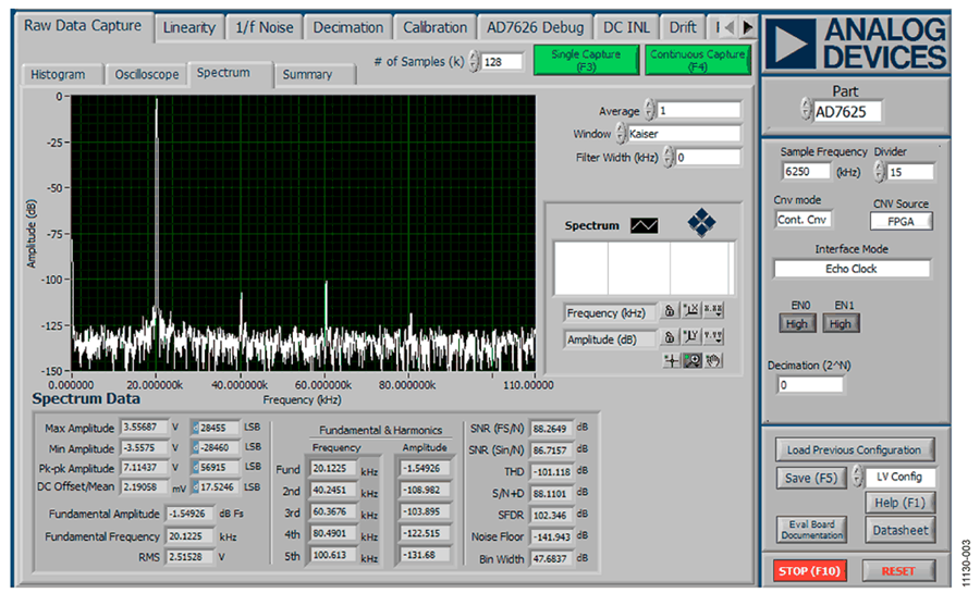

Figure 3. AD7625 and ADA4897-1 operating from a single supply (5 V), SNR = 86.7 dB, THD = -101.1 dB, fundamental amplitude = −1.55 dB full scale
Figure 3 shows the AC performance of the circuit using a single 5 V supply for the input stage. SNR = 86.7dB, THD = -101.1 dB, 20 kHz input signal is 1.55 dB below full scale (84% full scale).
When the supply voltage is reduced from −2 V, +7 V to 0 V, +5V, the data shows that the SNR is reduced by approximately 1.9 dB and the THD is reduced by approximately 9.6 dB.
The single power supply configuration is suitable for users whose system does not have dual power supplies but still needs high performance.
