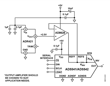

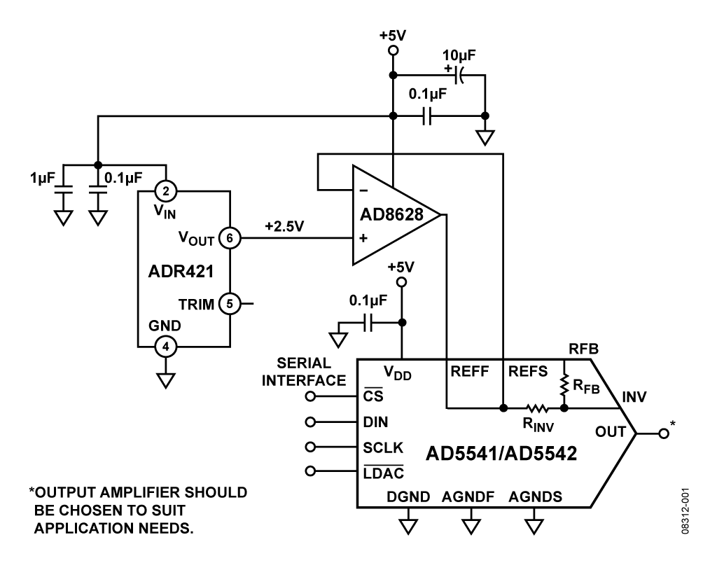

This circuit utilizes the AD5542 voltage output DAC , the ADR421BRZ voltage reference , and the AD8628 auto-zero op amp used as a reference buffer to achieve precision data conversion. The AD8628 reference voltage buffer provides feature advantages previously only available in expensive auto-zero or chopper-stabilized amplifiers. These zero-drift amplifiers use Analog Devices' circuit topology to combine low cost with high accuracy and low noise. No external capacitors are required, and the digital switching noise associated with most chopper-stabilized amplifiers is greatly reduced, making this amplifier an excellent choice for reference buffering.
This circuit can achieve precision, low power consumption, voltage output digital-to-analog conversion. AD5542 has two operating modes: buffered mode and non-buffered mode. Which operating mode is best depends on the specific application and its settling time, input impedance, noise, etc. requirements. The output buffer amplifier can be selected based on DC accuracy or fast settling time requirements. If the DAC is required to drive loads below 60 kΩ, output buffering is required. The output impedance of the DAC is constant and independent of the digital code, but to minimize gain error, the input impedance of the output amplifier should be as high as possible. The output amplifier should also have a 3 dB bandwidth of 1 MHz or higher. The output amplifier adds another time constant to the system, thus extending the settling time of the final output.
The higher the amplifier's 3 dB bandwidth, the faster the effective settling time of the DAC and amplifier combination. All components in the circuit can operate from a single +5 V supply. The input voltage range of the ADR421 reference is 4.5 V to 18 V.
Figure 1: Precision DAC configuration (schematic diagram)
Circuit description
This circuit uses the AD5542 voltage output DAC, which provides 16-bit, high-precision performance. The DAC architecture of the AD5541 /AD5542 is a segmented R-2R voltage mode DAC. With this configuration, the output impedance is independent of the digital code, while the input impedance of the reference is highly dependent on the digital code. Therefore, the selection of the reference voltage buffer is very important for the handling of code-dependent reference current. If the DAC reference voltage buffer is insufficient, linearity errors may result. When selecting a reference buffer for use with a precision voltage output DAC, the op amp's offset voltage, offset error temperature coefficient, and noise are important selection criteria. Offset errors in the reference circuit can cause gain errors at the DAC output. This circuit uses the AD8628, a zero-drift, single-supply, rail-to-rail input/output op amp, which has an offset voltage of 1 μV, a drift of less than 0.005 μV/°C, and a noise of 0.5 μV peak-to-peak (0.1 Hz to 10 Hz), making it suitable Applications where error sources need to be minimized. The output voltage is related to the reference voltage as shown in the following equation:

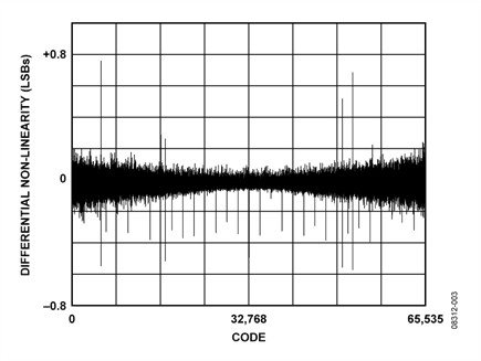

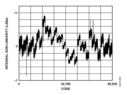

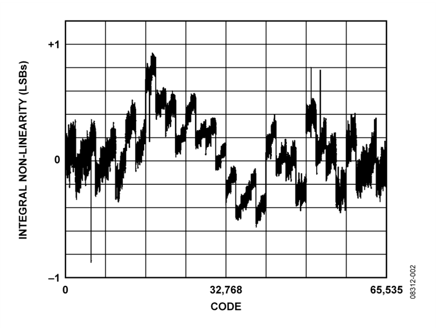

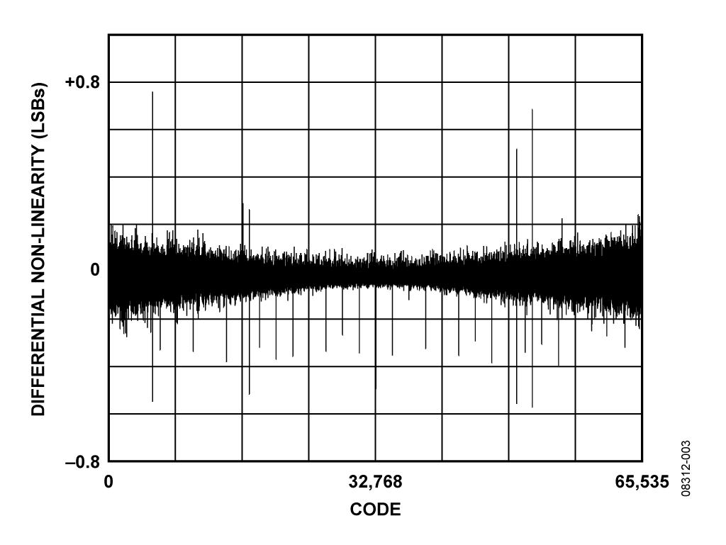

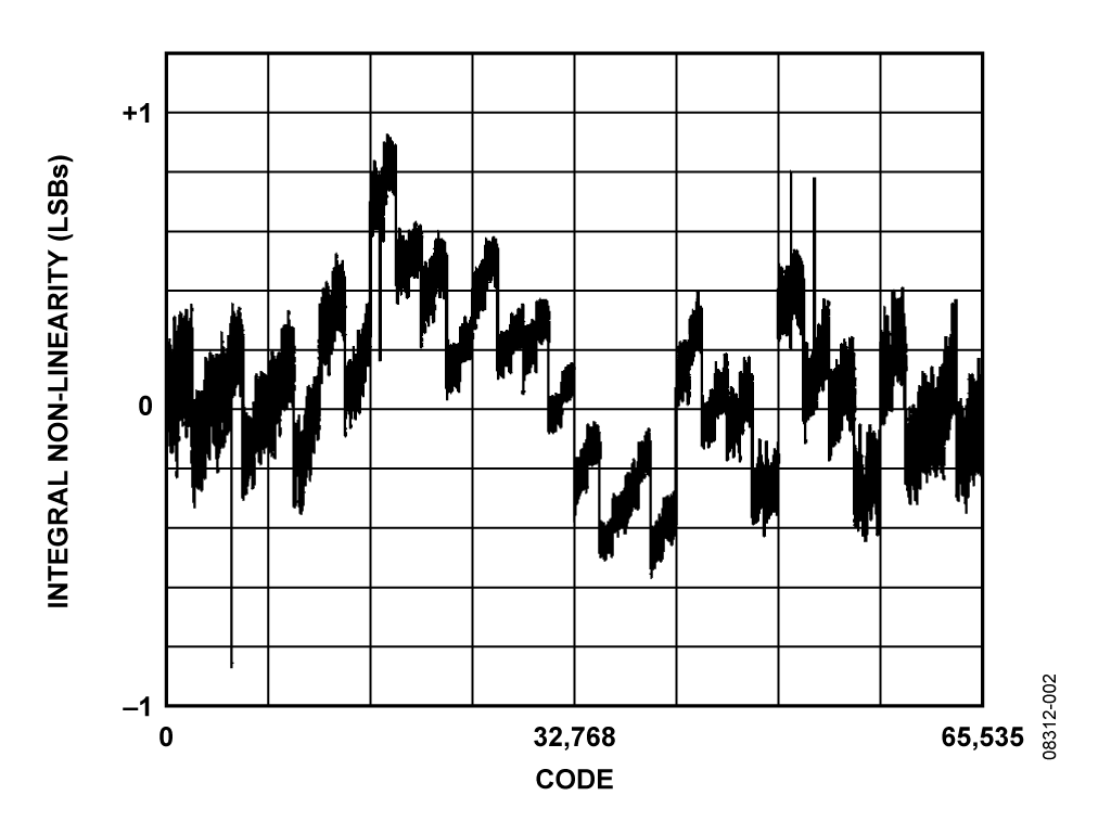

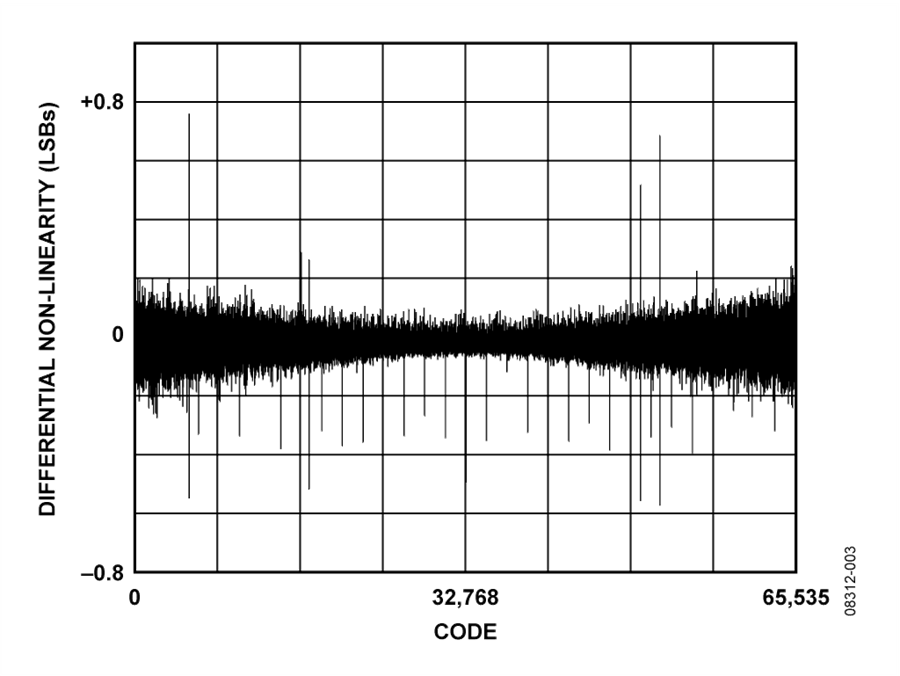

Integral nonlinearity (INL) error refers to the deviation of the actual DAC transfer function from the ideal transfer function, expressed in LSB. Differential nonlinearity (DNL) error is the difference between the actual step size and the ideal value of 1 LSB. The circuit shown in Figure 1 has an INL error of ±1 LSB and a DNL error of ±1 LSB at 16-bit resolution. Figures 2 and 3 show the INL and DNL performance of this circuit.
Figure 2: Relationship between integral nonlinear error and input code
Figure 3: Differential nonlinear error versus input code
The measured offset error and gain error are 10 μV and 170 μV respectively. The gain error of ±5 LSB and the zero-code error of ±1 LSB are within the specified error range of 38 μV (2.5 V reference, ambient temperature).

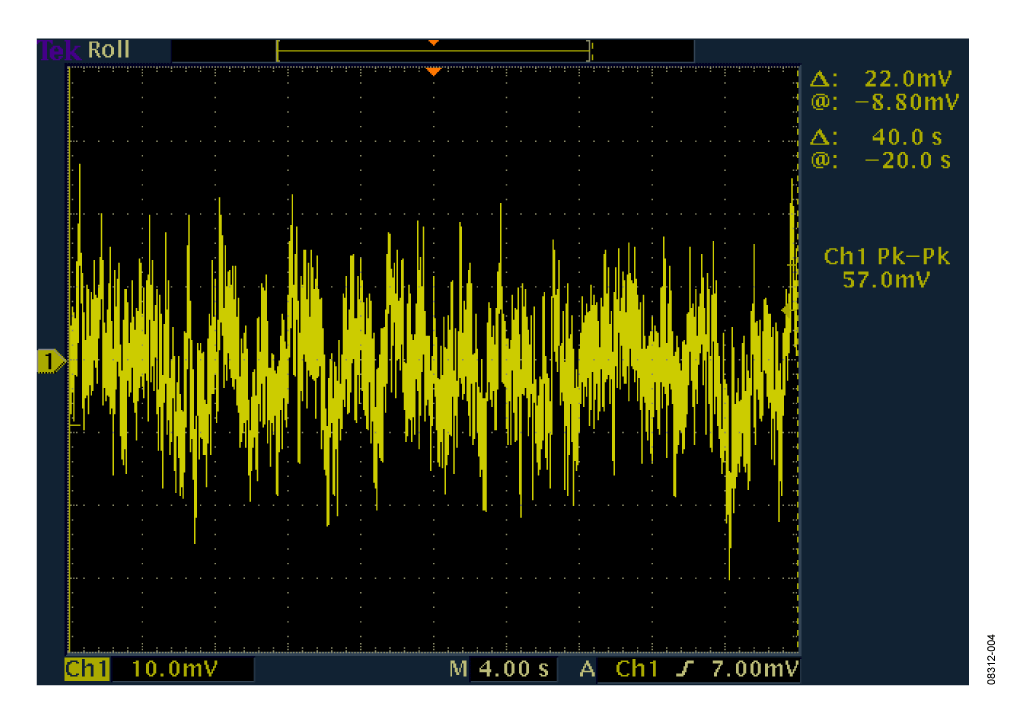

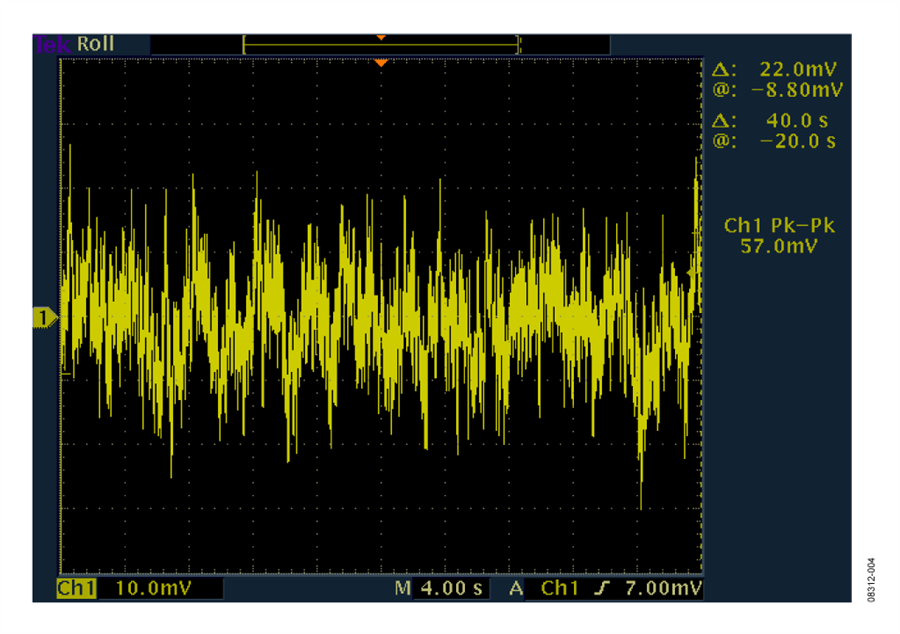

Figure 4 shows the 0.1 Hz to 10 Hz noise plot for this circuit. The output VOUT of the DAC is connected to the input of a 0.1 Hz to 10 Hz bandwidth filter followed by an amplifier with a gain of 10,000. Using an oscilloscope to capture the voltage noise, a very low peak-to-peak voltage of 57 mV (relative to the DAC output of 5.7 μV) was observed.
Figure 4: 0.1 Hz to 10 Hz output noise plot; full-scale code loaded into DAC (1/f noise = 57 mV/10,000 = 5.7 μV)

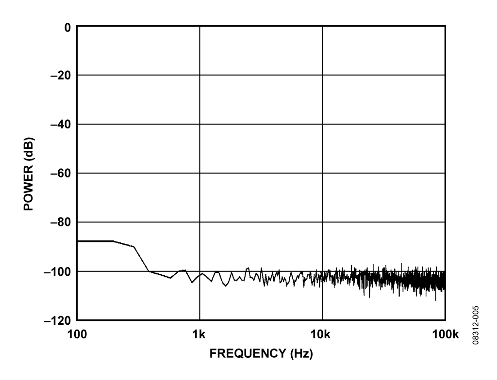

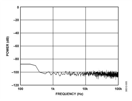

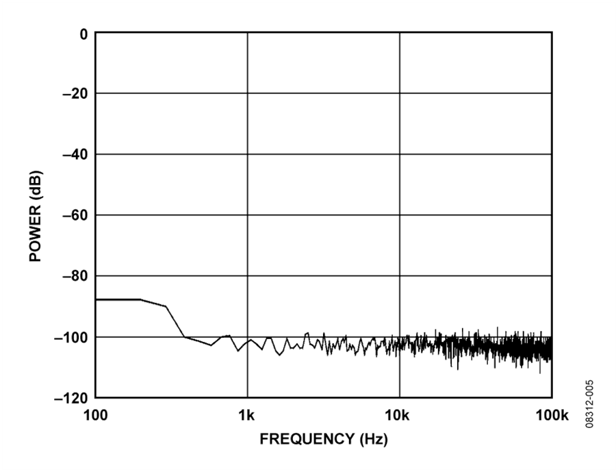

Figure 5 shows the DAC output obtained using a spectrum analyzer, swept from 100 Hz to 100 kHz. No significant intermodulation distortion (IMD) term was observed, indicating that an auto-zero amplifier such as the AD8628 is an excellent choice as a reference voltage buffer.
Figure 5: DAC output spectral density plot (dB converted to full scale)
