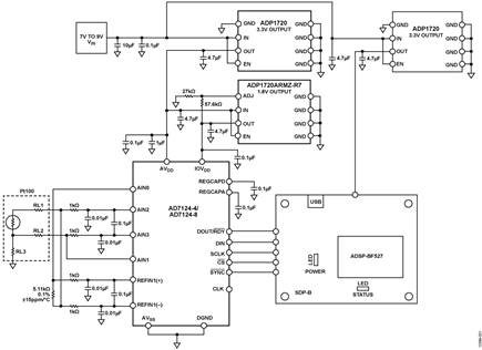

The circuit shown in Figure 1 is an integrated 3-wire resistance temperature detector (RTD) system based on the AD7124-4 / AD7124-8 low-power, low-noise, 24-bit Σ-Δ analog-to-digital converter (ADC). Optimized for high-precision measurement applications. Using two-point calibration and linearization, the overall accuracy of the 3-wire system is better than ±1°C over the temperature range of −50°C to +200°C. In full power mode, sinc4 filter selected, and output data rate of 50 SPS, the system
Figure 1. 3-wire RTD measurement configuration
The AD7124-4 can be configured for 4 differential or 7 pseudo-differential input channels, while the AD7124-8 can be configured for 8 differential or 15 pseudo-differential input channels. The on-chip programmable gain array (PGA) ensures that small signals can be input directly into the ADC.
The AD7124-4/AD7124-8 offer the highest level of signal chain integration and include programmable low-drift excitation current sources. Most of the building blocks required for an RTD measurement system are integrated on-chip, thus greatly simplifying RTD system design.
The AD7124-4/AD7124-8 allow the user the flexibility to use one of three integrated power modes, with current consumption, output data rate range, and rms noise corresponding to the selected power mode. In low power mode, the AD7124-4/AD7124-8 consumes only 255 μA and 930 μA in full power mode. These power options make the device suitable for both applications where power consumption is not critical, such as input/output modules, and low-power applications, such as loop-powered smart transmitters (the entire transmitter must consume less than 4 mA ).
The device also has a shutdown option. In shutdown mode, the entire ADC and its auxiliary functions are shut down, reducing typical power consumption of the device to 1 μA. The AD7124-4/AD7124-8 also integrate rich diagnostic capabilities as part of a comprehensive feature set.

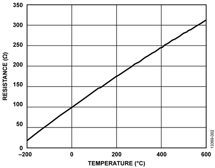

RTDs are commonly used sensors for temperature measurement in industrial applications. RTDs are made of pure metals such as platinum, nickel, or copper, and their resistance changes predictably with temperature. The most commonly used RTDs are platinum Pt100 and Pt1000. Compared with other types of temperature sensors, RTDs have high accuracy and good stability. The resistance of long wires can be compensated using a 3-wire connection.
To accurately measure resistance, a constant current source is used to generate a voltage across the RTD. The AD7124-4/AD7124-8 provide two of these excitation current sources, which are register programmable to values ​​from 50 μA to 1 mA. Errors in the current source can be easily eliminated by reducing the measured value to the voltage across a precision reference resistor (driven by the same current), resulting in a ratiometric measurement.
The circuit shown in Figure 1 uses a Class B Pt100 RTD sensor. The temperature measurement range of the Pt100 RTD is −200°C to +600°C. A Class B RTD has a typical resistance of 100 Ω at 0°C and a typical temperature coefficient of about 0.385 Ω/°C (see Figure 2). Using this information, it is easy to calculate the voltage developed across the Pt100 RTD based on the selected current source.
Figure 2. RTD Resistance vs. Temperature

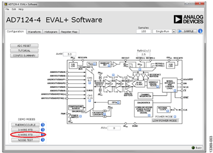

SPI communication with the AD7124-4/AD7124-8 is handled by the Blackfin® ADSP-BF527 on the EVAL-SDP-CB1Z board , as shown in Figure 1. To access the registers of the AD7124-4/AD7124-8, use the AD7124-4/AD7124-8 EVAL+ software . Figure 3 shows the main window of the software. Click the 3-WIRE RTD button to configure the software for 3-wire RTD measurements.
Figure 3. AD7124-4/AD7124-8 EVAL+ software configuration window

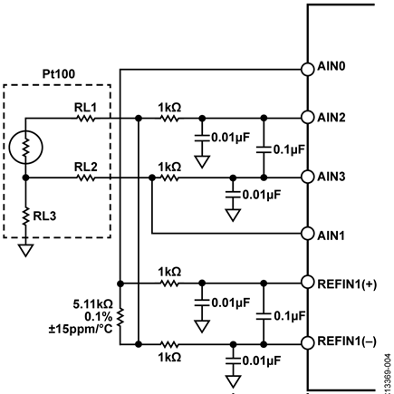

The circuit shown in Figure 1 implements 3-wire measurements using four analog pins: AIN0, AIN1, AIN2, and AIN3. AIN2 and AIN3 are configured as fully differential input channels for sensing the voltage on the Pt100. The excitation current source used to excite the RTD is generated by AV DD and flows to AIN0. An identical current flows to AIN1 and through the RL2 lead resistor, creating a voltage that cancels the voltage drop across the RL1 lead resistor. Figure 4 shows the analog pins and their configuration in detail.
Figure 4. Analog input for 3-wire RTD measurement
When the PGA is enabled, the analog input buffer is automatically enabled. The PGA allows voltages on the input pins as low as AV SS , therefore, no headroom resistors are required on the analog input pins. The reference buffer is also enabled. These buffers require headroom. The reference resistor is on the high side and its headroom requirements are met, so no other headroom resistors are needed. For the circuit shown in Figure 1, the reference input used is REFIN1(±). The current flowing through Pt100 will also flow through the precision reference resistor, generating a reference voltage. The voltage developed across this precision reference resistor is proportional to the voltage across the Pt100, so errors caused by fluctuations in the excitation current are eliminated.

3线RTD配置
图1所示电路使用AD7124-4/AD7124-8进行精密3线RTD测量。 3线RTD测量需要两个精密激励电流源,以便轻松消除RL1和RL2产生的引线电阻误差。 注意,RL3引线电阻不会影响测量精度。 对于图1所示3线RTD配置,基准电阻放在RTD的高端。 对于此设置,一个激励电流流经基准电阻和RTD;另一个电流流经引线电阻RL2,其产生的电压抵消RL1上的压降。 由于仅利用一个激励电流来产生基准电压REFIN1±和RTD上的电压,因此,该电流源的精度、失配和失配漂移对ADC传递函数的影响极小。
激励电流在Pt100 RTD上产生一个低电平电压。 此低电平电压由AD7124-4/AD7124-8的片上PGA放大,然后通过24位Σ-Δ ADC转换为精密数字信号。 对于此3线RTD配置,两个激励电流均设置为500 µA。 对于最高600℃的RTD温度,采用500 μA激励电流时,RTD上产生的电压约为156.85 mV。
为确保使用AD7124-4/AD7124-8的最大范围,PGA增益设置为16,其将RTD传感器最大输出电压放大到2.5096 V。 为确保此3线电路实现真正的比率式配置,ADC的基准电压利用外部精密电阻产生,所用的激励电流与Pt100情况相同。 使用这种配置意味着,激励电流值的任何波动都会反映在Pt100和基准电阻上,因而不会改变系统的精度。
使用500 µA激励电流和ADC的放大电压,基准电阻值为:
CN0383 Equation A
因此,选择5.11 kΩ电阻,其产生的基准电压为:
CN0383 Equation B
利用AD7124-4/AD7124-8进行3线RTD测量时,还必须考虑激励电流源的输出顺从电压。 输出顺从电压取决于所选的激励电流。 本电路选择500 μA,其输出顺从电压为AVDD− 0.37 V。 本电路的AVDD电源电压为3.3 V,因此,激励电流源的输出顺从电压必须低于2.93 V。 从上述计算可知,电路满足这一要求,因为AIN0引脚的最大电压等于精密基准电阻上的电压加上RTD上的电压:
CN0383 Equation C
针对3线RTD测量的AD7124-4/AD7124-8配置如下:
  • 差分输入: AINP = AIN2,AINM = AIN3
  • 激励电流: IOUT0 = AIN0 = 500 μA
  • 激励电流: IOUT1 = AIN1 = 500 μA
  • 增益= 16
  • 5.11 kΩ 精密基准电阻
  • 数字滤波(sinc4和后置滤波器)

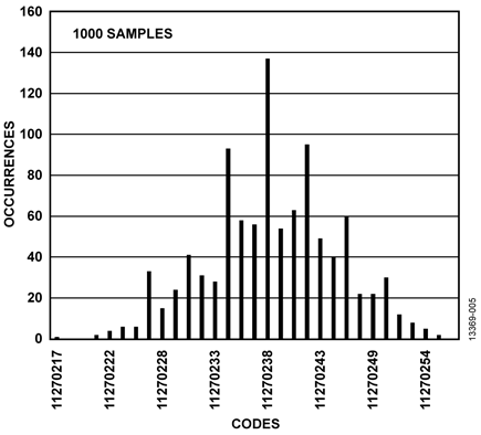

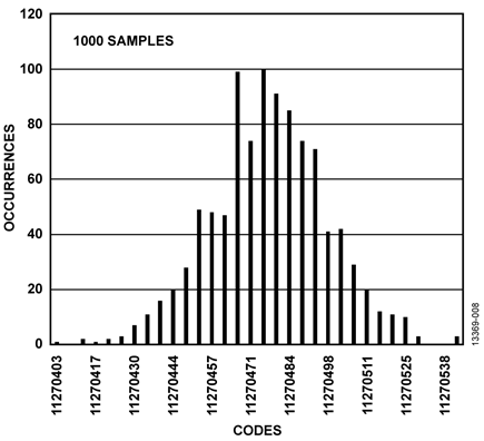

The AD7124-4/AD7124-8 operate with optimal speed and noise performance when the sinc 4 filter, full power mode, and 50 SPS output data rate configurations are selected. Figure 5 shows the noise distribution at room temperature for a 3-wire RTD when connected as shown in Figure 1. The corresponding root mean square noise is typically 199.37 nV rms, which is equivalent to approximately 17.9 bits of noise-free resolution. Selecting the same filter, gain, and output data rate, but with the input shorted, the noise performance of the AD7124-4/AD7124-8 is typically 100 nV rms, equivalent to 18.7 bits of noise-free resolution. The increase in noise comes directly from the RTDs connected on the input channels (AIN2, AIN3).
Figure 5. RTD code histogram at room temperature, Sinc 4 filter, full power mode, 50 SPS

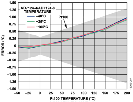

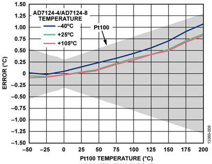

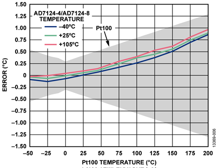

For a 3-wire RTD configuration with sinc 4 filter and full power mode selected, the RTD temperature is swept from −50°C to +200°C. For each temperature, measure the corresponding voltage on the RTD using the AD7124-4/AD7124-8 as described above. This voltage is then converted to resistance, linearized and converted to temperature as described in the "3-Wire RTD Configuration" section. Figure 6 shows the error between the set temperature and the RTD measured system temperature after linearization. The AD7124-4/AD7124-8 maintain 25°C for each RTD temperature setting. As shown in Figure 6, the error of the RTD's measured temperature is within the error window of the Pt100 Class B RTD. Figure 6 also shows the deviation of the RTD error at different AD7124-4/AD7124-8 temperature settings. For each temperature setting of the AD7124-4/AD7124-8, internal zero-scale calibration and full-scale calibration are performed. As shown in Figure 6, the RTD error is within the expected error range for a Class B RTD for all temperature settings of the AD7124-4/AD7124-8.
Figure 6. Temperature accuracy measurement (Sinc 4 filter, full power mode, 50 SPS)
Figure 7 shows the measured temperature error of the RTD after performing a one-time internal zero-scale and full-scale calibration at 25°C. This graph shows that the AD7124-4/AD7124-8 exhibit similar performance when performing a one-time calibration at 25°C versus performing calibration at various temperature settings.

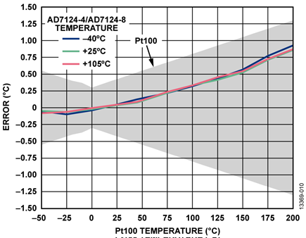

For the AD7124-4/AD7124-8 configuration with post filter and low power mode selected, the RTD temperature is swept from −50°C to +200°C. For each set RTD temperature, measure the corresponding voltage on the RTD using the AD7124-4/AD7124-8 as described above. This voltage is then converted to resistance, linearized and converted to temperature as described in the "3-Wire RTD Configuration" section. Figure 9 shows the error between the set temperature and the RTD measured temperature after linearization. The AD7124-4/AD7124-8 maintain 25°C for each RTD temperature setting. As shown in Figure 9, the error of the RTD's measured temperature is within the error window of the Pt100 Class B RTD. Figure 9 also shows the deviation of the RTD error at different AD7124-4/AD7124-8 temperature settings. For each temperature setting of the AD7124-4/AD7124-8, internal zero-scale calibration and full-scale calibration are performed. Figure 9 shows that the RTD error is within the expected error range for a Class B RTD for all temperature settings of the AD7124-4/AD7124-8.
Figure 9. Temperature accuracy measurement (post filter, low power mode, 25 SPS)
Figure 10 shows the measured temperature error of the RTD after performing a one-time internal zero-scale and full-scale calibration at 25°C. This graph shows that the AD7124-4/AD7124-8 exhibit similar performance when performing a one-time calibration at 25°C versus performing calibration at various temperature settings.
Figure 10. Temperature accuracy measurement (post filter, low power mode, 25 SPS, only one-time calibration at 25°C is performed)
