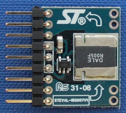

High-end current sense amplifier demonstration board based on TSC101
STEVAL-ISQ007V1
This demonstration board is specifically designed for the TSC101 integrated circuit.
The TSC101 measures a very small voltage drop on a high-side shunt resistor, and, using an internally fixed gain, amplifies the difference into a ground-referenced output voltage; the amplification gain is internally fixed.
Input common-mode and power supply voltages are independent.
The common-mode voltage can range from 2.8 V to 30 V in operating conditions, and up to 60 V in absolute maximum ratings.
The supply voltage can range from 4 V to 24 V.
Current consumption of less than 300 μA over the temperature range and low input bias current (less than 8 μA in standard conditions, a few 100 nA if VCC isn't supplied) are particularly interesting to save power in the application.
Main features
  • Buffered output
  • Internally fixed gain:20 V/V (TSC101A)50 V/V (TSC101B)100 V/V (TSC101C)
  • Independent supply and input common-mode voltages
  • Wide common-mode surviving range: -0.3 V to 60 V (load-dump)
  • Wide common-mode operating range: 2.8 V to 30 V
  • Low current consumption: ICC max is 300 μA
  • Wide supply voltage range: 4 V to 24 V
