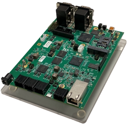

Evaluation kit for SPC58 gateway (with Telemaco3P ASIL-B processor)
SGP-TC-EVK
The SGP-TC-EVK (Smart Gateway Platform) evaluation kit provides an easy-to-use development and prototyping platform for advanced automotive gateway and domain controller applications.
Designed around ST’s secure automotive system on chips, a SPC58NHx microcontroller and a STA1385 microprocessor, the SGP offers high levels of processing and security capabilities, as well as real-time network performances required for use cases such as OTA management, ethernet packet inspection, fast wake-up response, secure data routing CAN-to-CAN and CAN-to-Ethernet, low-power Body Control Management, intrusion detection and predictive maintenance.
Featuring a rich set of in-vehicle network interfaces, the platform offers a complete environment for prototyping various automotive gateway and domain controller use cases; additionally, onboard M.2 and Mini PCIe expansion connectors for Wi-Fi and LTE modules bring cloud connectivity convenience.
The SGP-TC-EVK is delivered with a comprehensive Starter Package which includes everything required for the users to get started quickly, e.g., hardware design files, hardware/software documentation, software utilities and sample application software.
