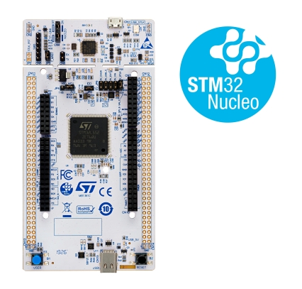

STM32 Nucleo-144 development board for STM32L552ZE MCU, SMPS, supports Arduino, ST Zio and morpho connections
NUCLEO-L552ZE-Q
STM32 Nucleo-144板为用户提供了一种可负担的灵活方法,通过选择STM32微控制器提供的各种性能和功耗特性组合来尝试新概念并构建原型。对于兼容板,内部或外部SMPS可显著降低运行模式下的功耗。
ST Zio connectors expand the connectivity capabilities of ARDUINO® Uno V3, while ST morpho connectors provide an easy way to extend the capabilities of the Nucleo open development platform and are available in a variety of specialized shields.
Thanks to the integrated ST-LINK debugger/programmer, the STM32 Nucleo-144 board does not require a separate probe.
The STM32 Nucleo-144 board comes with the STM32 comprehensive free software library and STM32Cube MCU software package examples.
Main features
  • Common characteristics
    • STM32 microcontroller in LQFP144 package
    • 3 user LEDs
    • 2 user buttons and reset button
    • 32.768 kHz crystal oscillator
    • Board connector:SWDST Zio expansion connectors including ARDUINO® Uno V3ST morpho expansion connector
    • Flexible power supply options: ST-LINK, USB V BUS or external power supply
    • On-board ST-LINK debugger/programmer with USB re-enumeration: mass memory, virtual COM port and debug port
    • Comprehensive free software libraries and routines are provided, available from the STM32Cube MCU software package
    • Supports multiple integrated development environments (IDEs), including IAR™, Keil® , and STM32CubeIDE
  • Specific board features
    • External or internal SMPS generates V core logic supply
    • Ethernet compliant with IEEE-802.3-2002 specification
    • USB OTG full speed or device only
    • Board connector:USB with Micro-AB or USB Type-C™Ethernet RJ45
    • Compatible with Arm® Mbed Enabled™
