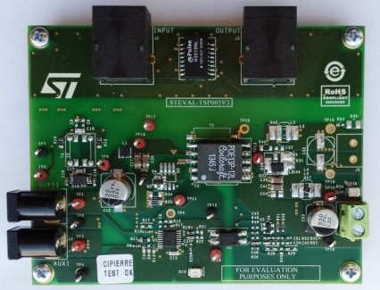

IEEE 802.3af compliant, Power over Ethernet PD converter with 12V, 1A output
STEVAL-TSP003V2
This document focuses on a reference design for a simple, low cost 12 V 1 A flyback converter based on the PM8800A device.
The PM8800A is a highly integrated device embedding an IEEE 802.3af compliant “Powered Device” (PD) interface together with a PWM controller.
It can be successfully used in all low power, low cost PoE applications.
Main features
  • IEEE 802.3af compliant PD interface
  • Works with power supplied from Ethernet LAN cables or from local auxiliary sources
  • Line input voltage range: 40 Vdc to 60 Vdc Output voltage: 12 Vdc ± 5%
  • Output current: 1 A
  • Peak-to-peak output ripple: 100 mV
  • Efficiency DC-DC full-load: > 88%
  • Efficiency overall peak: > 85%
  • Transient response ΔVoutpk-pkto 50% load step:
  • ΔV in load line case:
