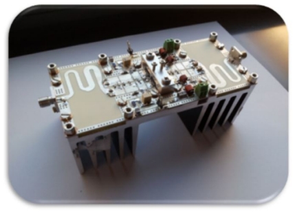

STEVAL-TDR032V1
The STEVAL-TDR032V1 demonstration board is designed for mobile radio applications. It uses two PD85050S LDMOS transistors.
The demonstration board is a push-pull class AB power amplifier which uses a lumped L-C input/output network type on balanced microstrip lines.
A proper planar balun embedded on the PCB (patent pending) allows the management of balanced versus unbalanced input/output signals.
For additional information regarding the PD85050S please refer to the device datasheet.
Main features
  • Excellent thermal stability
  • Frequency: 760-870 MHz
  • Supply voltage: 12.5 V
  • Output power: 60 W
  • Gain: 10 dB min
  • Efficiency: 50% typical
  • Stability: load VSWR3:1 minimum
  • BeO free amplifier
  • RoHS compliant
