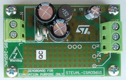

Viper06-based non-isolated switch-mode power supply (SMPS) using buck-boost topology demo version
STEVAL-ISA096V1
The STEVAL-ISA096V1 is a switched mode power supply (SMPS) demonstration board. This non-isolated SMPS is designed in a buck-boost topology and is capable of delivering up to 2 W of output over a wide input voltage range.
This board also offers the user the possibility of adapting the circuit to specific needs, thanks to an available free PCB area.
The SMPS generates 12 V of nominal output voltage.
The STEVAL-ISA096V1 demonstration board is based on the VIPer06, a monolithic converter that integrates an 800 V avalanche-rugged MOSFET and PWM controller in one package, offering a cost-effective and space-saving solution.
Main features
  • Input voltage: Vin: 85 ~ 264 Vrms; f: 45 ~ 66 Hz
  • Output voltage: -12 Vdc ± 10%, 150 mA
  • Standby
  • Short-circuit: protected
  • PCB type and size: FR4 single-side 35 μm, 32 x 90 mm
  • Isolation: isolated 4 kV/8 mm
  • EMI: according to EN55022 class B
  • RoHS compliant
