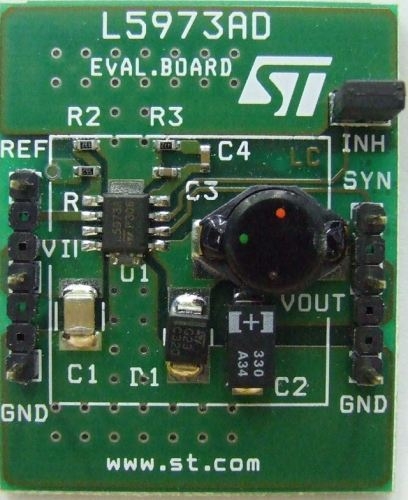

1.5A step-down switching regulator based on L5973AD
STEVAL-ISA106V1
The STEVAL-ISA106V1 demonstration board provides a platform for evaluation of the L5973AD, a step-down monolithic power switching regulator capable of delivering up to 1.5 A of current at output voltages from 1.2 V to 35 V.
The input supply voltage of the STEVAL-ISA106V1 can range from 4 V to 36 V based on the rated voltage of the input capacitor, while the output voltage is adjustable from 1.235 V to VCC.
Main features
  • Max. output current Iout = 1.5 A
  • Output voltages from 1.235 V to 35 V
  • Operating input voltage ranges from 4 V to 36 V
  • Internal switching frequency: 500 kHz
  • Synchronization pin
  • Short-circuit protection
  • Inhibit pin
  • Thermal shutdown
  • RoHS compliant
