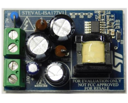

VIPer01 - 5V, 0.85A flyback converter using VIPer™Plus
STEVAL-ISA177V1
The STEVAL-ISA177V1 evaluation board implements a wide-range converter in flyback non isolated topology, delivering 0.85 A on a 5 V output for general purpose applications.
The core of the application is the new VIPer01 offline high voltage converter from the VIPerPlus range that intelligently integrates an 800 V rugged power MOSFET with PWM current-mode control.
The main characteristics of the evaluation board are its single layer, small size with minimal BOM, high efficiency and low standby consumption.
Main features
  • Universal AC main input voltage range: 85VAC to 265VAC
  • Output range: 5 V / 0.85 A
  • Rated output power: 4.25 W
  • Input power in standby @ 230 VAC:
  • Active mode efficiency: > 74%
  • EMI: according to EN55022-Class-B
  • RoHS compliant
