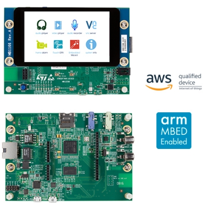

The STM32F7 discovery kit allows users to develop and share applications with the STM32F7 Series microcontrollers based on the ARM®Cortex®-M7 core.
The discovery kit enables a wide diversity of applications taking benefit from audio, multi- sensor support, graphics, security, video and high-speed connectivity features.
The Arduinoconnectivity support provides unlimited expansion capabilities with a large choice of specialized add-on boards.
Main features
  • STM32F769NIH6 microcontroller featuring 2 Mbytes of Flash memory and 512+16+4 Kbytes of RAM, in BGA216 package
  • On-board ST-LINK/V2-1 supporting USB reenumeration capability
  • USB ST-LINK functions: virtual COM port, mass storage, debug port
  • 4" capacitive touch LCD display with MIPI® DSI connector (on STM32F769I-DISCO only)
  • SAI audio codec
  • Two audio line jacks, one for input and one for output
  • Stereo speaker outputs
  • Four ST MEMS microphones on DFSDM inputs
  • Two SPDIF RCA input and output connectors
  • Two push-buttons (user and reset)
  • 512-Mbit Quad-SPI Flash memory
  • 128-Mbit SDRAM
  • Connector for microSD card
  • Wi-Fi or Ext-EEP daughterboard connector
  • USB OTG HS with Micro-AB connector
  • Ethernet connector compliant with IEEE-802.3-2002
  • Five power supply options:
    • ST LINK/V2-1
    • USB HS connector
    • 5 V from RJ45 (Power Over Ethernet)
    • 5 V from Arduinoor external connector
    • USB charger
  • Power Over Ethernet based on IEEE 802.3af (Powered Device, 48 V to 5 V, 3 W)
  • Power supply output for external applications: 3.3 V or 5 V
  • ArduinoUno V3 connectors
  • Comprehensive free software including a variety of examples, part of the STM32Cube package
  • Supported by a wide choice of integrated development environments
