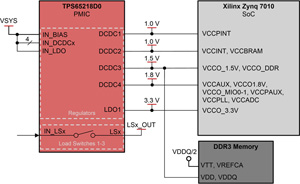

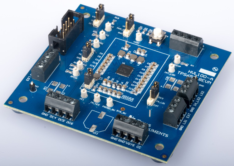

This TPS65218-based reference design is a compact integrated power solution for the Xilinx® Zynq® 7010 SoC/FPGA (part of the Zynq® 7000 product family). This design shows the TPS65218 as an all-in-one PMIC used to provide the five power rails required to power the Zynq® 7010 SoC/FPGA. The TPS65218, including passive components, requires only 1.594 in 2 of total board area to provide five power rails to the Zynq® 7010 . TPS65218 has the flexibility to support DDR3L or DDR3 memory. This power management IC can be powered from a single 5V supply or a single Li-ion battery. This design is guaranteed to operate over the entire industrial temperature range (-40°C to 105°C).
characteristic
  • ● Provides 5 power rails to power the Zynq® 7010 in a compact 1.594 square inches including passive components.
  • ● TPS65218 provides 4 high-efficiency DC-DC converters with integrated FETs and 1 adjustable general-purpose LDO
  • ● Includes integrated programmable sequencer for flexible power-up sequencing
  • ● If necessary, the on-chip GPIO can be programmed to sequence power to other discrete components
  • ● Suitable for industrial applications (-40°C to 105°C)
  • ● This design includes test reports, EVM guides and design documents to help speed up the evaluation process
