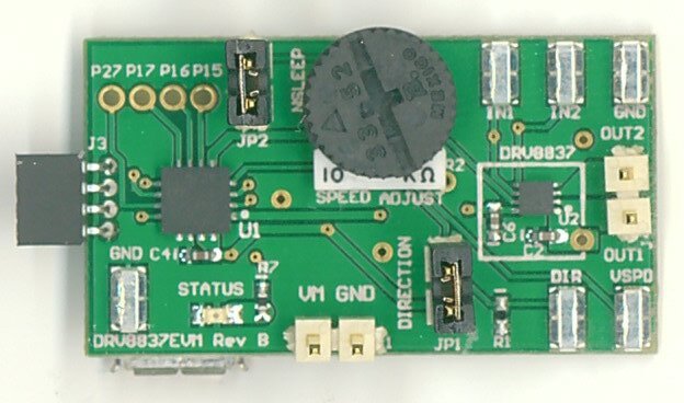

This brushed motor system uses an MSP430 microcontroller, a DRV8837 brushed DC motor driver, and a 12V brushed motor. This system is suitable for applications requiring speeds up to 10,300 RPM under no load conditions. The system measures 19 x 33 mm without motor, making it ideal for applications requiring a small footprint. The motor power supply voltage supports 1.8V to 11V, and the maximum current is 1.8A. There are various configuration options for easily controlling the rotation of the motor, changing the direction of rotation, and placing the system into a low-power state to reduce energy consumption when not in use. The motor drive platform incorporates protection against short circuit, breakdown, undervoltage and overheating.
characteristic
  • ● 19x33 mm compact system design
  • ● Integrated power FET supports 1.8V to 11V and 1.8A
  • ● Motor speed can be easily controlled by PWM (IN/IN) input interface
  • ● Low MOSFET on-resistance 280 mΩ
  • ●Integrated protection measures against short circuit, breakdown, undervoltage and overheating
