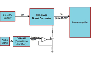

This reference design uses the TPS61088 to provide an envelope tracking power supply circuit for an audio power amplifier (PA). By adding the audio envelope signal to the FB pin, the output voltage of the TPS61088 can be varied according to the envelope of the audio signal. Therefore TPS61088 can provide dynamically changing power supply voltage to the PA. As a result, the PA maintains high efficiency over the entire output power range.
characteristic
  • ● 2.7-4.2V input voltage range
  • ● 5.5-11.75V output voltage range
  • ●The output voltage changes linearly with the amplitude of the input audio signal
  • ● With the full range of audio signal boosting, the output voltage rises from 5.5V to 11.75V within 1ms.
  • ● Higher efficiency than traditional fixed power PA
