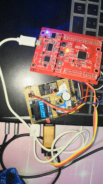

This design uses GD32F350 as the main control, OLED12864 as the display screen, and the ESP8266 module as the display of the network connection module. After the system starts, it will automatically connect to the server (using server software written in Yi Language). You can then use the B2 button to obtain network time updates to the microcontroller system and calibrate the current time. In the receiving mode, pictures and text information from the server can be received. The microcontroller processes the transmitted information and displays it on the OLED screen. The design can be used as a task server, sending tasks from the network and then displaying them using OLED for easy viewing. It can be used as an electronic note and placed at home or at work to remind yourself of the work that should be completed today. The design also includes an alarm clock. Users can set an alarm clock to remind themselves, which can be used to wake up, task reminder, etc.

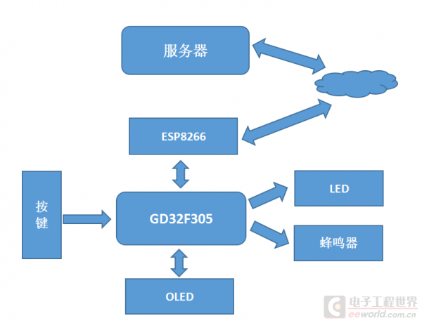

Blockdiagram
