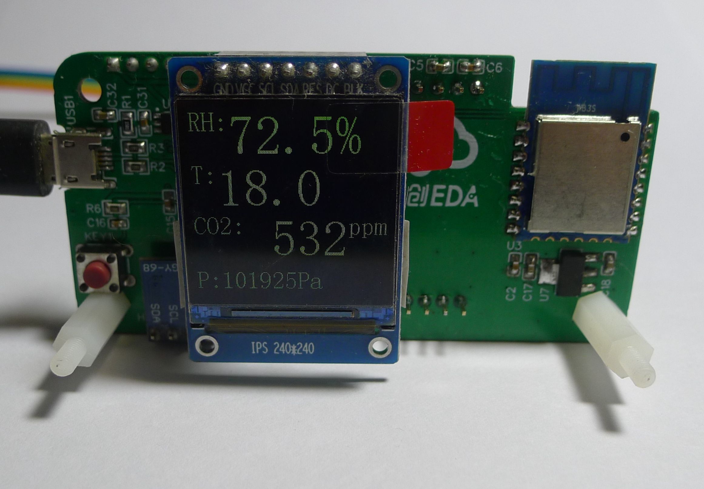

Tuya intelligent air detection node. Adopt MCU docking development solution. Equipped with temperature, humidity, air pressure, carbon dioxide concentration and other sensors to collect ambient air qualityand record. Front:
Back:
Produced temperature and humidity sensor:
APP interface:
K1 is the network distribution button, click to perform network distribution operation. Screen color is determined by carbon dioxide concentration calculations. As the carbon dioxide concentration increases, it changes from green to red. For the source code of the microcontroller, please visit https://gitee.com/LC_391338A/tu-ya-zhi-neng_AIR/tree/master
