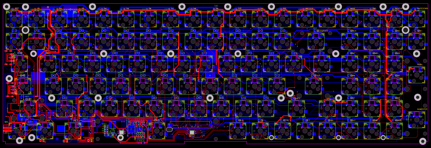

This is a 96-configuration mechanical keyboard project, K375S master control!
The following is a boast
1. With my case, the battery capacity reaches an unprecedented 15,000mah battery. The 10,000mah battery powers RGB, OLED, human body radar and Arduino main control. The 5,000mah battery is exclusive to the 375s main control. The total power exceeds 55 watt-hours, bringing ultra-long RGB battery life. .
2. 29 studs are used to screw together the PCB and the positioning plate. Half of the studs have corresponding holes in the shell. Overall, the stability is the best in the world. I have never seen a keyboard fixed with so many screws.
3. Supports bare PCB mode. It can still operate without making a casing. Relying on PCB + positioning board + main control, basic keyboard functions can be completed. There is no RGB. With the opening of the positioning board, it is allowed to be between the PCB and the positioning board. Embedded with two lithium batteries, it provides up to 600mah power.
4. Ultra-high brightness RGB. After painstaking wiring, the RGB power supply line is very thick. The main power supply line reaches 1.1mm width, and most of the branches can also reach 0.8mm width. In the test excluding battery life, 102 axis lights (space three Each light) can reach a power consumption of 17 watts and directly shine through the PCB, shaft body and keycaps.
5. According to the idea of high cohesion and low coupling in software engineering, each function is separated. The pcb is only responsible for carrying the keyboard matrix, RGB lines and a set of bare board power supply circuits. More fancy functions include but are not limited to RGBOLED screen human body. The radars are all handled by an additional PCB, which greatly reduces the cost of trial and error, reduces the cost of welding errors, and provides more excellent upgrade space.
6. Symmetry involves two strong double-sided pads. Each fixed pad is penetrated by a large number of via holes. The capillary effect is used to greatly enhance the firmness of the pads. Purchase m4 knurled studs to pass through the holes for soldering. , fixed very firmly, used to install CNC aluminum alloy feet in bare board mode.
7. Rich RGB interface, combined with my positioning plate, you can get the RGB effect of axis light + positioning plate down-shooting ambient light. There is also an RGB interface that allows you to add light strips.
8. The more optimized sinking plate typec is adopted. Now the typec will no longer hold up the positioning plate.
9. An encoder pad is added to the ESC position. You can choose to solder an EC11 encoder with a handle height of 15mm and a 2.54mm pitch through-hole pad. This is considered a pitfall. Someone with the ability can do it right on the pad. Modify the control board below and solder the spring probe. It should be able to realize the encoder function and adjust the RGB brightness and so on.
9. Update - the shell has been open source, in STL format, and can be printed directly. Please do not use it for commercial purposes. Infringement will be investigated.

There are four larger PCBs:
The main PCB positioning board PCB control board PCB MCU core PCB are all open source. For details of these PCBs, please see their respective homepages. In addition, there are some small FPC adapter pcbs, and the finished products can be purchased online.

About purchase: Please note that the main control has two screw holes and an exposed pad. For the authentic master control, one screw hole and the exposed pad are copper-colored and adopt the immersion gold process. For the imitation master control, the screw holes are silver. The pads are also silver, so you can tell the authenticity at a glance.
Regarding fixation: Use the spring pin energization method to clean and flatten the main control power supply pad. Purchase HY255502 spring pins and embed them into the PCB. On the other side of the PCB, the protruding height of the bottom of the spring pins should be less than 1mm, and the protrusion should be within approximately 0.5mm. After soldering quickly, the molten tin will flow into the needle over time and the spring needle will be scrapped. On one side of the spring pin, there are two slotted pads that roughly correspond to the main control screw holes. Weld the copper nuts on them to allow fine adjustment of the nut position. After alignment, press the main control on and tighten the two screws. The fixation is completed and the power supply is started. It is worth noting that under the main control FPC connector, there is a lamp bead protruding from the PCB surface. Patience and care are required to polish off the protruding part. The circuit part of the lamp bead will not be damaged. The polished part is purely plastic. The other four Each welding leg also needs to be polished flat. The flatter it is, the more stable the installation will be.
