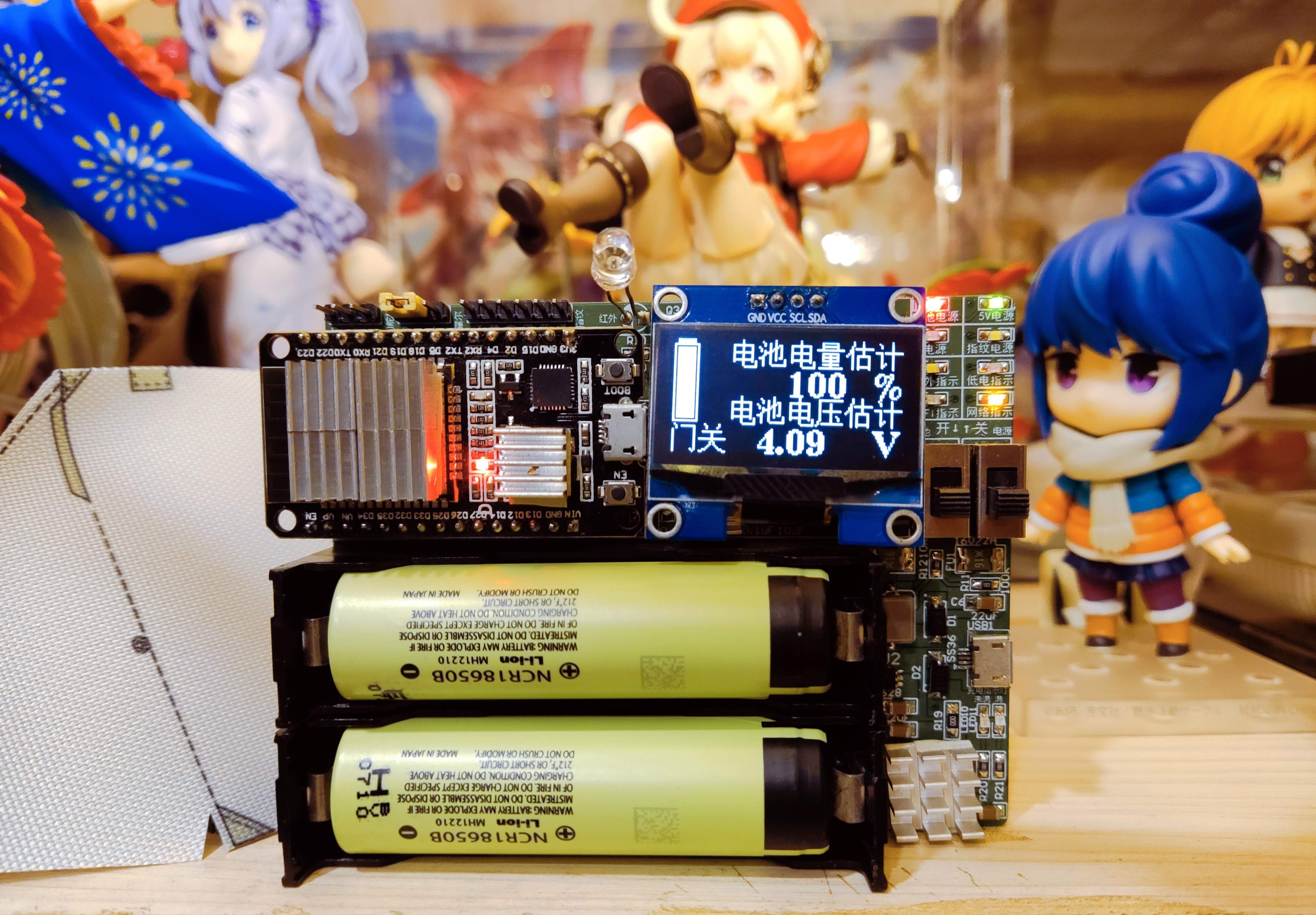

An IoT access control system based on ESP32.
The door-opening action is controlled by the servo, and ESP32 sends a PWM signal to the servo to open the door.

  1. Built-in uninterruptible power supply, 24-hour power supply , even if there is no power in the dormitory at night, you will not be afraid of being unable to open the door
  2. Based on Blinker networking, it can also be controlled remotely from outside.
  3. Support fingerprint to open the door, fingerprint supports Touch power-on function
  4. Support Hall induction door switch status
  5. Built-in web, even if the router is powered off at night and there is no network, you can open the door through the web
  6. Support computer bat to open the door
  7. Supports remote control air conditioning function and can customize the remote control code
  8. Supports access to Mijia, Xiaoai voice control, and Tmall Elf voice control
  9. Supports 1.3-inch and 0.96-inch OLED display status

1.2 The second page shows the status of ESP32
The display on the large page is an estimate of the current remaining battery state and voltage , not an exact value. Suggestions for code modification: take multiple samples, remove the maximum and minimum values, and then average. I only sampled once here, so it is not very accurate.
There is also charging status . The capacity of the battery icon on the left will change according to the remaining battery power. There is also door status detection to detect whether the current door is open or closed.

2.LED indication
The LED indicator light is very bright for some people's eyes at night, but I did not set a hard switch to turn it off. Only the low battery, WIFI and network indicator lights can be turned off through the software, and other lights cannot be turned off.
Battery indicator light: It will light up when the battery power is turned on, indicating that the uninterruptible power supply part is already working.
5V power supply: indicates the 5V supply for the MCU to work
Door power supply: Servo 6.6V on indicator light
Fingerprint power supply: fingerprint 3.3V power on indicator light
Infrared indicator (flashing): Indicates that there is currently an infrared transmission signal being emitted.
Low battery indicator (flashing): Indicates that the battery power is less than 20%
WIFI indicator (flashing): Indicates that there is currently no WIFI connection. The WIFI indicator light is off when connected normally, the WIFI indicator flashes, and the network indicator also flashes.
Network indicator (flashing): Indicates that there is currently no network connection. The network indicator light is off when connected normally.
