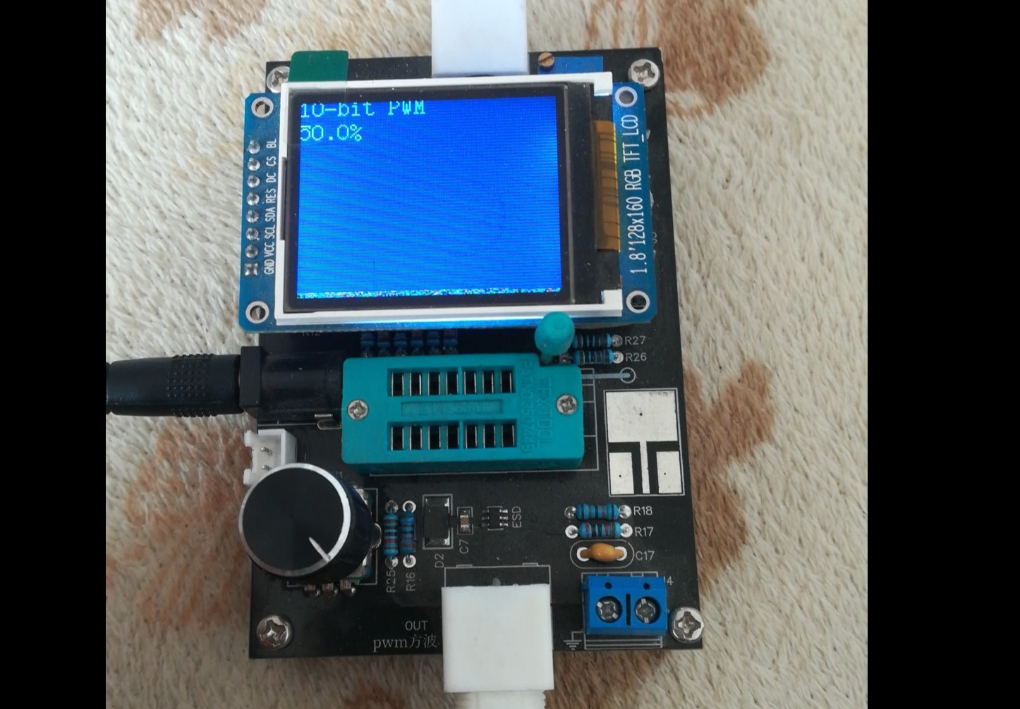

Transistor tester
可以测量各类晶体管,电阻,电容,电感,可以测频率,也可以输出波形。
tft大屏显示,测量结果更加详细。
熔丝位FF D9 FF
project address
svn链接:svn://mikrocontroller.net/transistortester
论坛:[https://www.mikrocontroller.net/articles/AVR_Transistortester]
menu translation
Selection:>
Transistor 晶体管测试仪
Frequency 频率测量
f-Generator 频率输出
10-bit PWM 10bitPWM信号
C+ESR@TP1:3 电容ESR测试(使用T1和T3接口)
1-[]-~~-3 电阻电感锁定测量端口(使用T1和T3接口)
1-||-3 电容锁定测量端口(使用T1和T3接口)
C(uF)-correction 电容校正
Selftest 自动校准
Voltage 稳压管测试、外部电压测量
FrontColor 字体颜色
BackColor 背景颜色
Show data 信息参数
Switch off 关机
Some functions still need to be improved, and I hope someone with the ability can help improve them. Note: This PCB does not include Zener diode extension. The corresponding circuit is provided in the schematic diagram. If necessary, you can test it by yourself.
