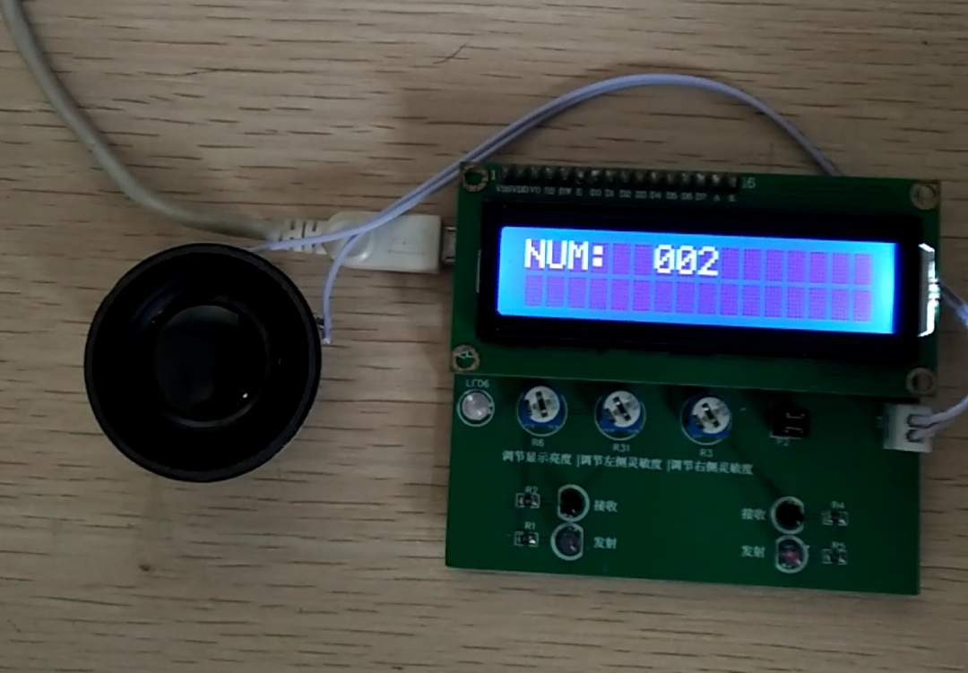

This product uses the 15w401as chip launched by stc as the main control. It is compact, energy-saving and cost-effective. It can be directly powered by USB. The detection distance can be adjusted through the potentiometer (the silk screen on the PCB is clearly marked). By default, when there is an object When passing from left to right, the welcome device will prompt welcome and the LED light will be on. When the person completely enters, the LED light will go out. When an object passes from right to left, the welcome device will prompt thank you for your patronage and the LED light will be on. When the person completely leaves, the LED light goes out, and the voice prompt only needs to change the two digital names in the program (song1 and song2 are interchangeable). The language module and other information are also placed in the information folder. You can do it according to your personal needs. creation
