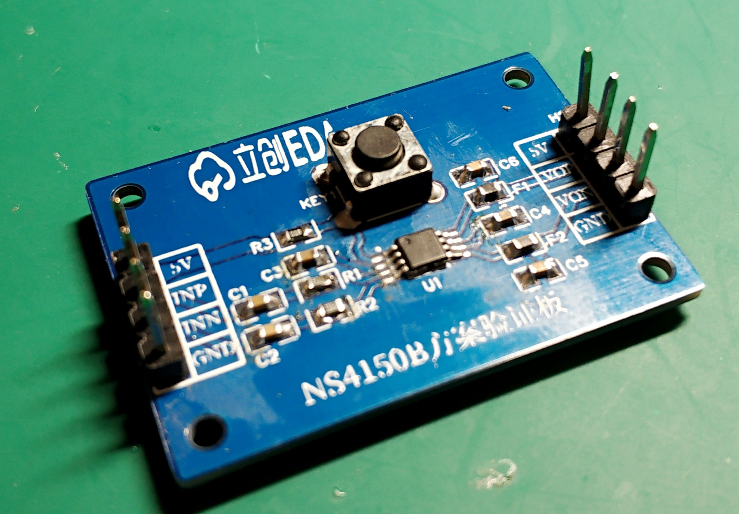

[Program Verification Board] NS4150B Program Verification Board
  • This project is used to verify the solution verification board design of Lichuang Mall audio power amplifier NS4150B
  • This project is a solicitation project for Lichuang EDA open source hardware platform solution verification module
  • This design is a Class D audio power amplifier module based on NS4150B
  • NS4150B is an ultra-low EMI, filter-free, 3W single-channel Class D audio amplifier produced by Nsiway . The efficiency is as high as 90%, the startup time is fast, the peripheral components are few, the integration level is high, and the operating voltage range is 3.0V~5.5V
  • This design refers to the recommended circuit design in the chip manual, and uses pin headers to lead out the power, ground, and signal input and output ports of the module.
  • For more detailed chip parameters, please refer to the chip manual in the attachment.
参考设计图片
