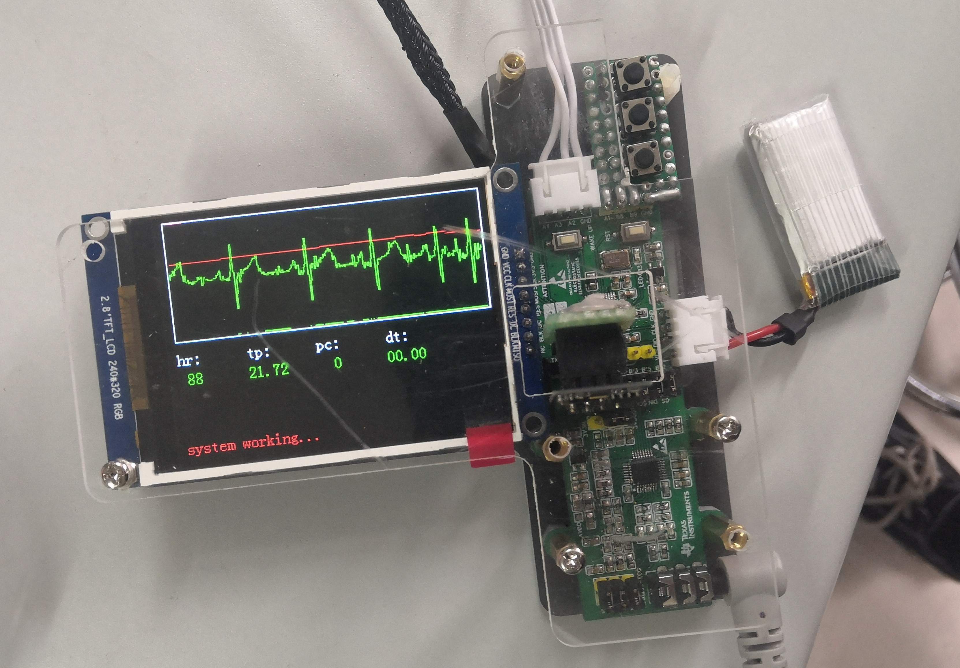

  • ADS1292R ECG acquisition module
  • STM32F103C8T6 minimum system module
  • LMT70 module
The three parts of the board are connected through jumper caps and used as one, or they can be separated and used separately.
The crystal oscillator of the microcontroller uses an 8M active crystal oscillator.
I enlarged the soldering pad of LMT70 to make it easier to solder, but I don’t know if it will be affected if the temperature measuring hand touches the soldering pad.
In order to make the component layout more compact, no component character labels are left.

LMT70 can be powered through the IO port, which is recommended by the manual. Using the 12-bit ADC that comes with stm32, the data is quite stable after adding mean filtering.

About the screen
Link: https://item.taobao.com/item.htm?spm=a1z10.5-cs.w4002-22419023648.11.103e497cFxRZgy&id=526022333035 Insert image description here
Select "old model without chip select CS"
This SPI-driven LCD refresh speed is okay, at least the real-time display of ECG waveforms is satisfactory.
The store provides the source code of the stm32 part. When designing the PCB, it is also based on the pin definitions in the screen routine (using hardware SPI).
Equipment casing
The shell is drawn using solidworks, material: acrylic, copper pillar, equipment: engraving machine, hand. I was pressed for time on the last day, so I drew the wrong mounting holes for the screen, but I still managed to install it. Insert image description here
