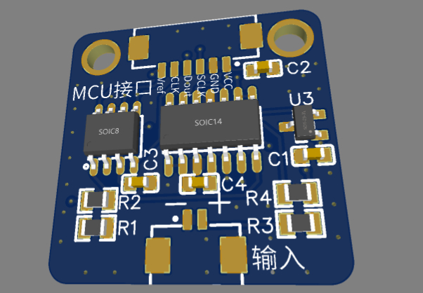

The project requires a high-precision sensor because the voltage of the sensor is very low and is easily overwhelmed by noise.
  • A high-precision ADC will not be able to resolve the sensor signal
  • Front-end op amp does buffering and amplification
  • Baseline cache
  • Internal resistance adaptation
In order to solve the above problems, the verification version is produced using a module method, which can connect various sensors and avoid separate requirements for making boards.
The op amp can be configured as needed, but the benchmark is more important, so choose a foreign brand.
