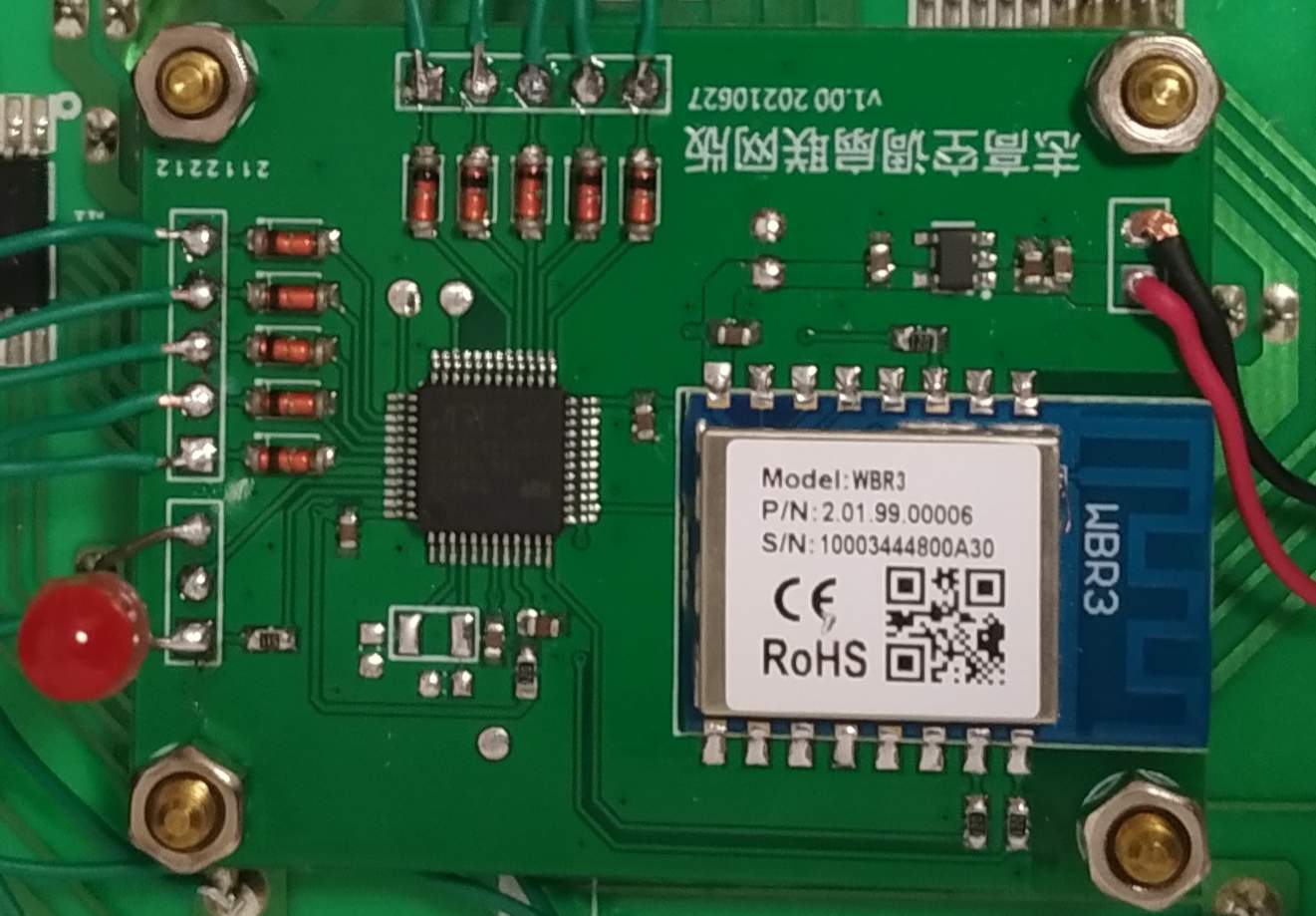

A Chigo air-conditioning fan is modified based on the AT32F421 microcontroller and the Tuya wifi module. The Tuya app is used for LAN and remote control, and the development method uses the SDK.

Solution: There are two options
1. Redesign the entire board
2. Install a control board based on the original board
After looking at it, I obviously chose the second option, mainly because I was too lazy to put in the effort, and this time it was just a modification.
Design idea: The Tuya module communicates with the main control, controls 5 touch keys according to the command, and detects the control pin status of all thyristors at the same time.
So the schematic is as follows:
The power supply of the microcontroller and wifi module is 3.3V, so they are all isolated using 4148.
The final assembly effect is as follows:
