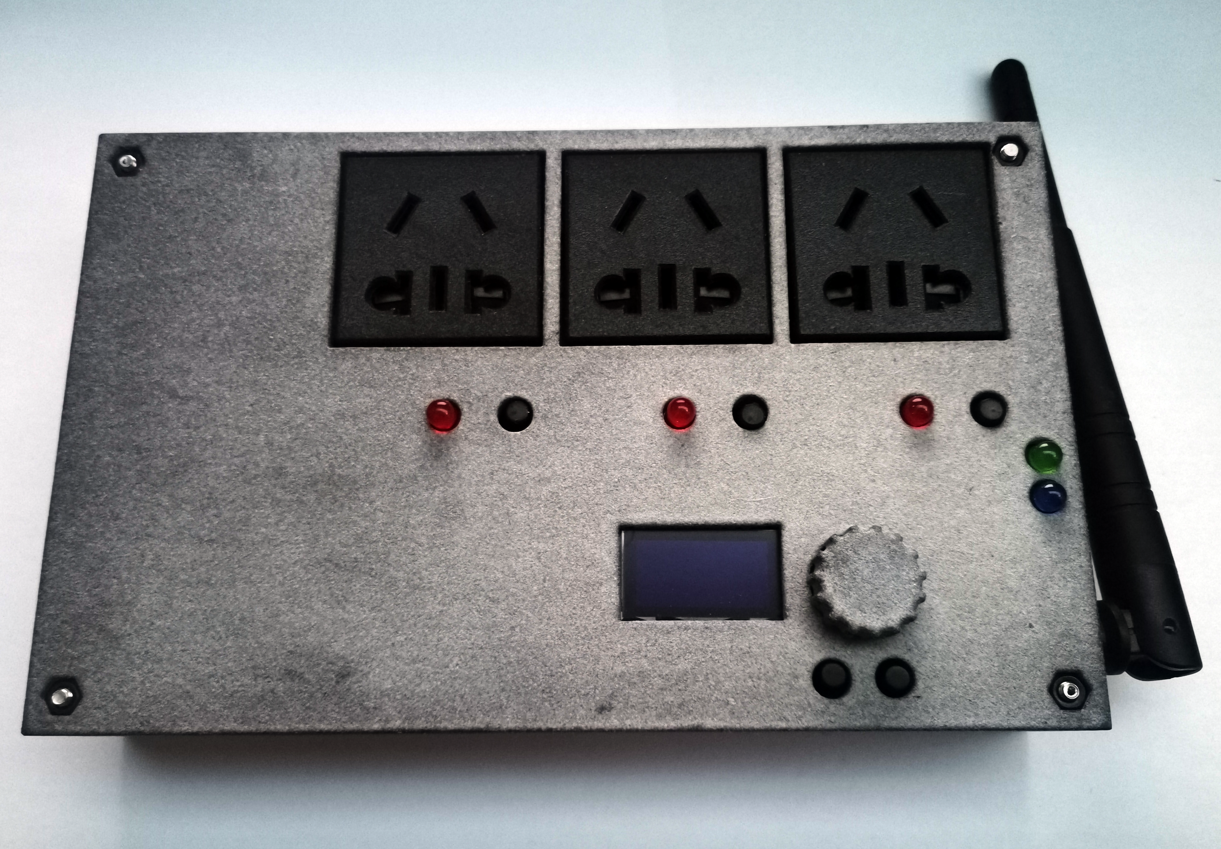

OLED three-hole smart socket
Rendering
Physical map
Physical picture with shell

3. Design Key Points
1. Strong current part
(1) Use 10A 5*20 fuse for protection
(2) Slotting to prevent electricity creepage
(3) Opening windows and applying tin to increase overcurrent capability
(4) Use card-type embedded sockets and integrate the sockets onto the board by welding
2. Weak current part
(1) WiFi module is powered separately
(2) Use ACDC module HLK-5M05 to convert AC 220V into DC 5V to power the control system
(3) Button hardware debounce processing
(4) Interaction using a combination of OLED and EC11
3. Program part
(1) Program layered design to reduce coupling and improve portability
(2) Real-time task scheduler is implemented using timer
(3) Serial port echoes all data, sets triplet, PC to EMW3080 transparent transmission
(4) Multi-level menu

8. Known issues
1. STM32 external interrupt line conflict
Problem: EC11 encoder item B is connected to the PA7 pin of STM32, and button 2 is connected to the PB7 pin of STM32. Both correspond to the EXTI_Line7 interrupt line, so they cannot use external interrupts at the same time.
Solution: In order to accurately obtain the EC11 input, the program uses two external interrupts to detect the AB phase of the EC11 encoder respectively. Therefore, the detection intelligence of button 2 is realized through polling detection. The program uses a real-time task that triggers once every 1ms to detect the corresponding button 2. The level of pin PB7 simulates the effect of external interrupt
2. The relay closes when power is turned on.
There is a problem with the relay drive circuit. When the STM32 is powered on, the IO port is in a high-impedance state, the normally open contact of the relay is closed, and the socket is connected. The improved circuit can avoid this situation. image.png
3. OLED packaging error
There is a problem with LCEDA's 0.96-inch OLED packaging. Common OLED modules on the market are not compatible. There is also a problem with the 3D packaging. It is suspected to be a 1.3-inch OLED 3D model.
4. LED pin length is insufficient
The LED pins must be at least 45mm long to protrude from the housing display. The blue and green LED pins are not long enough and need to be connected to another length.
5. The firmware version of EMW3080 Alibaba Cloud direct connection is too low.
Question: Refer to the program of Lingyao and the documents of Qingke official website to send AT commands to EMW3080. EMW3080 can return the information normally, but cannot enter the network distribution mode.
Solution: Use the AT command AT+FWVER? to check the EMW3080 firmware version number is 2.2. Try to upgrade the firmware and use it normally.
Firmware flashing tutorial: https://www.yuque.com/lingyao/jing/isdnec
Flying line flash firmware:
Firmware flashing successful:
The first network distribution was successful:
6. No test points left
Test points should be set aside to facilitate program debugging. For example, the serial port between STM32 and EMW3080 should lead to test points to facilitate debugging and programming of EMW3080.
9. Project related
1. If there are physical components, use 3D printing to verify the packaging before making the board.
2. Print part of the shell and conduct preliminary experiments to verify whether the shell is usable.
