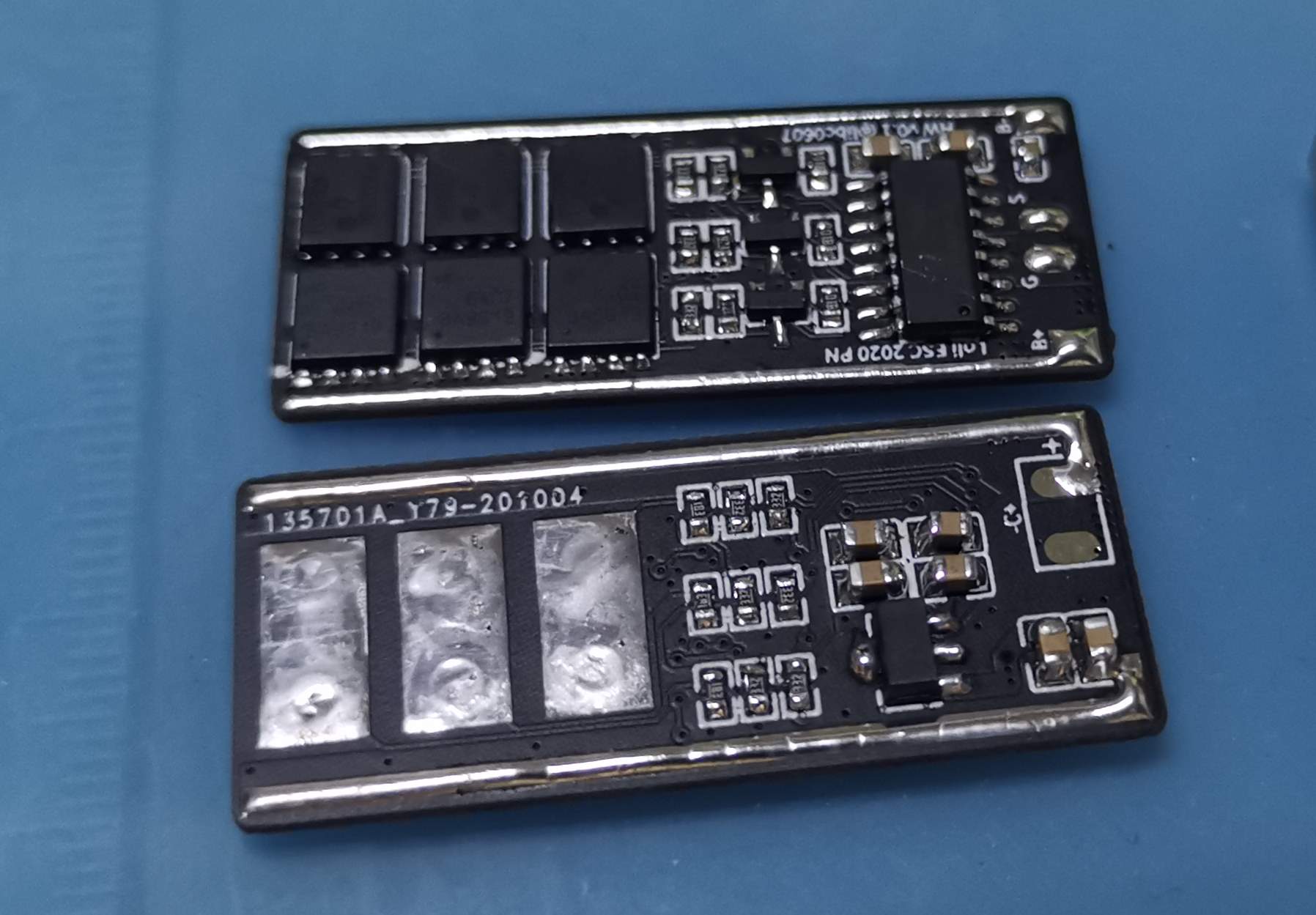

Loli brushless ESC 2020 version PN double layer v1
The MOS tube chosen is AON6407/RU3090M, which is about 20~30A. The usable range of 2S~4S can be added with a heat sink.
I don’t have a 5V BEC output because I think distribution boards are so easy to buy now…………
The black one in the picture is this board, and the green one is for size comparison.
