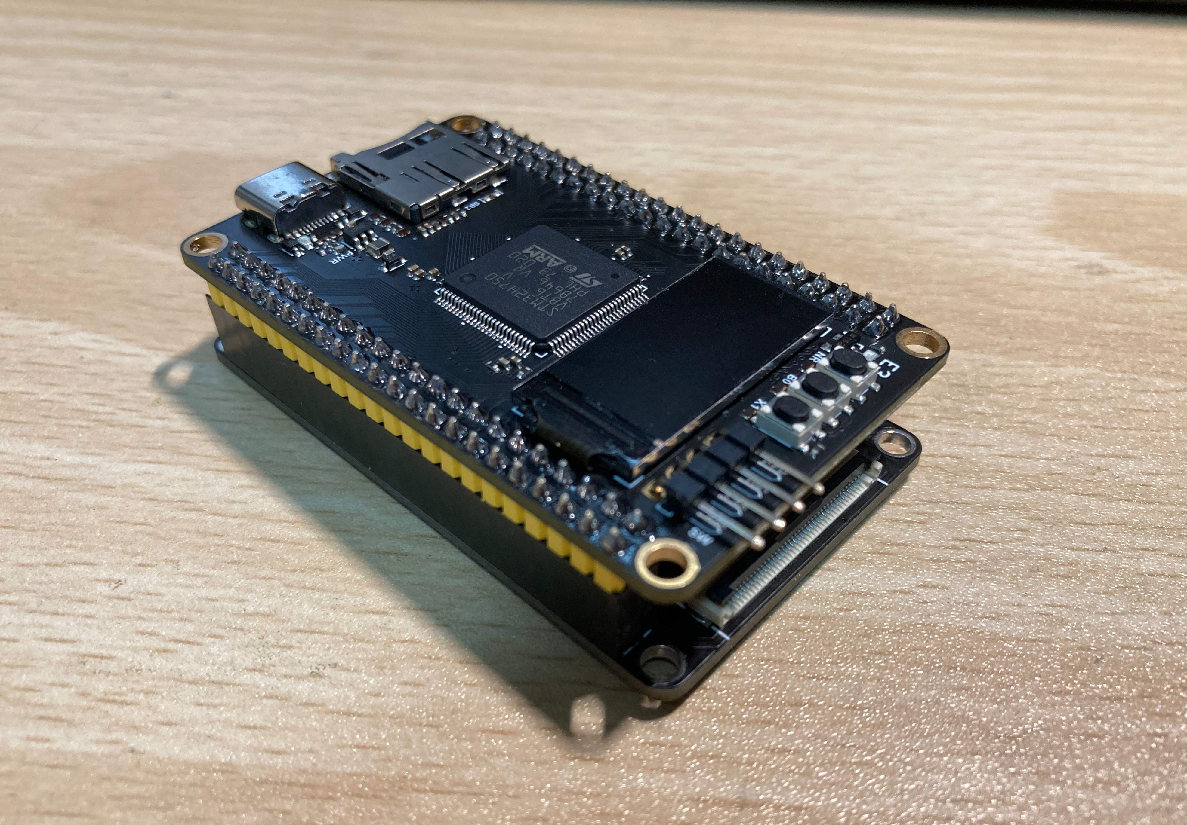

What it looks like after being combined with the core board
