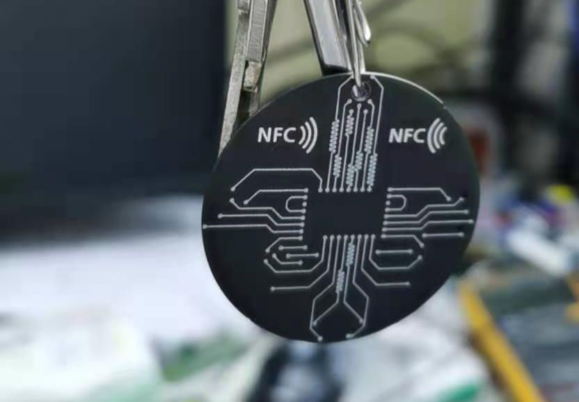

NFC: supports meal cards, bank cards, etc.
Referring to the design of TD111111, a DIP switch is added, which can hold three cards, and then two circuit boards are made, fastened together and injected with silicone rubber using a thick needle. Wait for it to solidify overnight before use. This is quite strong and waterproof. , the three cards are very convenient to use. I put my meal card and bank card in them and use them all the time. To remove the card, you can use a flashlight to determine its position, and then use a soldering iron to remove it. ps intel stickers are pretty good
参考设计图片
