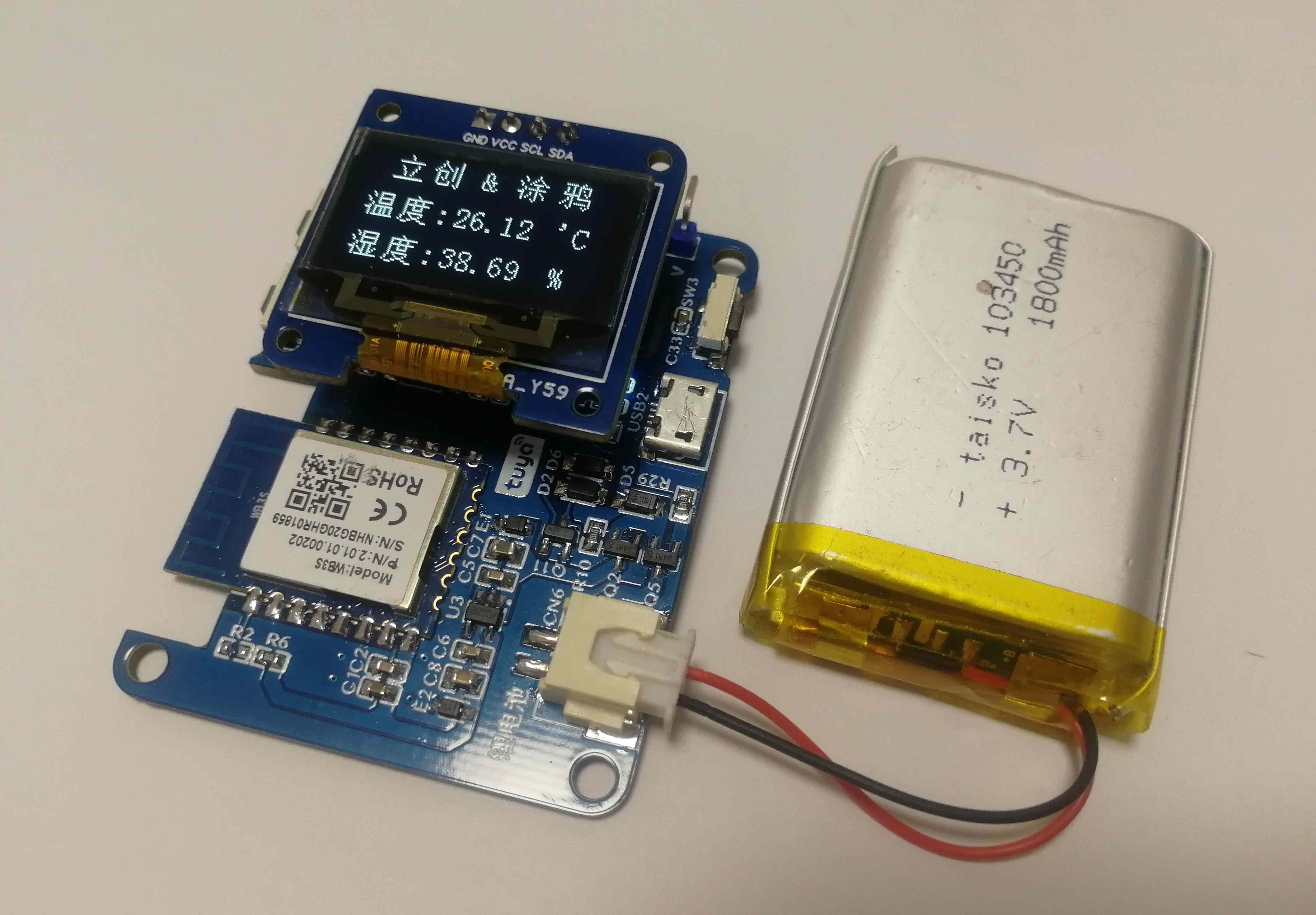

Overall introduction
  • This project is a temperature and humidity sensor based on Tuya Smart, using a low-code MCU solution. SHT20 is responsible for collecting temperature and humidity. The Tuya IoT module is used in combination with the STM32F0 microcontroller to collect and report temperature and humidity data, and visualize the data.
  • The sensor can be composed of two PCBs, connected through pin headers and four fixed posts. The overall size is: 56mm*44mm*15mm. The lower board contains various circuits required by the sensor, and the upper layer is an OLED module.
  • For power supply, you can use 3.7V lithium battery or Type-C interface for power supply. When both are connected at the same time, USB power supply is used by default. The button in the lower right corner is used to realize the one-button power on and off function.
  • The OLED interface is an IIC communication interface, which can display the current temperature, humidity and other contents on the OLED. The OLED can also be controlled whether to turn on the display through the upper right button.

  • The one in my hand is a micro usb interface, but the current picture has been changed to a Type-C interface.
  • The overall average current of the board is 100mA and the peak current is 200mA, so when choosing an LDO, you need to choose a model with a maximum output of more than 300mA.
  • When using lithium batteries for power supply, since the board itself does not have a battery management chip, you must choose a lithium battery with a discharge protection board. The battery should not be used for a long time. When the voltage is insufficient, it should be charged in time.
  • Regarding the OLED display module, you can use common ones. The module used here is the module from Jixin. I originally planned to make an OLED module with the same size as the lower panel and use 1.3-inch OLED, but due to various reasons, I gave up using it.
  • In terms of the program, there are several things to pay attention to. For example, if you use a timer, you should pay attention to the interrupt priority of the serial port and timer. When transplanting the SDK, the serial port sending function uses a single-byte function, etc. You need to pay attention.

actual effect
  • A few pictures:
