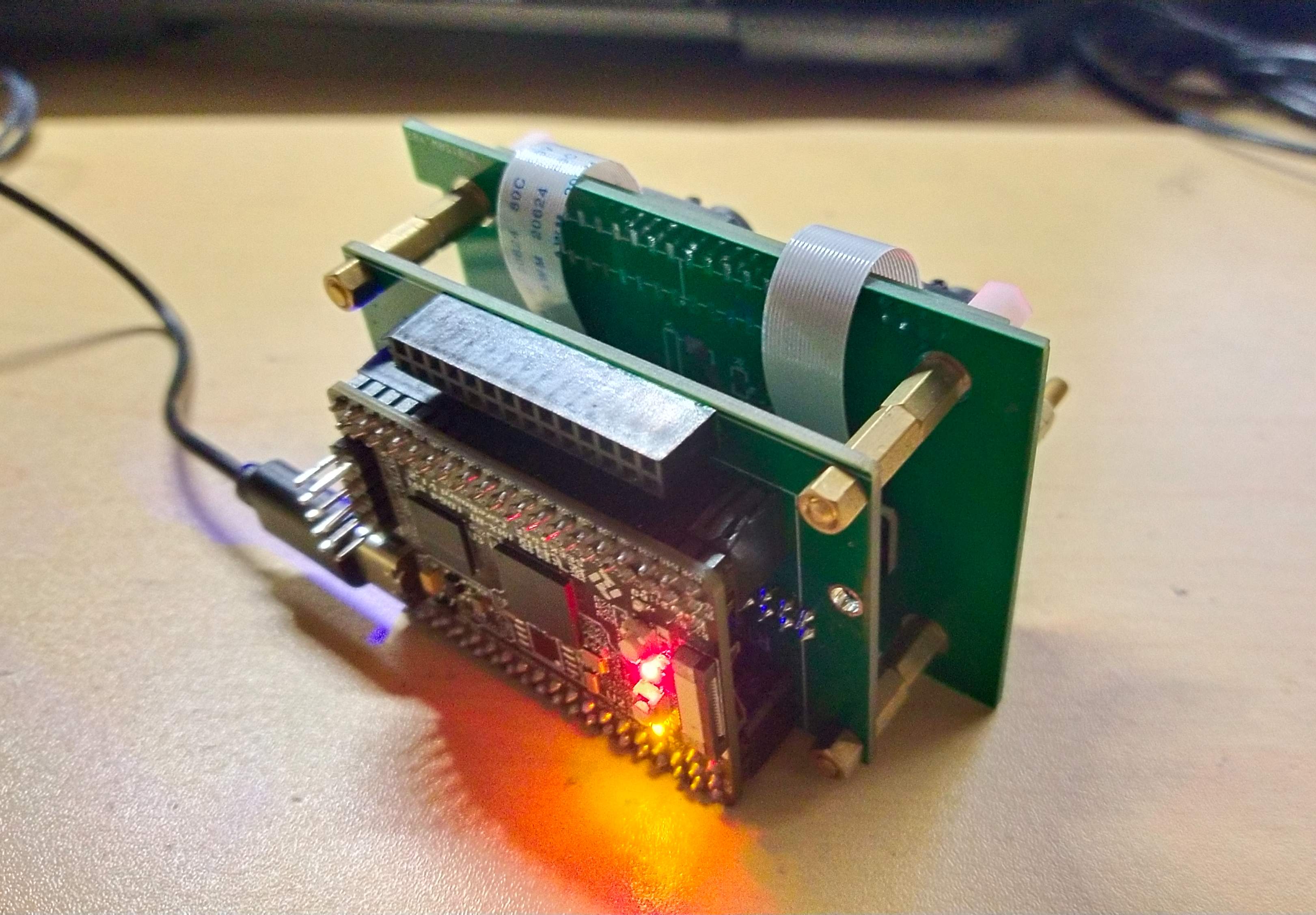

For binocular camera reception, you can choose a microcontroller to process the image for screen display or USB to send to the host computer. The screen uses the 16-bit parallel port I shared before. There is no way to reach 25 frames when using the screen and USB at the same time. There is something wrong with the Flexio interface of the microcontroller. The image is often torn, but the CSI interface does not. I don't understand it. The core board is Zhufei RT1064.
