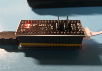

STM32 core board to DAP/ST-Link adapter board
1: The circuit is extremely simple, requiring only a few resistors and a few wires, and no need to solder the STM32 chip.
2: The core board is covered with ST-Link. My mother no longer worries that I have no money to buy ST-Link. .
Finished product:
illustrate:
  1. ST-Link
    • Install and open STM32 ST-LINK Utility
    • Burn STLinkV2.J16.S4.bin in the BIN directory
    • Plugging and unplugging the STM32F103C8T6 core board
    • Open ST-LinkUpgrade.exe in the STLinkUpdate directory
    • Upgrade firmware
    • Over
  2. DAP-Link
    • Open the Code directory and modify it freely (keil5)
    • Over
Related code download: https://github.com/POMIN-163/my_projects/blob/master/DAP+ST-LINK
