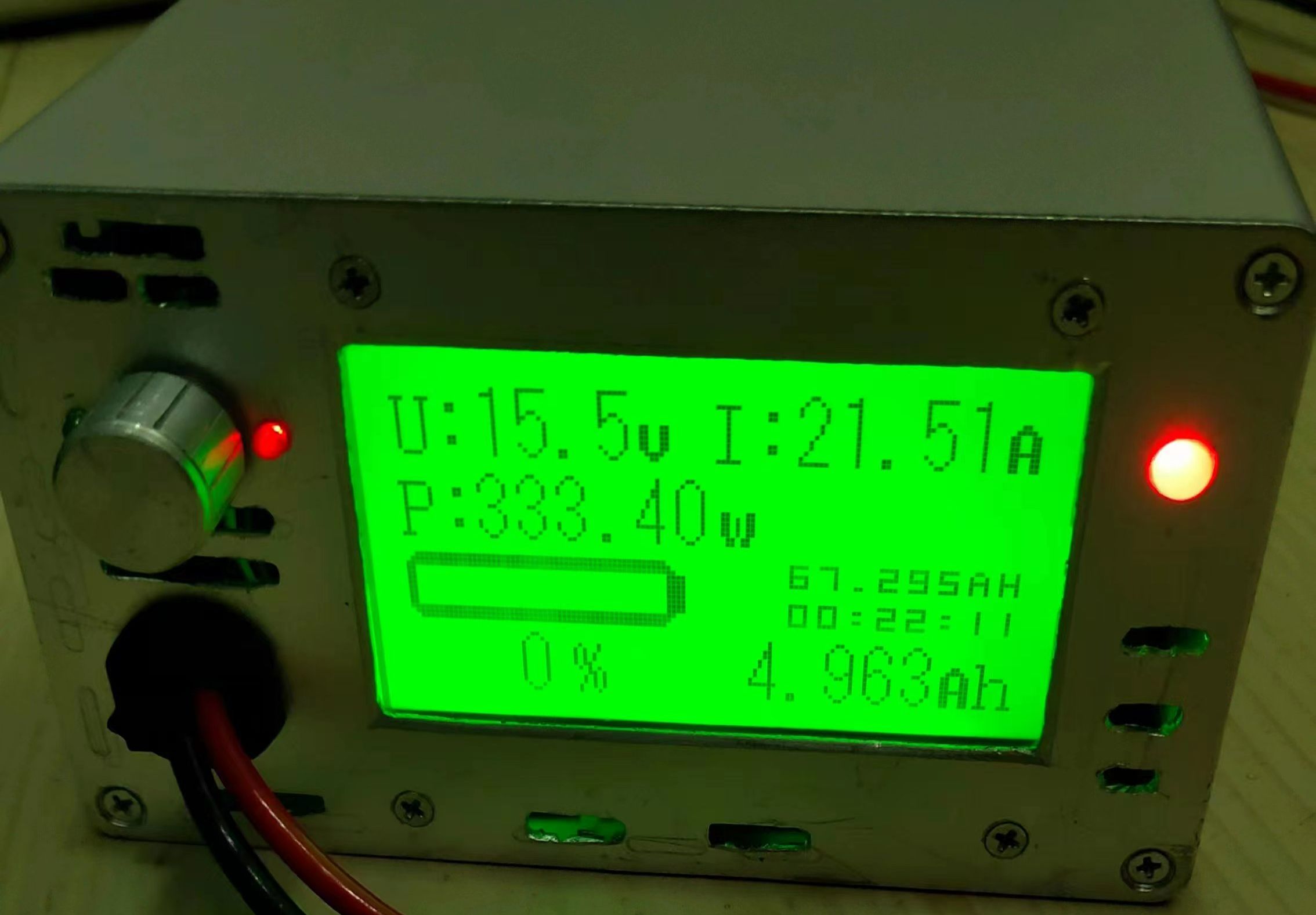

The temperature of the transformer should be lower, about 40 degrees. The transformer is of EI55*2. The output end uses 50 wires in parallel. The overall performance is OK. To test long-term full load, you still need to use iron phosphate batteries. Lead-acid batteries are not good. They will reduce power after charging with high current for a period of time. Iron phosphate and lithium batteries can test the temperature rise of various components under long-term full load operation. I have made several versions of the charger, and I am basically satisfied with this version. I will revise the version again when I have time, and integrate the CNC part into the power board.
      The 4 MOS tubes of the finished product have been replaced with IGBTs. The driving circuit part of the 1000W version is different from that of the 750W version. The heat sink temperature is estimated to be around 55°C-60°C. The specific temperature is not clear, but it will not be hot to the touch for a long time. Fan 2 is set to start at 55°C, and it stops after starting for a while. Fan 1 has been running at full speed. I made the holes by hand. I originally used a drill to drill a row of round holes for the air inlet, but my hand shook and the drill went off-center. I simply made slots, but the result was even worse. I couldn't bear to look at it, so I used a machine to make holes later. Or use PCB as a baffle.
     The 1000W meter software has been changed to coulomb meter mode, which can display the total charging AH from the start to the end of charging, as well as the charging time from the start to the end of charging, and the power is reset.
The shell is still made of aluminum alloy. It has not been installed yet. It is troublesome to drill holes manually.
The shell size is 120*200*69. The shell length is too short. It is easier to assemble it with a length of 230. The CNC version with a length of 200 can be installed on the front of the shell.
