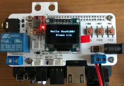

Onboard hardware resources:
  1. 24V to 12V module interface x1
  2. 12V non-isolating switch x1
  3. 24V non-isolating switch x1,
  4. 12V/24V optional isolation relay x1
  5. OLED interface compatible with SPI and I2C x1
  6. 3.5mm audio interface x1
  7. Micro button x3
  8. 5.5mmx2.1mm DC interface x1
  9. Self-restoring fuse x1
  10. Terminal x2
  11. PH2.54 socket
| image.png >Note: The actual Rev1.2 silk screen SCL (I2C) and CLK (SPI) are in the wrong position and should be interchanged.
The correct silk screen printing is as follows: image.png
Note: To use the SPI0 interface, just short-circuit CLK and MOSI. To use I2C, you need to short SCL and SDA and solder the I2C pull-up resistors R12/R13.
The picture below is a demonstration of using SPI0 to light up OLED: image.png
