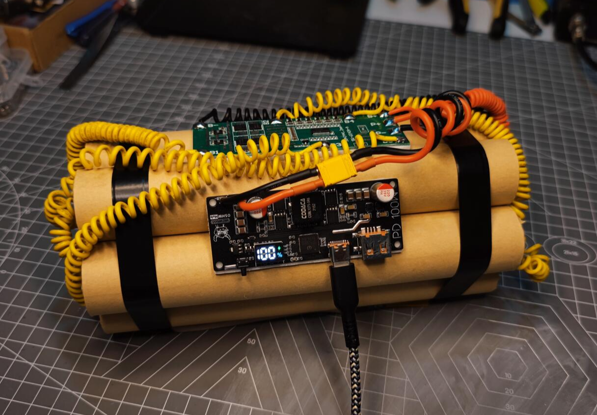

Bidirectional PD 100-watt mobile power supply solution based on Yingjixin IP5389-BZ chip design
update instructions
1. Optimize wiring and optimize component layout
2. Add TVS absorption board surge      protection main control at the battery interface
     when connected to the battery
The chip and MOS tube will not be broken down by surges (without TVS, there is a chance that the MOS and main control chip will be damaged).
3. The inductor can be replaced with an integrated inductor.
     The inductor can be Sunlord MWSA1206S series 4.7uh to 10uh (for reference only)
2022 On May 14,
the battery pack that supports 2-6 strings
also supports lithium iron phosphate batteries (resistors need to be replaced to set the battery type).
For details, please check the schematic diagram

pay attention to more than four strings of batteries! ! !
When the board is inputting and outputting high power, the current at the battery terminal is very large. Please pay attention to the battery selection.
The battery is recommended for high-rate battery applications such as Samsung 50E, Samsung 40T, and Lishen LA.
It is recommended that the charging power should not exceed 60 watts.
Applications with 100 watts require at least a four-string-two-parallel structure.
Six-string two-parallel 100-watt applications are available. Battery
boards do not have lithium battery protection and balancing circuits. A protection board with balancing function needs to be used at the battery end.

The board and the panel are connected by soldering.
The bottom can be filled with two layers of 4 mm thick thermally conductive silicone grease pads to conduct heat to the shell.
The aluminum shell is of customized length (180 mm long), and a battery holder can be added to the battery. .
Taobao stores have mass-produced aluminum shells with a maximum length of 170 mm. If you don’t add a battery holder, you can use a 170 mm long shell.
The length of the battery pack is about 128 mm (different battery lengths will vary), plus the board length is 32 The total mm is 160mm, and there is still a little room left.
The battery needs to be pasted with highland barley paper and EVA foam glue for insulation, buffering and shock absorption.
