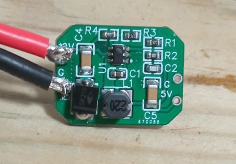

MP2456_12V step-down 5V verification board
Test parameters:
Input 12.5V
Output 5.07V
No-load current 0.92mA
Current limit 1A
Rated parameters:
Rated load current 500mA
test photo
W9xlJnim88ZoAwR9jOf5kVOA5duUrQfQvesfjYe5.pngorqmt8YJkLz1AOzahiZ7RlitoRk3MB1yinOumMp8.png
