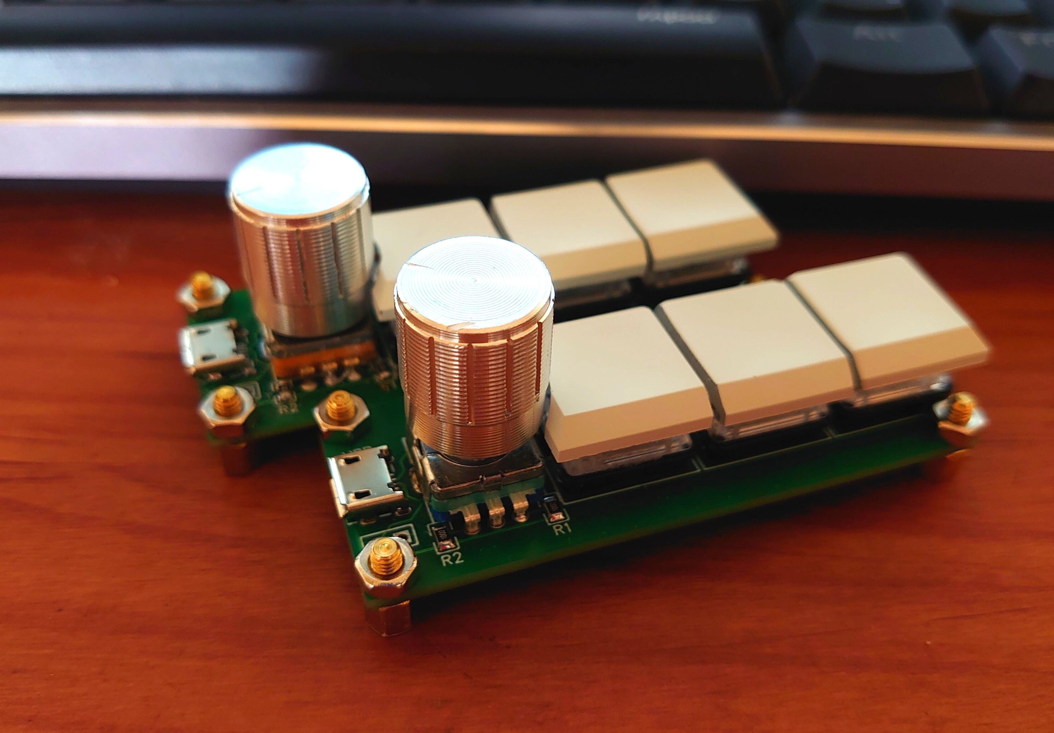

Customized pc keypad, CH552 microcontroller HID keyboard, computer multimedia keypad
A custom keyboard made using Qinheng CH552G 51 microcontroller (CH551G can also be used), using 3 Kaihua low axes and an EC16 incremental rotary encoder (EC11 can also be used, there is a project for EC11 in the attachment, and the program for EC16 is more general ), the interface uses MICRO-USB with positioning posts. The H1 next to the MICRO-USB is used for short-circuit plugging into the computer for program downloading (no need to solder the pins, just use tweezers to short-circuit). In order to avoid problems when using different rotary encoder drivers, the attachment provides links to the two rotary encoders I use, program source code, component list, HID protocol, and HID usage table.

Program download steps: Short-circuit H1 first and then plug it into the computer. See the picture below. The CH552G is used in the project (if you use other models, just choose the corresponding model). The computer can't recognize it when I plug it into the USB hub.
  1. Choose the 8-bit CH55X series.
  2. Select CH552.
  3. Mark the √ of (Run the target program after downloading is completed) so that you don’t need to unplug and restart.
  4. Look at the USB device list and if the device appears, you can proceed to the next step.
  5. Select the compiled program CH552E.hex.
  6. Click Download, and the download will start when the download progress bar at the bottom is finished.
  7. Remember to select usb as the download method
QQ screenshot 20200819130054.jpg 1. Modification date: 2021-01-02 10:54 2. Modification date: 2021-08-13 16:07 I accidentally sent the wrong modified source code for correction, and fixed the problem with the type-c port board file 3. Modification date : 2021-08-14 11:28 The EC16 purchase link has expired. The EC16 purchase address has been removed in the attachment update. The EC16 program is more common for other models of rotary encoders 4. Modification date: 2021-12-05 19:08 Attachment added The WS2812 driver of CH55x is installed for friends who need to add WS2812.
