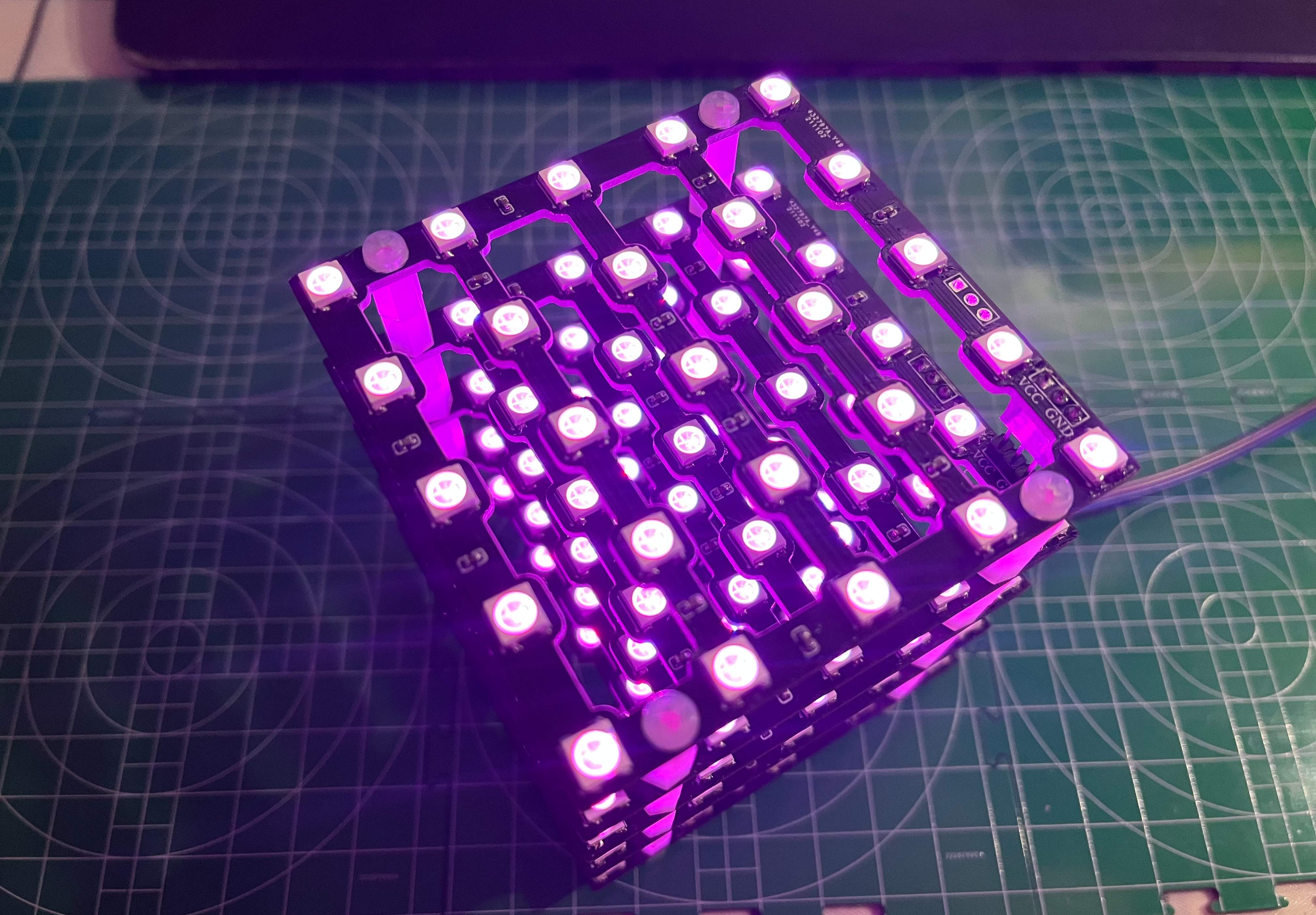

5*5*5 , a total of 125 WS2812 , all connected in series, each layer uses 11 0603 packaged 104 capacitors for filtering (voltage stabilization)
The short-circuit structure in the lower left corner realizes cascading between different layers.
For specific principle analysis and PCB design, see the video: https://www.bilibili.com/video/BV1ah411t7Jw

3 Precautions for welding and assembly
① Do not weld the pin and female headers incorrectly
②Do not short-circuit the short-contact point or make welding errors.
③The WS2812 package I used is relatively difficult to solder because the soldering pad is relatively small, so the soldering iron will burn the WS2812 . This cannot be avoided, and there may also be virtual soldering. You must pay attention to this, and there are Pay attention to the direction of WS2812 , don’t make a mistake

5 areas that can be improved and improved (this project will not have a second version for the time being)
① This light cube can be completed in one proofing. There are 5 PCBs in one proofing , so it is 5 levels . If you want to have more levels, it is recommended to make more PCBs.
② There is some obstruction in the current light cube structure because of the PCB . This has little impact from a distance and is difficult to solve.
③The current layer connection option is pin header and female header. Some people have proposed to use supporting copper pillars to achieve this. This can be done, no problem.
④ There is no main control board. This is actually very simple. If you are capable, you can make a board at the bottom yourself. It is actually very simple. If you don't have the ability, just connect an external microcontroller.
⑤The switching solder joint is too small. This can actually be soldered. If it is too small, you can draw one yourself.
