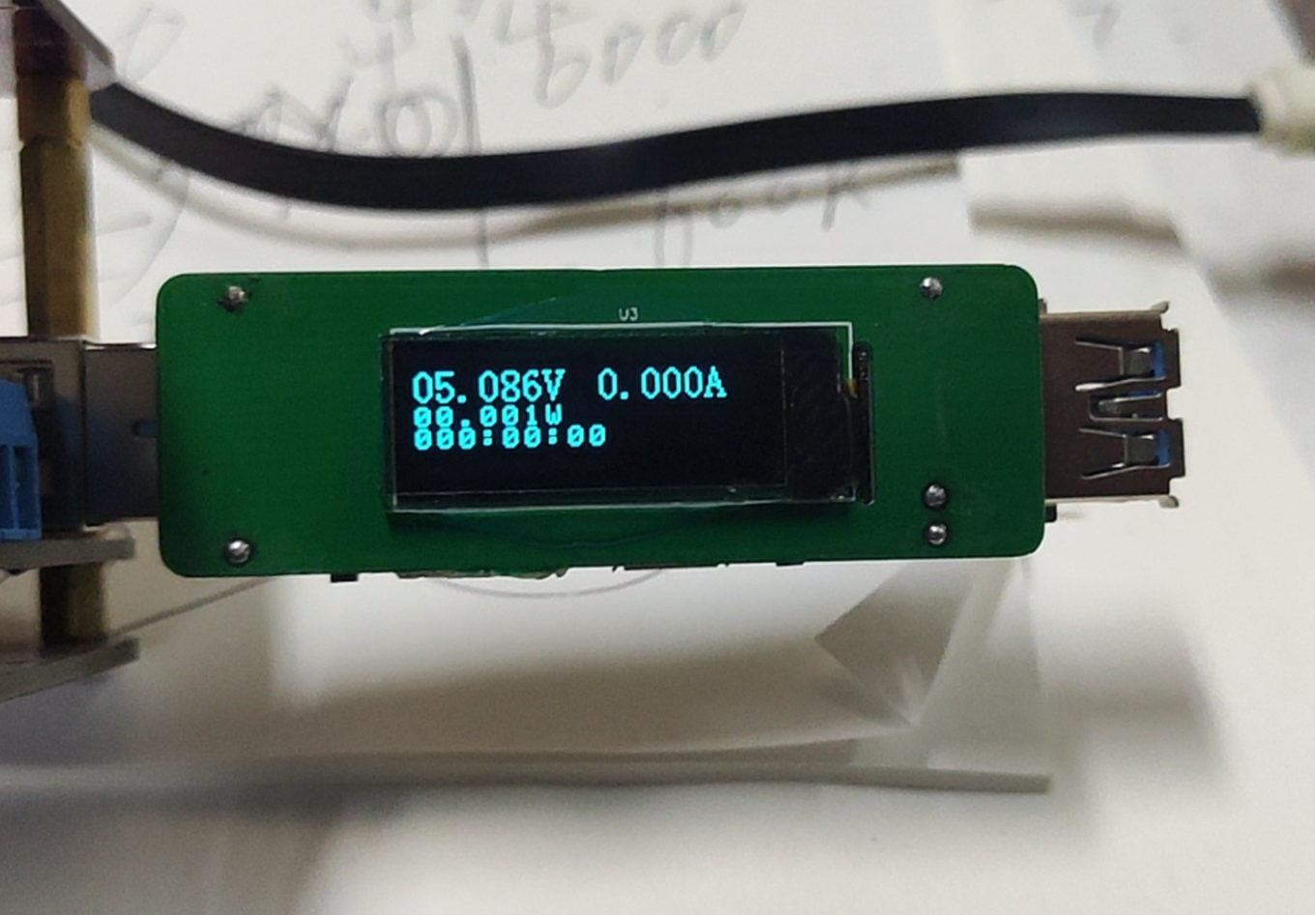

The main control is Lianshengde's W806. The main frequency is 240MHZ. The peripherals are basically available, but the official is still working on the follow-up information.
At that time, this microcontroller attracted me because its main frequency was 240Mhz, so I chose this microcontroller. The price was about five yuan or six yuan.
It is a bit luxurious to use this main control with just a power meter. There is a CH340N circuit designed, which can directly use USB to download the program. It also has a self-reset circuit designed so that frequent reset keys are not needed. The 806 has its own ADC, but I think it is not very reliable, so the cost of the external expansion solution may be less than 20.
USB3.0 interface.
Input voltage: 4.5-36.
Measuring current: 0-5A. PS -- I have not actually tested it. I have only done the actual test of 2A for one hour. 5A does not have the conditions, so there is no way.
Main control: W806
Display: 0.91OLED (IIC)
Voltage and current: INA226 (IIC)
These two peripherals can actually use one IIC, but I designed them separately.

1. When welding, I encountered a situation where the output voltage was abnormal when the load was not connected to the power supply, but everything was normal when the load was connected, so if you have a reference design, please pay attention to this problem.
